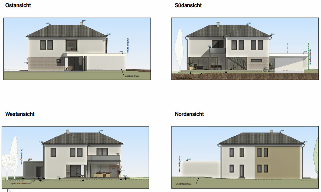

We are quite far in the planning phase and generally very happy with the layout. However, we find the north exterior view unattractive. Unfortunately, this is the side the public sees. Do you have ideas on how to improve it without completely changing the floor plan? The architect suggested placing artistic elements on the large wall surface or breaking it up with color bands. We are not fully convinced by this.

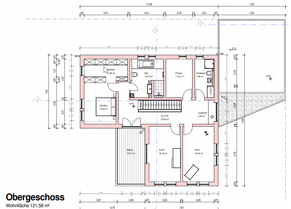

Upper floor plan: bedroom, dressing room, bathroom, fitness room, children’s room, balcony, reading corner.

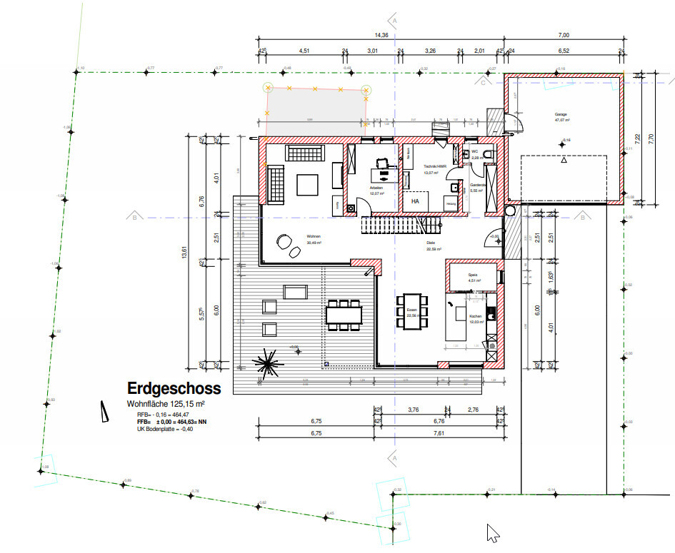

Ground floor plan of a house with living room, kitchen, dining area, garage, and terrace.

Hangman1 Sep 2021 13:33
Myrna_Loy schrieb:
An 84 sqm (900 sq ft) screen for the neighbors 😀
If the neighbors are Germany fans, it will only be for two evenings 🙄 I do agree with @hampshire on this: as long as the views are generally more open and modern, I don’t see a large continuous wall surface as too problematic. Asymmetrical, varied window arrangements show that a house is designed from the inside out. The current symmetry and small-scale detailing, however, suggest that something is meant to impress from the outside – but that has backfired. Still, I’m optimistic that this can be addressed.

The interior is good, but as a hipped roof house owner, I don’t like the exterior. (The next house won’t have a hipped roof either...)
Querpasstoni schrieb:
Very large surface with few/small windows
That’s not unusual for the north side. Of course, you can install more windows, but they don’t bring as much benefit as windows facing south, which is why they’re often omitted.
Overall, I find the exterior appearance doesn’t match the financial investment.
RomeoZwo1 Sep 2021 14:14
With the L-shape, a staggered gable roof could work quite well.
In the children's rooms, this would create higher ceilings, while above the bedrooms and bathrooms there could be storage space. This storage area could even have natural daylight...

I find it unfortunate that you are (presumably) paying a considerable amount of money to an architect and yet have to seek advice and suggestions for the appearance/facade, which is a significant part of your building, in a layperson forum....
face261 Sep 2021 15:14
I can agree with most of the points mentioned here.
Looking at the floor plan, I thought it would be a very modern house – then I saw the exterior view and thought, ugh.
A few minor points have mostly already been mentioned, but many are a matter of personal taste:
- Try to sketch the furniture as planned. Some areas might then look different on the floor plan.
- The living room currently seems divided into the sofa area, which appears small and rather dark compared to the rest of the house, and the "reading chair," which is given a very prominent spot but is also in line with the hallway. This could give the impression that the reading chair is more in the hallway than in the living room.
- In general, you have to be aware that the individual rooms in this floor plan are not significantly larger than those in a house with a slightly smaller floor area. A lot of space is taken up by corridors, roughly about 50 m² (540 sq ft), excluding the space occupied by the reading chair in the living room.
- Kitchen and dining area are similar. Is there really room for a stool at the island? It seems too tight for that. Is the pantry really necessary? There was already a suggestion to possibly omit the pantry instead.
- Regarding the open layout and noise, I didn’t quite understand that – have I missed a gallery? It is quite common nowadays that the staircase is not separated by doors or walls. Of course, this allows sound to travel upward. Please note that if you choose doors with higher sound insulation, you must consider this in the ventilation planning because doors with higher soundproofing usually close too tightly, preventing air from flowing through properly.
