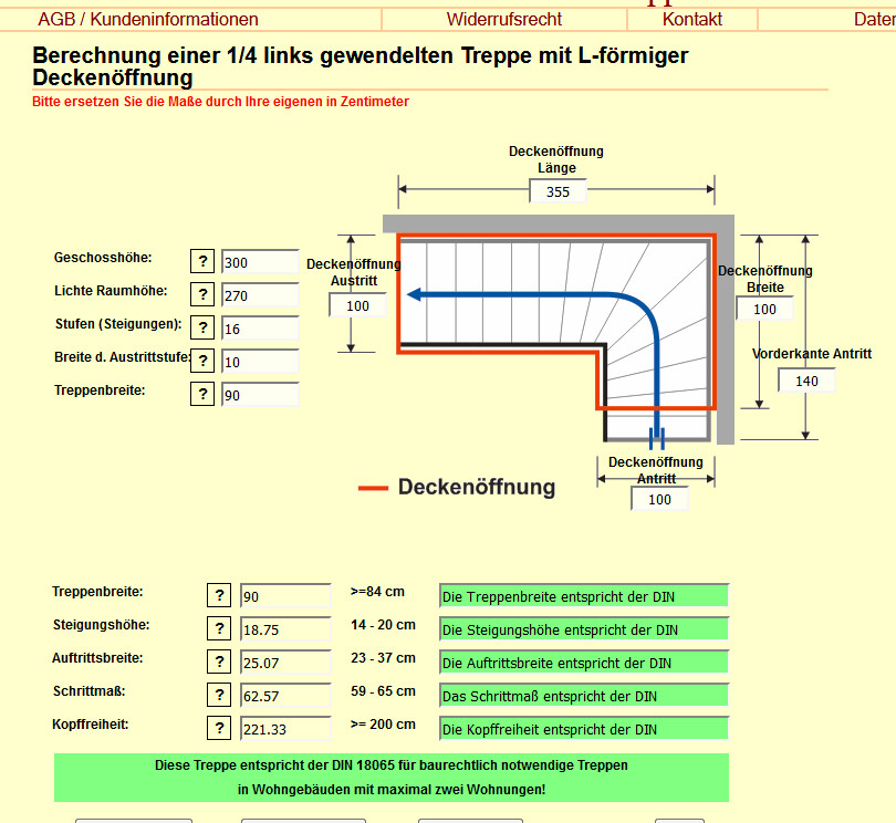

Patkia schrieb:
Is the staircase used by @kaho674 realistic, or is it not usable like that?It’s been a while, but I think I was assuming a floor height of about 2.90 meters (9.5 feet) plus a ceiling height of 2.60 meters (8.5 feet).
With a 3 meter (9.8 feet) floor height, it would look like this, which is quite reasonable, although you would have to manage with a staircase width of 90 cm (35 inches).
Kaho’s staircase in post 33 is realistic (base dimensions 355x140 cm (140x55 inches)), but it is unrelated to the stairwell you reserved in post 38 (300x95 cm (118x37 inches)).
Kaho’s staircases always include a landing, as her software does not allow otherwise, but the intended design is a quarter-turn staircase.
