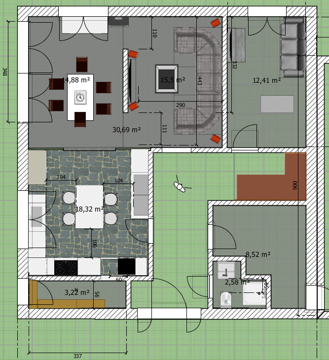

Ground Floor (GF):
Bright hallway,
Large kitchen with island (including seating, e.g., stools) and preferably a small pantry (possibly accessible via a "fake" kitchen cabinet), plus a small “bench” made from low cabinets by the window, double-leaf sliding door guided inside the wall to separate dining / living area,
Bright dining area,
Spacious living area, preferably with a panoramic fireplace as a room divider (not next to the TV),
Guest room / office,
Generous utility room with space for possibly two electrical panels, softener system, ground source heat pump, washing machine (possibly dryer), and drying rack,
Guest WC with shower.
Upper Floor (UF): at least 2 children’s rooms, 1 storage room, bedroom can be fairly small. Instead, a spacious bathroom with 2 washbasins (or 1 long basin with 2 faucets), bathtub up to 2 m (6.5 ft), and shower. WC with privacy screen, e.g., with door T-shaped.
Walk-through dressing room between bedroom and bathroom. Sliding door on the wall between bedroom and dressing room and regular door between dressing room and bathroom. Bathroom should also be accessible from the hallway.

The two above points are not fully answered yet. We have often moved the kitchen from right to left and back without finding an ideal solution.
Similarly, we are not sure whether the garage should be placed far forward with some space behind for storage out of garden view, or moved about 2 m (6.5 ft) further back (3 m / 10 ft from boundary) to gain some visual privacy from the diagonal neighbor. We are open to innovative ideas about garage placement. It must definitely have access to the house.
Estimated cost according to architect / planner: 230,000

Poor: the downstairs and upstairs layouts are hard to coordinate, especially because of the staircase.
Pretty good: the upper floor layout, except that fitting a second door into the bathroom will be difficult.
Downstairs we have been constantly swapping kitchen front left and guest room top right or vice versa. We haven’t agreed on what would be easier to furnish.
What is your key fundamental question about the floor plan in 130 characters?
How can we fit all our wishes in the best mix of space, appearance, and usability in the floor plan?

Regarding the costs: this was just a note and now reads a bit more logically. Also, BB is one of the countries that build below average costs, if the forum discussions are to be believed.
Otherwise, I agree with @haydee.
Still, @haydee, our calculation worked like this: the building shell with standard rooms costs a certain amount, and the rest—meaning whatever you change—is usually cost-neutral for the builders unless it involves more complex structural engineering.
Regarding the odors: fish and cooking smells will linger in all rooms if a normal extractor hood is used. Air inevitably spreads, along with the odor particles. Either use a high-tech extractor hood or cross-ventilate. In my opinion and experience, a closed kitchen does not help much with this.
Pantry: I am slender but couldn’t move comfortably in a space only 40cm (16 inches) wide if I also need to move my arms.
An average man has about 58cm (23 inches) shoulder width...
Think about what you want to store there. Usually, just a small shelf is enough for a few appliances as well as pasta, canned goods, and flour. A freezer should also fit there. That’s all you really need.
If you orient the kitchen to the south, going through the hallway to get to the pantry is no problem before the floor plan discussion centers entirely on the pantry and everything else (-> hallway, cloakroom, shower toilet) ends up too small.
Shower toilet: what you described about the hallway situation also applies to the shower toilet when it is in use. Consider your thoughts about wide doors in this context, and you will figure it out yourself.
Two doors in the bathroom: with four people, two doors are harder to manage. If a teenager closes both doors out of embarrassment, you could face a locked door in the morning. A toddler has two ways to disturb you at night—likely the direct access will be used to visit the parents’ bed at night. The idea of a direct passage is great, provided you stay a couple.
Regarding the hallway: there is a lot of room for compromise between a narrow prefabricated townhouse hallway and your drawn one, where a living room and a cloakroom can very well fit.
Kitchen facing south, and the TV room can drift to the north...
Take another look at this and then also at the upper floor.

So you mean that having this interior sliding door doesn’t really make much sense? The idea was also partly to be able to close it off sometimes, so you don’t necessarily see the kitchen mess or the prepared food in advance. But how often do you actually need that? I should probably give it some thought. I’m more of a “surprise person.” I enjoy cooking a big meal for friends or my partner without them knowing what’s coming. But designing the whole house around that… might actually be a bit over the top.
Well, the pantry could be fitted with shelves on just one side. That would leave around 50-60cm (20-24 inches) of maneuvering space while still allowing floor-to-ceiling shelving. Living in the countryside, you might need to store more supplies than when the supermarket is right next door.
Regarding the upstairs bathroom, yes, there’s probably some truth to that concerning children. I’ll think about it some more, although I think we’d still want to keep it as is. The bathroom door can just be locked at night from the bedroom. Also, I believe there should be decent sound insulation, since there’s a walk-in closet, another room, and a sliding door between the bathroom and bedroom. The doors don’t necessarily have to be at the same height either. That might actually be better, as it would prevent a direct view from the bathroom into the bedroom.
I’ll try to rearrange the floor plans somehow. Would it be possible for someone to post a quick sketch with an idea? For example, with a half-turn staircase? I’m not quite sure how to best integrate that, but I think it saves space—unless I’m mistaken?
There was also an attempt to place the kitchen on the other side. Here is a rough layout, without the measurements being 100% accurate. A different type of staircase is included here as well, but I don’t like it in that location because it wastes too much space in the hallway, especially since you still need access to the rather narrow guest room. Additionally, the access to the guest room would likely be quite tight.

Is there a possibility that someone could share a small sketch with an idea?Are the exterior dimensions fixed, or would something like 8 x 11 meters (26 x 36 feet) also be possible?
Is external symmetry required?
