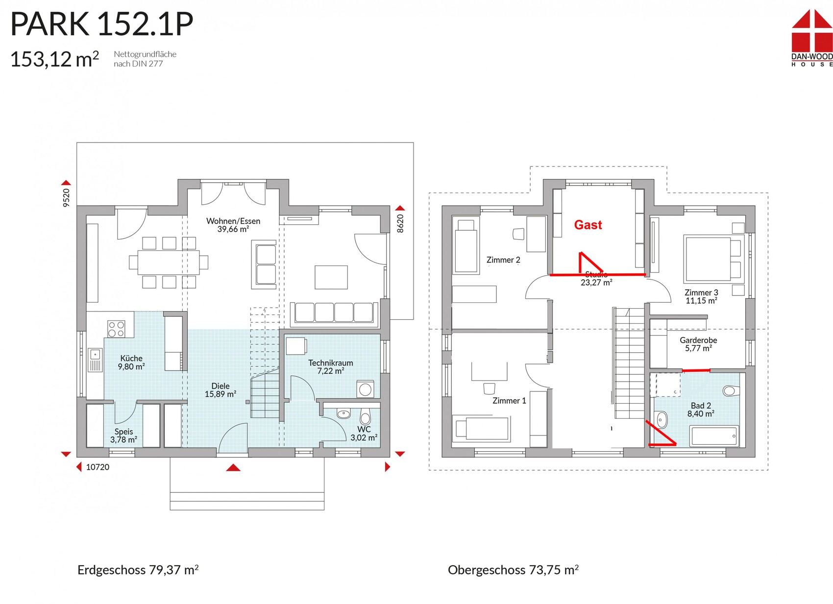

Hello? They’re even considering not placing the utility room at the back because it costs thousands more – and you come up with a third bathroom... laugh.
Try to stick to the affordable general contractor standard. You’re right. I completely overlooked the tight budget.
Danwood’s Park 152, slightly modified, might also work:
Base price 186,000 Euros – upgraded, 240,000 might just be enough?

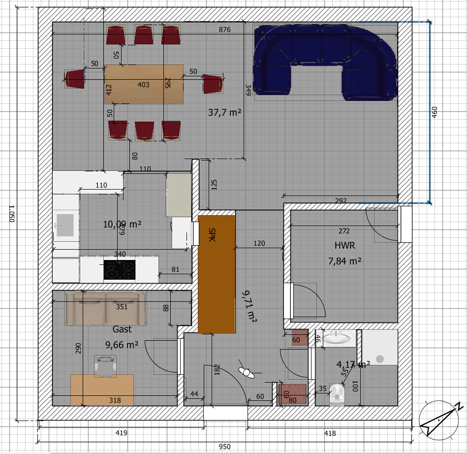

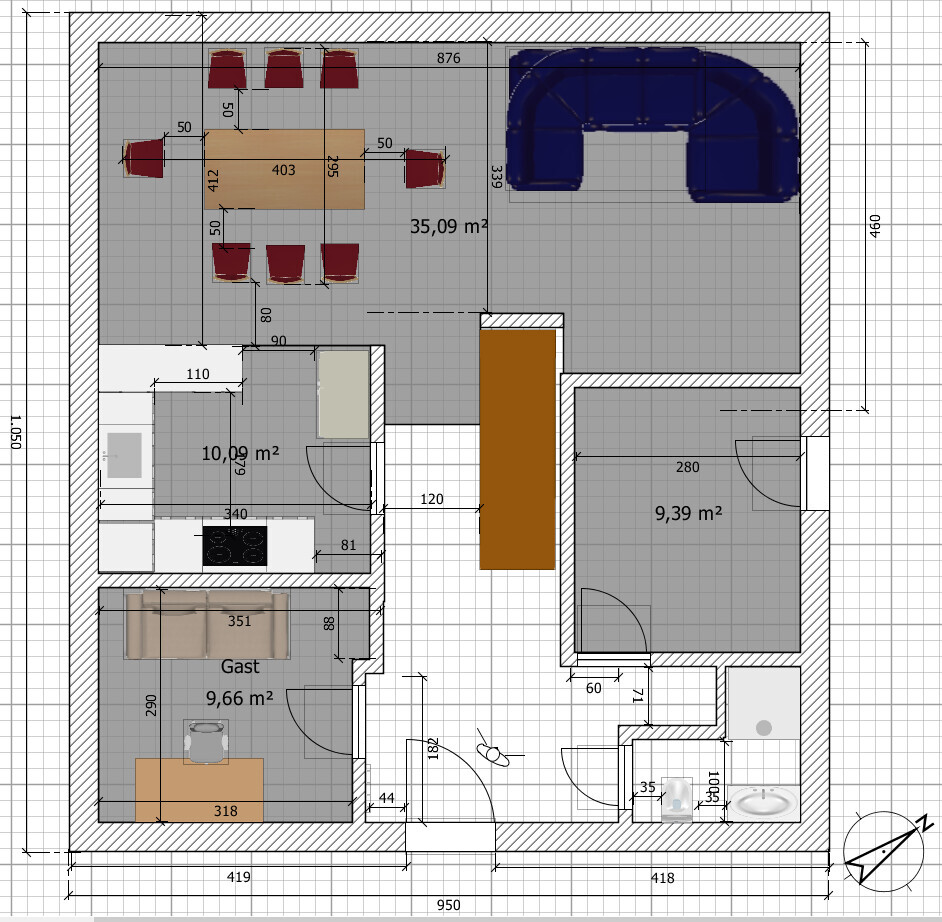

I’m finally back again.
First of all, thanks again for the drafts and ideas you shared here.
We have also been waiting and hoping for the architect’s design. After a very long delay (over 2 months), it finally arrived, but it does not at all meet what we had specified.
So now we are actively working on designing something ourselves again.
We used today, Sunday, to try to put something together. Basically, we really liked the suggestions from @ypg and @kaho674, so we tried to follow those step by step. Unfortunately, we realized again that some experience is missing in certain areas. For example, how to plan the storage space under the stairs, how large this generally should be, etc. Currently, the stair width is planned at 95cm (37 inches), and the length is chosen based on a room height of about 3 meters (10 feet).
I would like to present the draft we came up with and hear your opinions.
Brief explanations:
- The front door should be centered after all, since we will have a hipped roof porch, and placing it directly on the side probably won’t look right.
- The guest room is not large but should be sufficient for a fold-out sofa, a desk, and a chest of drawers.
- Behind the door, 2-3 coats can be hung and everyday shoes stored.
- In front of the guest WC, a closet can be built into the niche to store additional coats, a vacuum cleaner, and small items.
- The staircase should be a quarter turn type, like the one Kaho674 used. From the hallway side, it will be closed off; from the kitchen side, accessible as a pantry.
- The 125cm (49 inches) corner behind the staircase was intended as a small reading nook with a view of the fireplace. Which brings us to the next problem:
- Where do we put the fireplace?
Please excuse the many somewhat confusing dimensions—I hope it’s clear enough. I placed the dining table and chairs to ensure there is still comfortable space to get up and leave the table without disturbing others. Hence the 50cm (20 inches) gap.
Since we really liked ypg’s idea of having the laundry room upstairs, we assumed the size of the utility room downstairs should be sufficient to accommodate the mechanical systems and some shelving. Or are we mistaken about that?
As mentioned above, we do not know where to place the fireplace. We want a panoramic fireplace so it can be viewed from multiple sides. Putting it against the 292cm (115 inches) wall is tricky since that wall is intended for the TV and other multimedia equipment. On the other side, the size and heat could cause issues for the dining area, refrigerator, and food storage. Also, we’re unsure how problematic it is if the chimney runs through the center of the house.
I also tried quickly to move the staircase to the other side, but that’s not easy either.
I would appreciate any further help you can give me.
Thank you very much and best regards,
Patkia
Patkia
Patkia schrieb:
We have now also been waiting/hoping for the architect’s design. It finally arrived after a very long delay (over 2 months) and does not at all match what we had requested. This doesn’t surprise me, considering how the window flat rate mentioned in the initial post
Patkia schrieb:
General: Many windows (included in the house price without quantity or size limits), sounds less like the work of an independent architect and more like that of a main contractor’s lackey. Patkia schrieb:
- The front door was supposed to be centered because we’re getting a hip roof canopy, and having it right at the side certainly wouldn’t look good Oh, nonsense. You’ll be surprised how well something “organically placed” can look.
Patkia schrieb:
It’s actually intended to have a panoramic fireplace so you can see it from multiple sides. In a social dream home build, I would prioritize differently.

@11ant
Indeed, the architectural firm was hired by the construction company.
@kbt09
I interpreted the start of your response as: "The floor plan is rubbish," or did you mean something else?
By the way, the 3 meters (10 feet) refers to the shell construction height.
Believe it or not, @kaho674’s floor plan was used as the basis. However, a few things had to be rearranged.
- The entrance was supposed to be centered for aesthetic reasons, and the footprint should ideally be taller than it is wide (to allow for a larger garden).
As a result, I had to rotate the floor plan clockwise. This meant swapping the guest room and utility room again, so the guest room wouldn’t be in the dark.
Well, and just like that the entire floor plan looks different again
The reason there is no upper floor planned yet is that my girlfriend held me back yesterday after I spent hours trying to put something together.
But the first story really needs to be built before the rest can follow.
