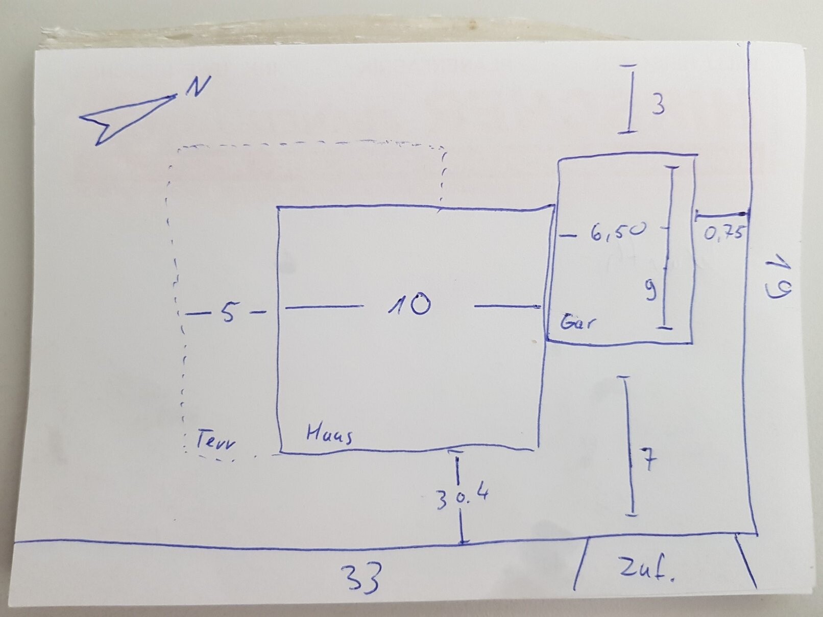

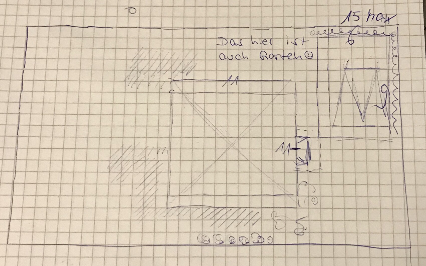

Plot size: 626 sqm (6730 sq ft)
Slope: none
Site coverage ratio: 0.35 + 50% for ancillary structures
Floor area ratio:
Building window, building line, and boundary: 3 m (10 ft), no special requirements
Edge development: permitted
Number of parking spaces: no requirement
Number of floors: 3
Roof type: -
Architectural style: -
Orientation: -
Maximum heights / limits: 12 m (39 ft)
Additional requirements: 1 tree per every 300 sqm (3200 sq ft) started

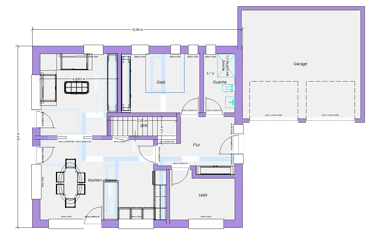

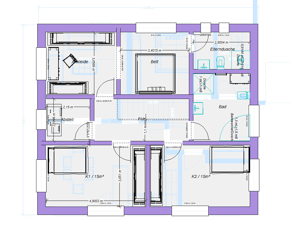

haydee schrieb:
The entrance to the utility room takes up space. The desire probably comes from the fact that without a car, you would at most go to the bakery on Sundays. If that is the case, then we really need to fundamentally rethink the ongoing debate about the layout of the main entrance, front door, and cloakroom: the often mentioned mudroom zone has always been associated with the main entrance so far.
Today I tried to sketch something, but I just couldn’t get anything reasonable on paper.
We just discussed the floor plan from ypg again together.
Along with haydee’s idea to use the upstairs room as a laundry area, we actually don’t think the floor plan is that bad.
The wall between the living and dining areas could probably be removed if everyone agrees that the odor nuisance isn’t as bad as we imagine. I have attached a picture showing how we find the layout quite nice. The fireplace would also be integrated there.
What we don’t like is that downstairs the only source of natural light comes from the entrance door and possibly some side windows, and upstairs there is no light at all in the hallway.
One option would be to move the staircase all the way to the right to have a window again in the stairwell, but then there would be a lot of free space in front of the stairs and the surrounding rooms would be fragmented.
A solution for this would probably be needed.
The subject of a door between the garage and the utility room is being discussed.
If a reasonable floor plan idea is found, we might also consider moving the door further to the right, but not around the corner.

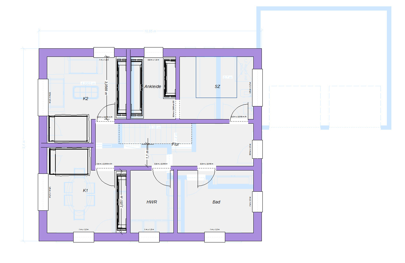

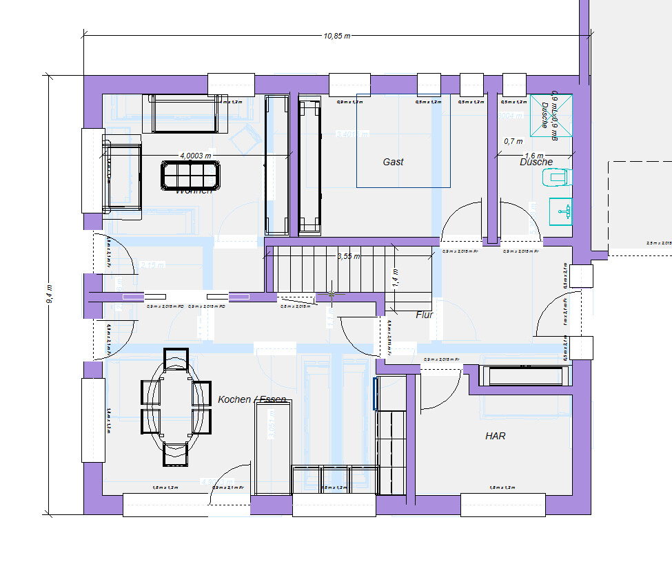

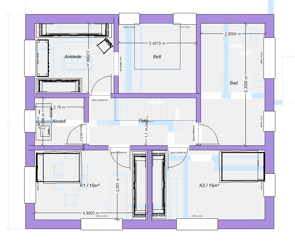

I mixed some ideas... but I’m not really in a creative phase right now...
P.S. to all the princes and kings out there – get involved yourselves instead of criticizing when someone participates and contributes here. More floor plan! discussions always welcome Wow, Yvonne crafting something – that’s becoming quite rare these days.
So I’ll throw one in as well.
The goals were
- to bring sunlight into the kitchen/dining area
- to design a realistic staircase (unlike the original draft – which I find quite questionable) (the staircase has no landing – software error)
- a guest room where guests can really stay – possibly also a future bedroom
- an additional utility room upstairs
- not to exceed the floor area drastically (101.99 m² (1098 sq ft) compared to 99.xx m² (1065 sq ft))
Major garage requests and the entrance side were sacrificed.
Alternative upper floor to #33:
with a small laundry room (washing machine + dryer), but a luxury walk-in closet, large bathroom, and spacious children's rooms of 15m² (160 ft²). Natural light in the hallway should come through skylights in the doors.
On the ground floor, one wall in front of the stairs in the entrance area was removed to create a more spacious feeling.
kaho674 schrieb:
Now I can also upload this, in case there is leftover money, to plan a small parent’s bathroom on the upper floor:
]Hello? They are even considering not placing the utility room at the back because it costs a thousand times more – and you come up with a third bathroom... laugh
Try to stick to the affordable general contractor standard.
