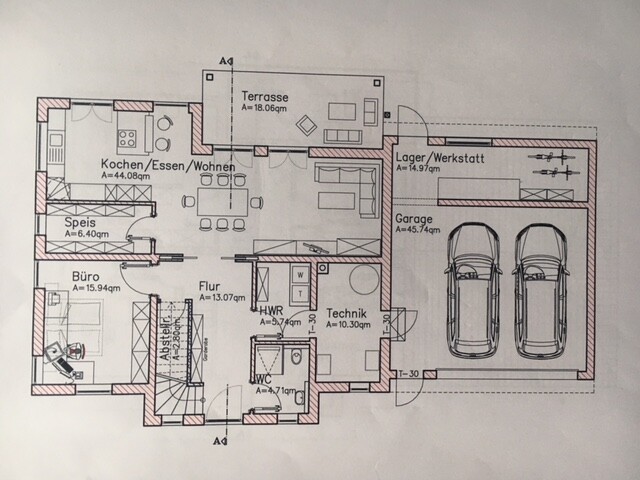

Thanks to the forum and house building catalogs, we (male 31/female 28) actually had quite specific ideas about how the floor plan should look. Unfortunately, I’m really bad at spatial imagination and sketching, so I can’t put my ideas on paper. Our architect friend created the following floor plan after a discussion with us. What can I say? We are still a bit unhappy because our wishes were not very well implemented. Before I write too much, I think it makes more sense to fill out the questionnaire so you get an idea of what we envision and what we are allowed to build. I am very grateful for ideas, suggestions, and possible changes! Thanks in advance 🙂

Who designed the plan: architect friend
What do you particularly like? Why? Separate garage access, storage under the stairs used, office near the entrance (clients don’t have to pass through the house)
What do you dislike? Why? Overall more complicated floor plan,
Ground floor: kitchen/dining rooms are not on the same level, no sliding door between kitchen/dining and living room, passage through technical room instead of utility room as intended, utility room too small, missing tiled stove

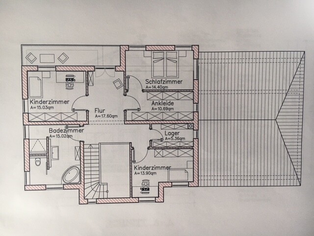

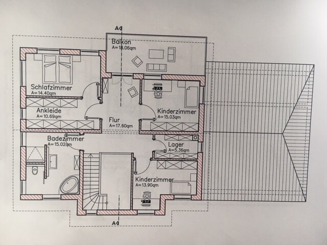

Upper floor: bedroom/walk-in closet/bathroom as walk-through not implemented, access to bedroom through walk-in closet, children’s rooms somewhat small
If you have to give up something, which details/extras
- can you do without: balcony, gallery, freestanding bathtub
- can you not do without: sliding door between kitchen/dining and living room, walk-through access between bedroom/walk-in closet/bathroom

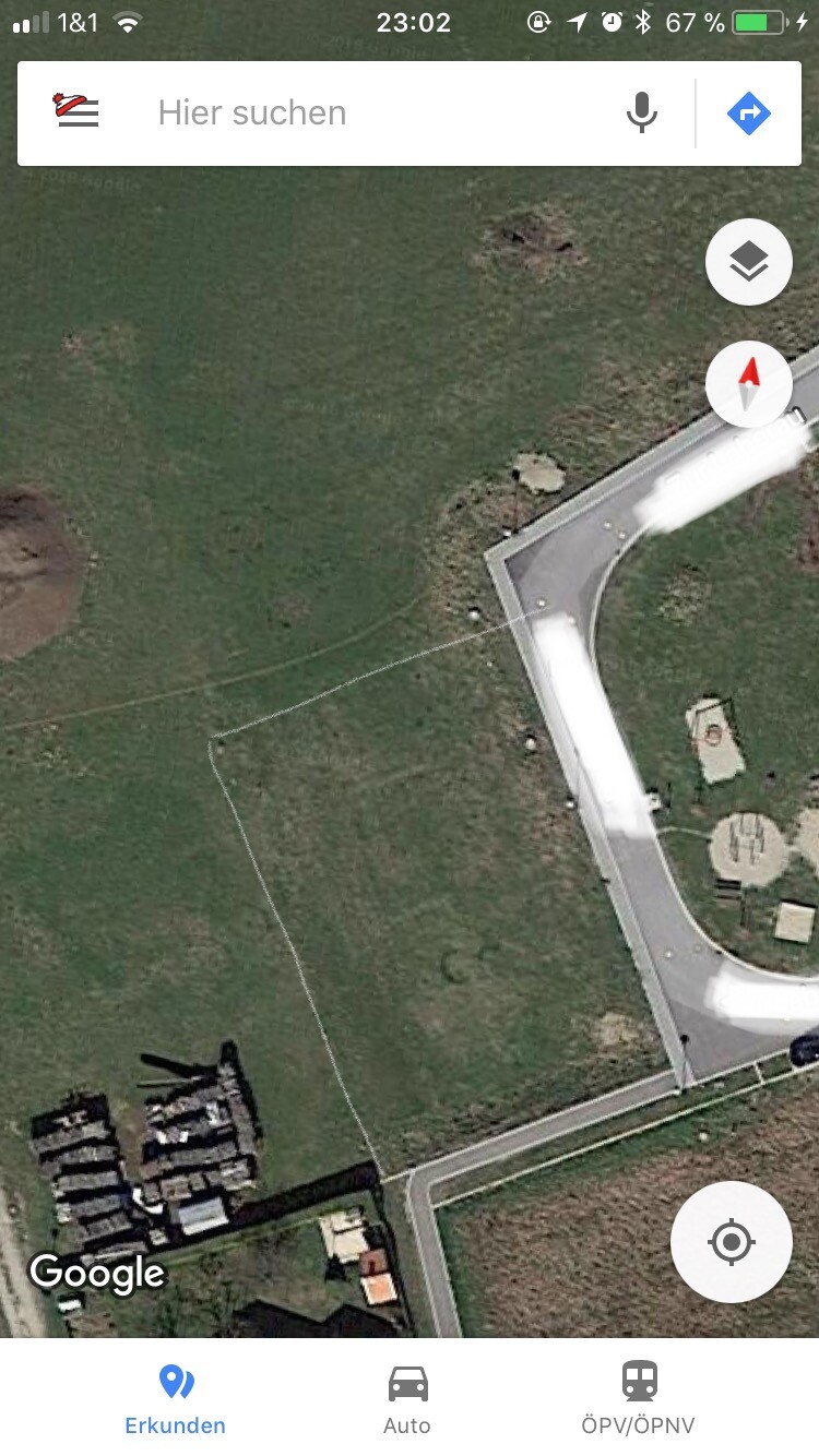

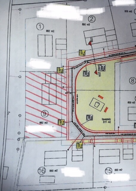

How should the house be positioned on the plot?
Where should the driveway be located?
1. Swap the children's room with the bathroom!

The garage should be positioned as close as possible to the northwest property boundary. Pretty much like on the site plan. The garage can be set a bit further back, and the house close to the ring road. The small path is only a footpath and not accessible by cars.

The room for child 2 is difficult to furnish properly (also different from the original layout). The house shape seems more coherent with a flat roof according to the floor plan; a true shed roof would also work. The garage roof only fits well with a hip roof or a pyramid roof.
Nenschn schrieb:
Overall, a more complex floor plan,
Please explain (in words or with a "not so skilled" drawing) where the complex layout was not your preference or how you would have wanted it differently.

Is the site plan oriented to true north?

A utility room with a passage through the technical area makes little sense to me and takes up valuable space.
I always find a staircase at the entrance less than ideal, as it is in a dirty area.
I would completely rethink the ground floor layout in the entrance area. Possibly move the utility room to the upper floor (see below) and carefully consider whether access from the garage is really necessary. We have discussed this many times here, and I will repeat myself: yes, I also like it if it works, but it only really makes sense if you are building on a larger scale and this passage does not cause compromises elsewhere. A better solution is a protected (covered) path from the garage to the entrance, and that solves the issue well.
Balcony—why? You have a garden, and I assure you, this balcony will hardly ever be used. Who would use it? You, for a quick cigarette afterward? Or to look at the stars before going to bed?
I would rather use that space as living area and place the utility room with the washing machine and dryer upstairs (since most laundry is generated there anyway; it’s inconvenient to carry laundry downstairs to wash it and then back up again, right?). At most, a small service balcony could be useful to place the dryer outdoors. But even a floor-to-ceiling window in the utility room that can be opened to provide enough air for drying laundry would suffice.
