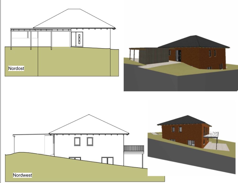

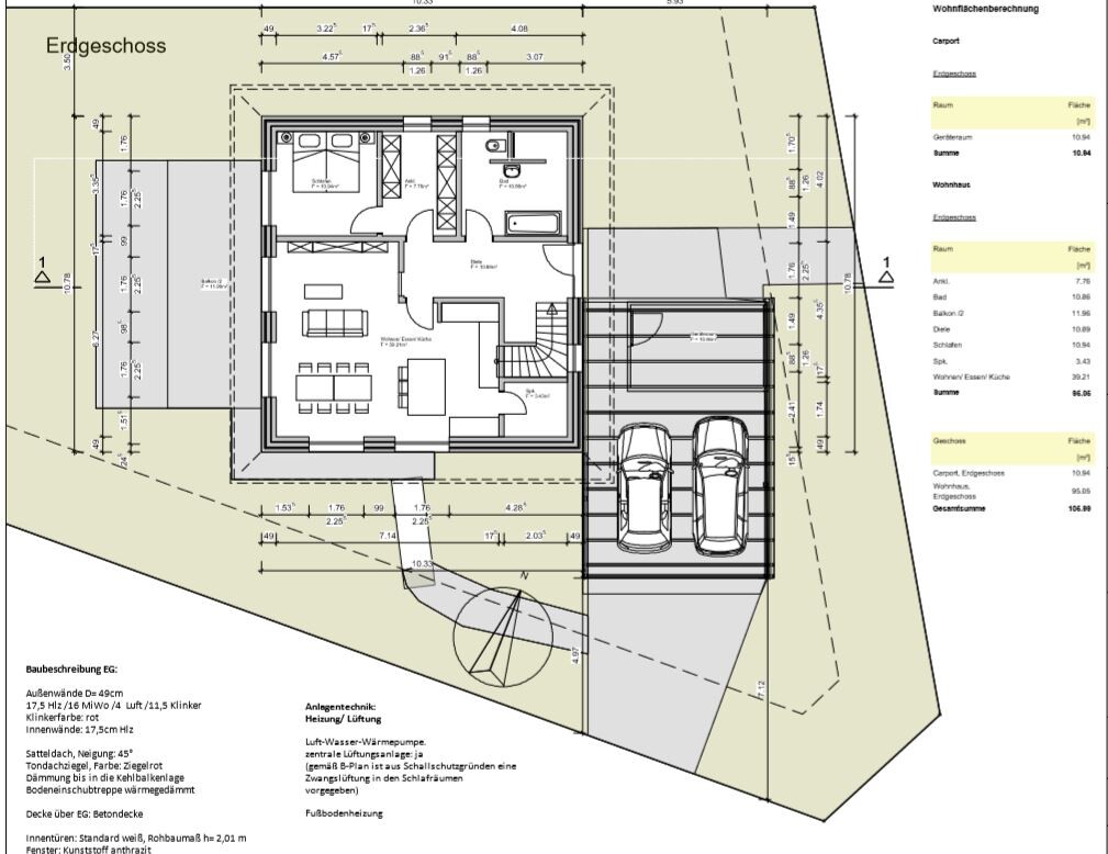

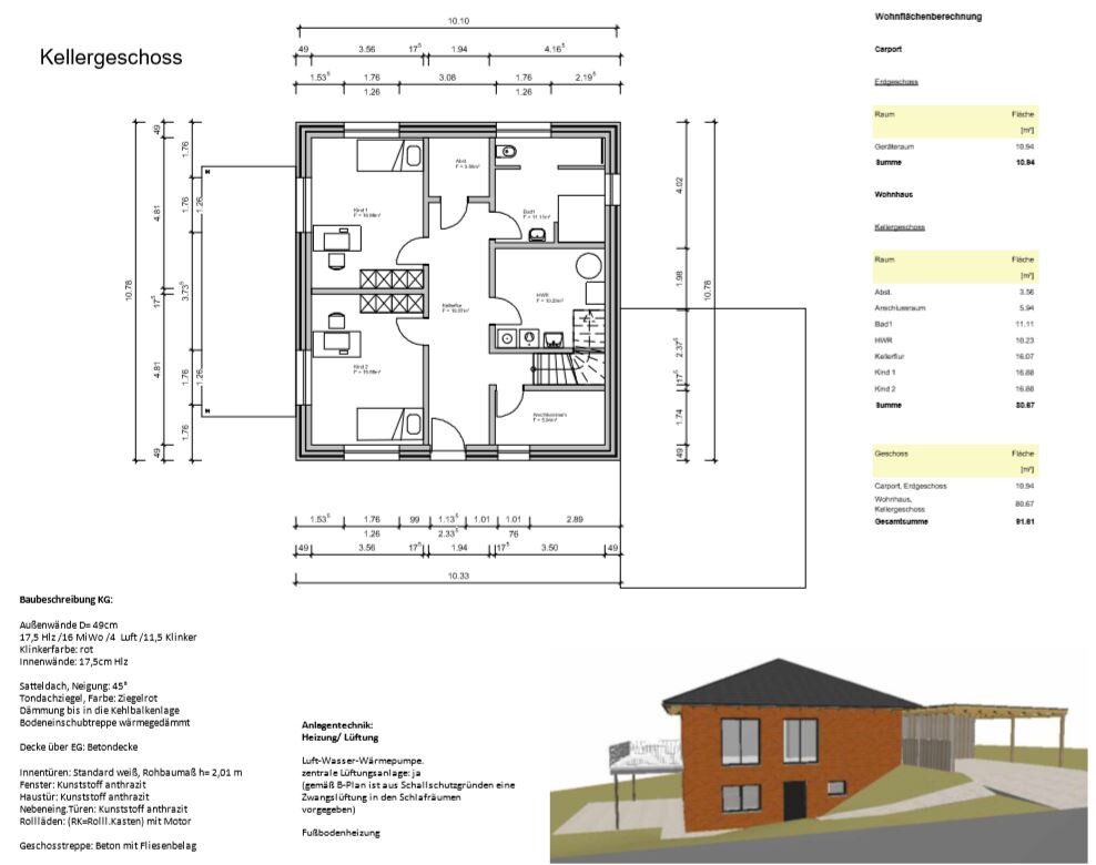

we are in the process of building a single-family house with a basement suitable for living. This is the design we have come up with. I would like to hear from you if you see any possibilities for improvements.
On the ground floor, there is a side entrance door on the right. The carport will be located there.
In the basement living area, the children's rooms face south. From there, it should be possible to access the terrace and the garden.
I look forward to your tips and suggestions!

You have a lot of hallway space on both floors. This should be reduced. Possibly a different staircase and staircase location.
Pantry on the upper floor can be removed (it's just a leftover area due to the staircase position).
You have two large bathrooms. I would reduce the size of one bathroom.
I’m not a floor plan designer, but you can save a few square meters without any loss of functionality.
