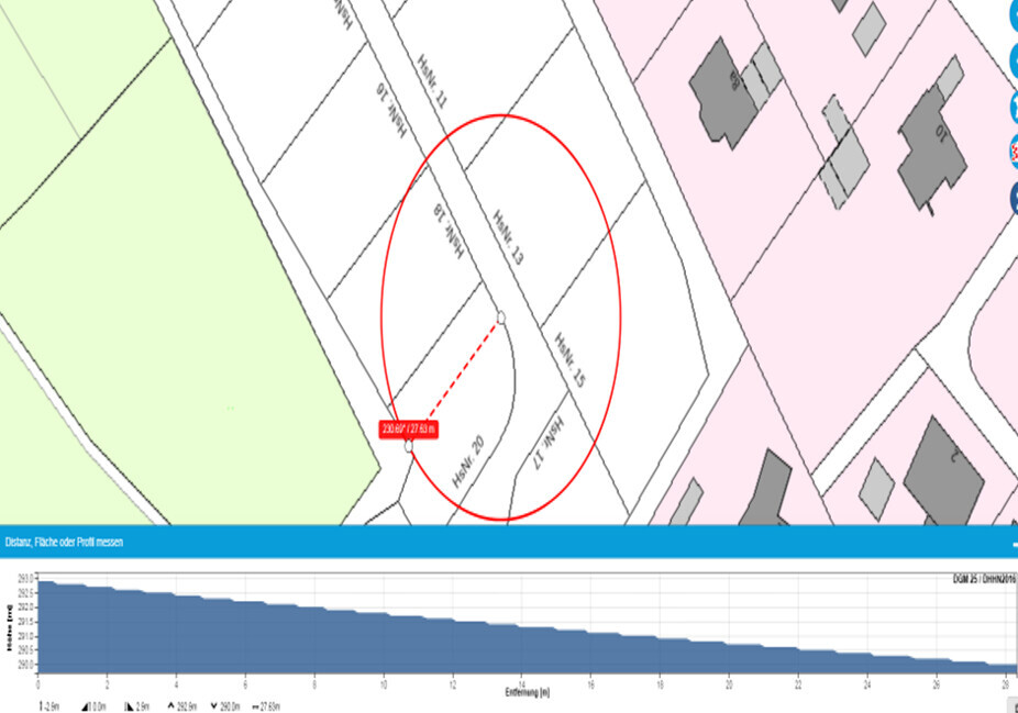

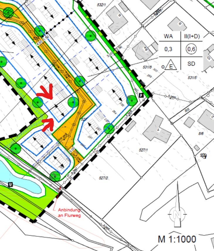

Hello dear forum members,
as future homeowners, we kindly ask for your support in planning our house.
Plot size -> 597 m² (6425 ft²)
Slope -> yes (approximate gradient: 3.7 meters (12 ft) at the long end / 2.9 meters (9.5 ft) at the short end) according to attachment
(after 8 meters (26 ft) – possible house start – approx. 80 cm (31 inches) / after 17 meters (56 ft) approx. 1.8 meters (5.9 ft))
Site coverage ratio -> see attachment
Floor area ratio -> see attachment
Building window, building line and boundary -> see attachment
Edge development -> see attachment

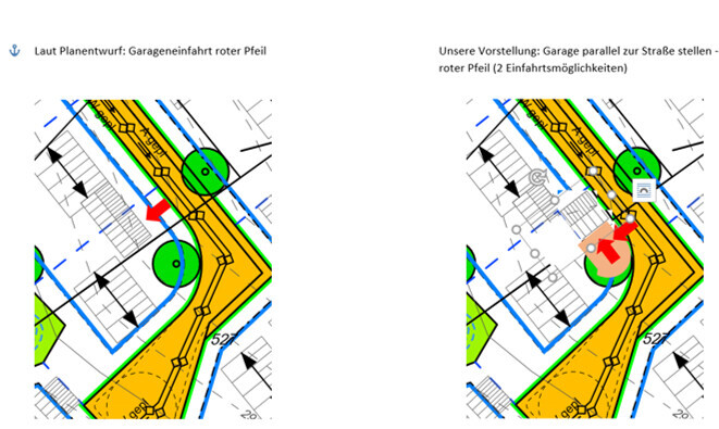

How can we position the garage and carport so that the house, approximately 10 meters (33 ft) wide and with the desired floor plan, can be placed as far forward toward the street as possible? Our goal is to maximize the garden space at the back. Or are we stuck on the garage, or should the house look different to allow moving it forward?
We have already asked the municipality whether it is possible to rotate the garage and place the driveway differently (see attachment). According to their preliminary check, there are currently no objections. However, I am somewhat skeptical (keyword: turning radius). It is a cul-de-sac with a 30 km/h (20 mph) speed limit.

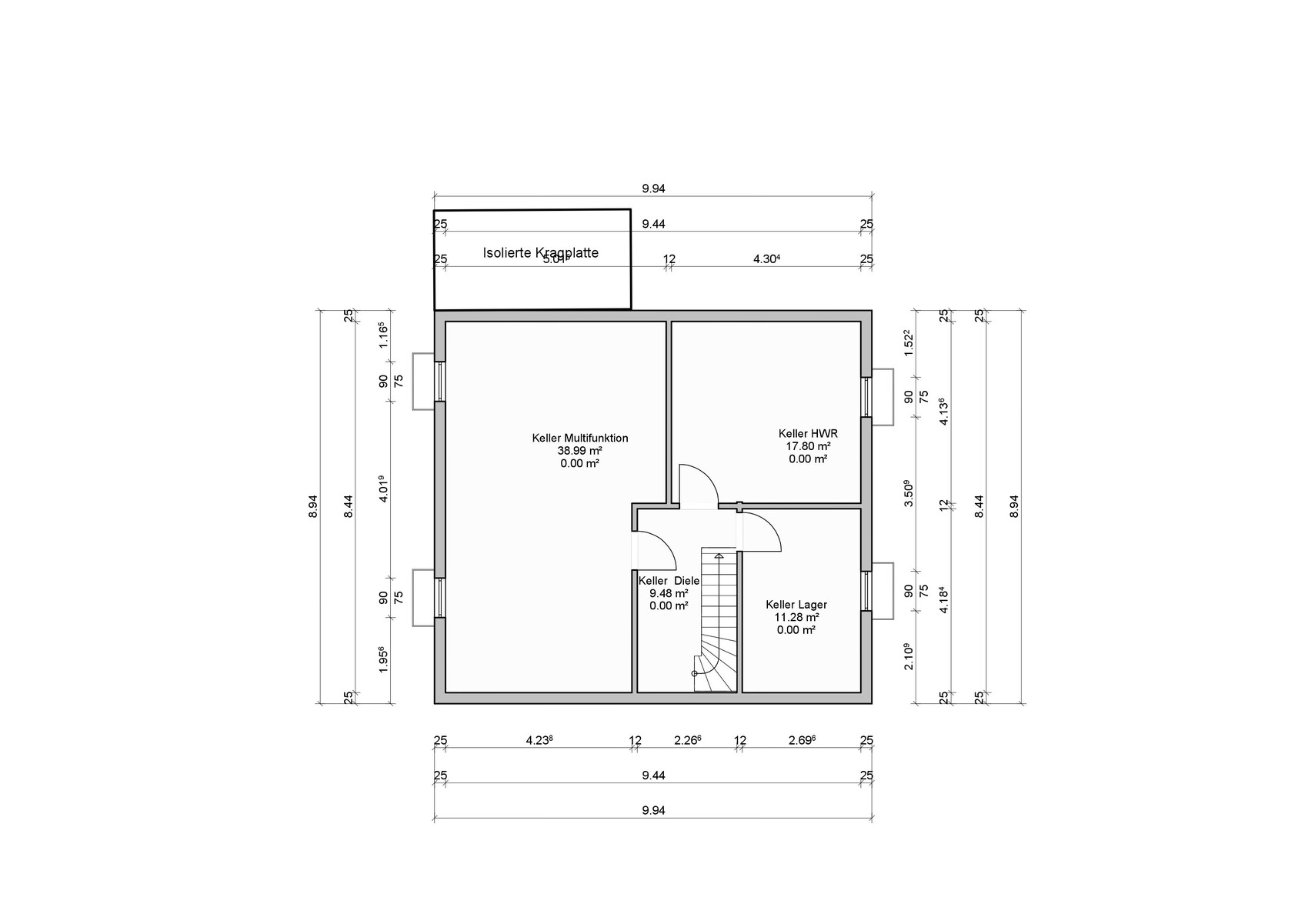

Furthermore, we are still considering whether it makes sense, given the sloping site, to build a habitable basement or invest capital in it. Renting it out is not planned, but it may be used for the children later or as a recreational basement.

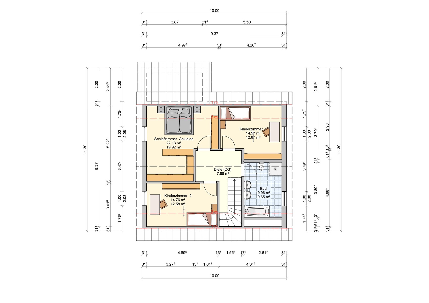

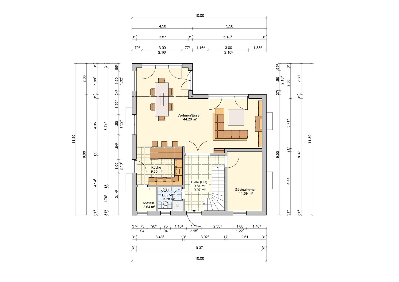

Floor plan of a house: living/dining, kitchen, hall, guest room, shower/WC, storage room
Floor plan diagram of an attic floor: bedroom, dressing room, children’s room, bathroom, hall
Basement floor plan with rooms: multifunctional, utility room, storage, hall and staircase (dimensions).

the kitchen will be very small, meaning there will be little counter space. It would need to be extended into the living area. The wall at the bottom of the plan, 343cm (135 inches), is long enough for 2 tall cabinets plus a corner.
You have to walk around the island every time to get to the refrigerator. A better solution would be to have access from the hallway or to position the island against the exterior wall. Even then, the kitchen would still be too small.
11 Feb 2020 16:08
Which direction does the slope face? Does it go uphill from the driveway?
If after 8 meters over a width of 9 meters (approximate house width) there is still a 1.80-meter (5 ft 11 in) slope remaining, I would suggest building a basement level with living spaces instead of a cellar. You might consider omitting the second upper floor or go for a staggered shed roof design and make the second upper floor a half story.
That would be a matter for an experienced architect.
Regarding the current design: where is the cloakroom supposed to go?
There are long distances to the storage room (behind the kitchen and in the basement) and also to the dressing room. It would be better to avoid surrounding these areas with walls by creating direct access from the hallway or placing the entrances alongside the interior walls.
The 3.70 meters (12 ft 2 in) in the living room are insufficient for a sofa of that size or layout.
The kitchen size is also close to the minimum for four people.

Is the main entrance facing northeast?
I’m not happy with the size and natural light in the children’s rooms. One child’s room has a small southeast window, the other a small northwest window. The latter will rarely get any direct sunlight. I would add either dormer windows or roof windows to improve lighting from two sides. Also, place children’s bedroom 1 on the southeast side for more daylight. Additionally, allow the children 1–2 m² (11–22 sq ft) more space by taking some from the “master sleeping area.”
The huge sofa doesn’t fit— as Yvonne mentioned— in the middle of the living room. If neither the room size nor the sofa size can be changed, I would place the sofa directly against a wall (or even two walls) to leave a good walkway on at least one side.

We have already asked the local authorities if it would be possible to rotate the garage and reposition the driveway (see attachment). According to their preliminary visual inspection, there are currently no objections. However, I am a bit skeptical myself (keyword: turning radius). It is a dead-end street with a 30 km/h (18.6 mph) speed limit.
Are you also allowed to move your house forward?
In that case, I would do it that way and design the driveway so that you can drive straight onto the garage. Otherwise, you would probably have problems with the cars’ turning radius. There are only three other houses behind your driveway in the dead-end street, so there is very little traffic. As long as there are no visual obstructions, I see no problem with this, provided you can turn your necks enough to check for traffic coming from both directions.
