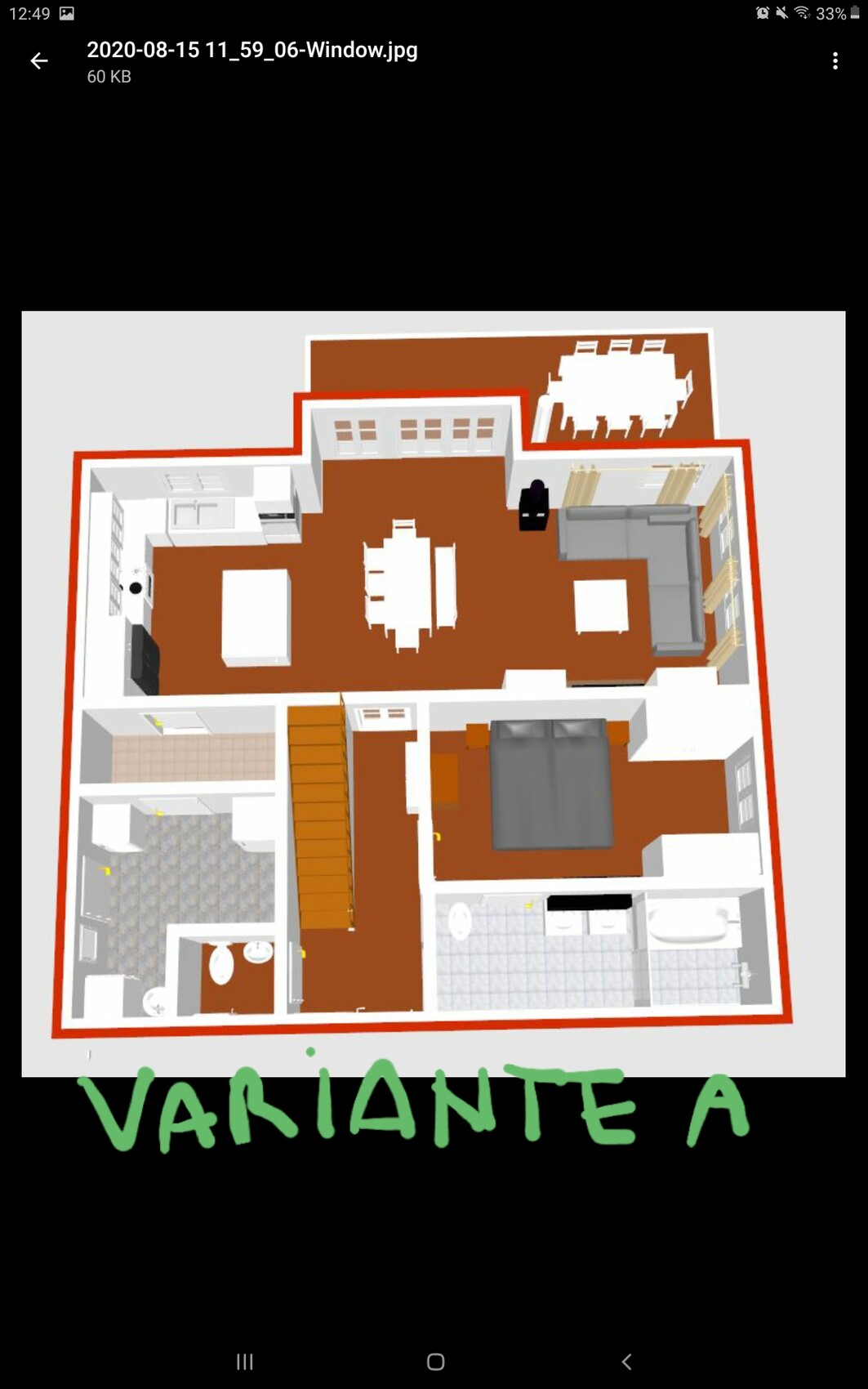

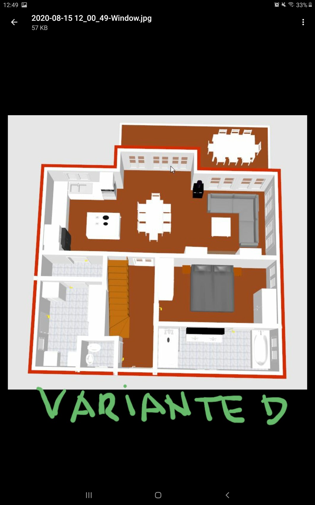

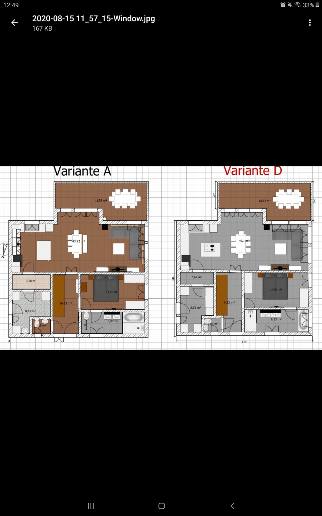

For the ground floor, I have two variants:
Variant A was our original plan. The bathroom features a kind of wet room inspired by Pinterest.
Variant D is the plan after much consideration on how best to utilize the space.

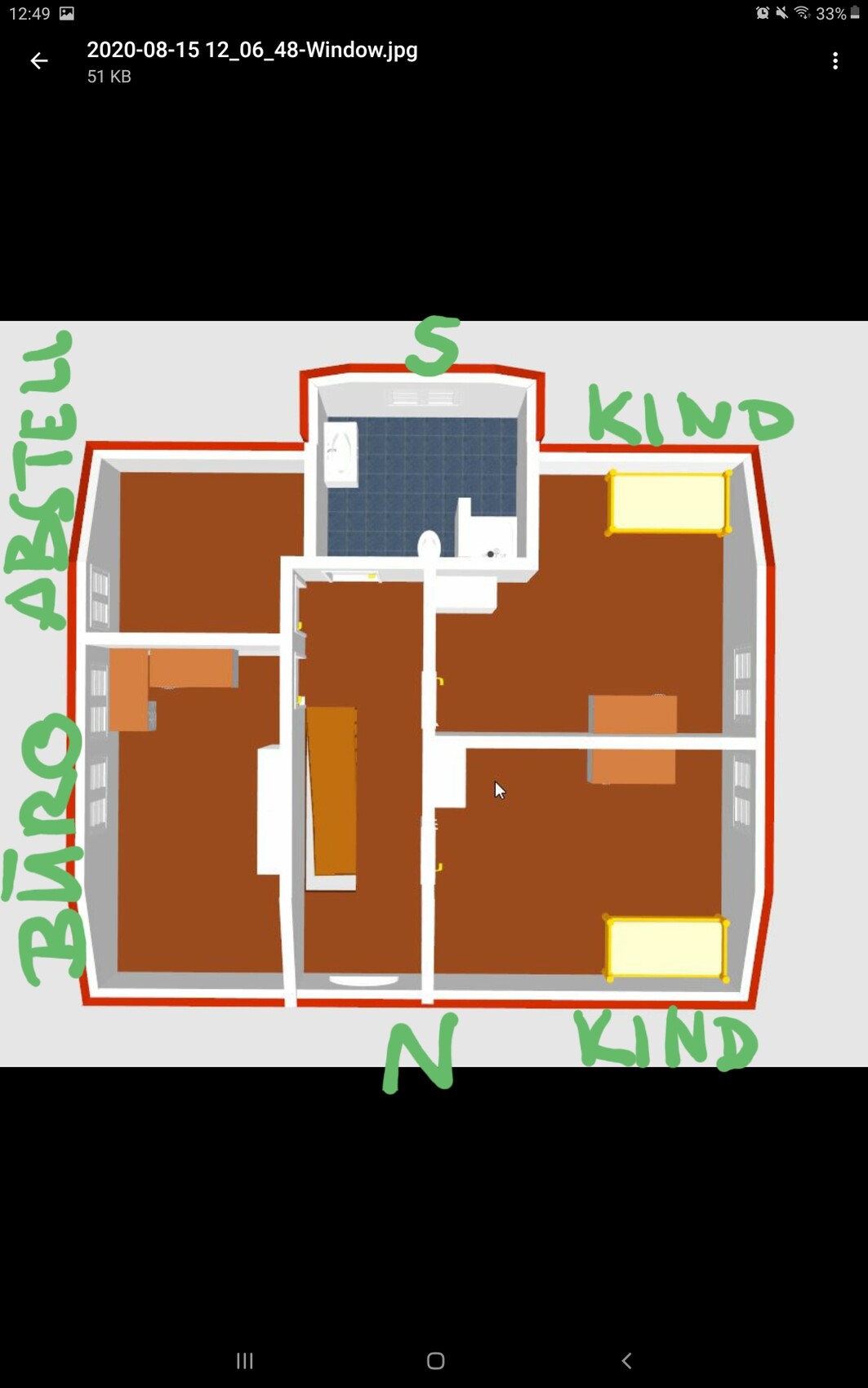

The upper floor remains unchanged.

Sorry, of course.
Since I'm feeling generous, I went ahead and did it right away. I hope everything fits now.
One thing to keep in mind, I just realized, is that we want to take some furniture and appliances with us since they are brand new.
These include our bed, the side-by-side refrigerator, our freezer, as well as the dryer and washing machine.
The measurements are already correct here.

I find everything planned very tight. Have you ever sat so close to a fireplace? The fireplace is right next to the sofa and can’t really be used. I also don’t see any space for a coat rack; the hallway is very narrow, and the staircase is only 3.50m (11.5 ft) long.
