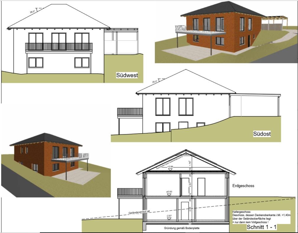

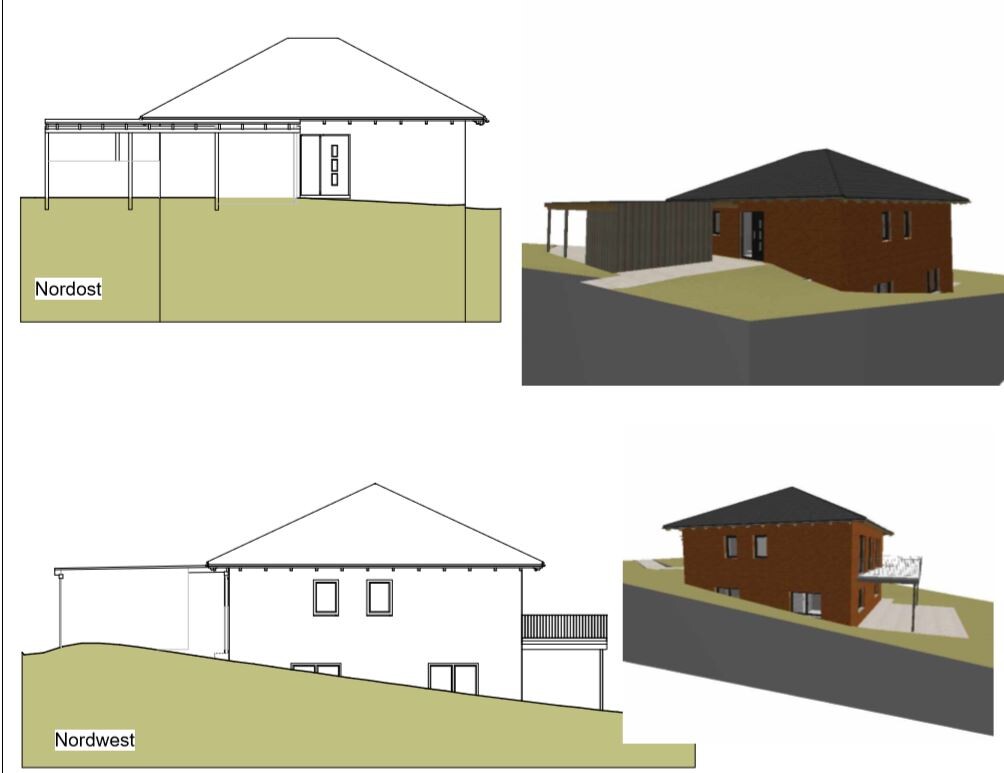

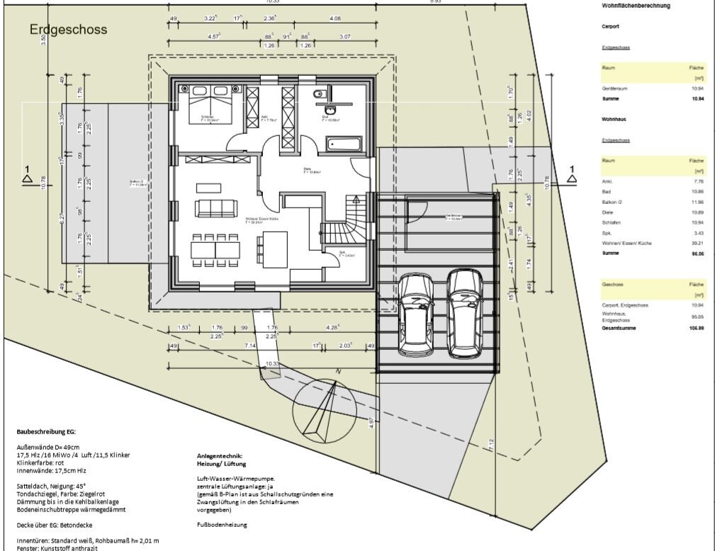

Here is the preliminary draft:
Architectural drawing: House on a slope with terrace; northeast and northwest views.
Construction drawing of a house: 3D view, balcony, sections (southwest/southeast).
Basement floor plan with dimensions and 3D house view.
Ground floor plan: living/dining area, kitchen, bedroom, bathroom, stairs, double garage.
haydee
22 Jan 2019 19:48
I like the basement (UG) much better, but not the ground floor (EG).
Asuni
22 Jan 2019 19:58
In my opinion, a combination of both designs would be quite nice: the basement from the preliminary draft and your ground floor, but instead of the technical room / utility room, place the bedroom on the living level. With well-planned kitchen design, storing groceries will also not be a problem.
