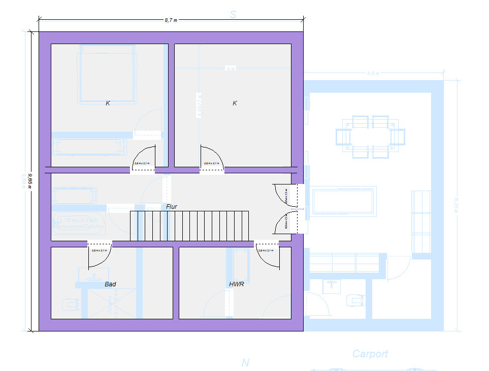

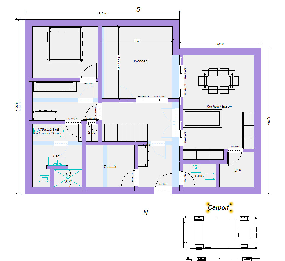

kaho67413 Mar 2019 13:23
Franky73 schrieb:
The pantry would be way too small for all the building services...
The building services wouldn’t be there, only the washing machine. The building services remain upstairs.
As I said, I don’t think the current floor plan is bad—just the rooms feel a bit tight to me. Everything is quite compact. But not unlivable. So why not?!
This one was created more or less on the side while tinkering. Not really an improvement, but sometimes you notice a detail you like.
Small mechanical room on the ground floor—with the utility room still upstairs. Of course, you could swap those around. The floor area should be about the same. (Orientation reversed—sorry) The goal was, among other things, a short route from the parking space to the front door and kitchen. Spaciousness doesn’t really come into the house this way either. Downstairs is just too much for that.
Floor plan of a house: hallway, two rooms (K), bathroom, utility room, living room with dining area, carport.
Floor plan of a house with living, cooking/dining, bathroom, building services, hallway and carport
