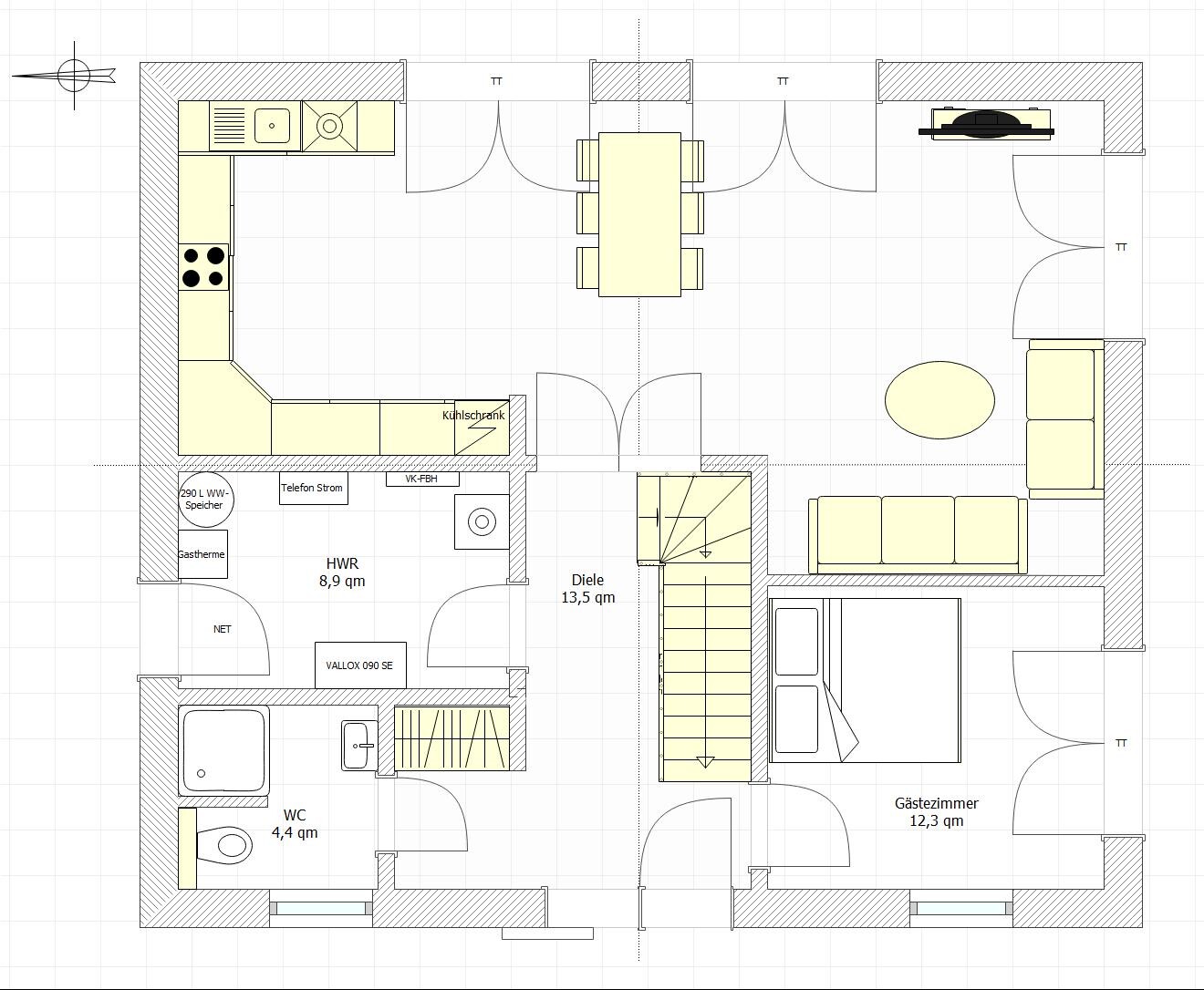

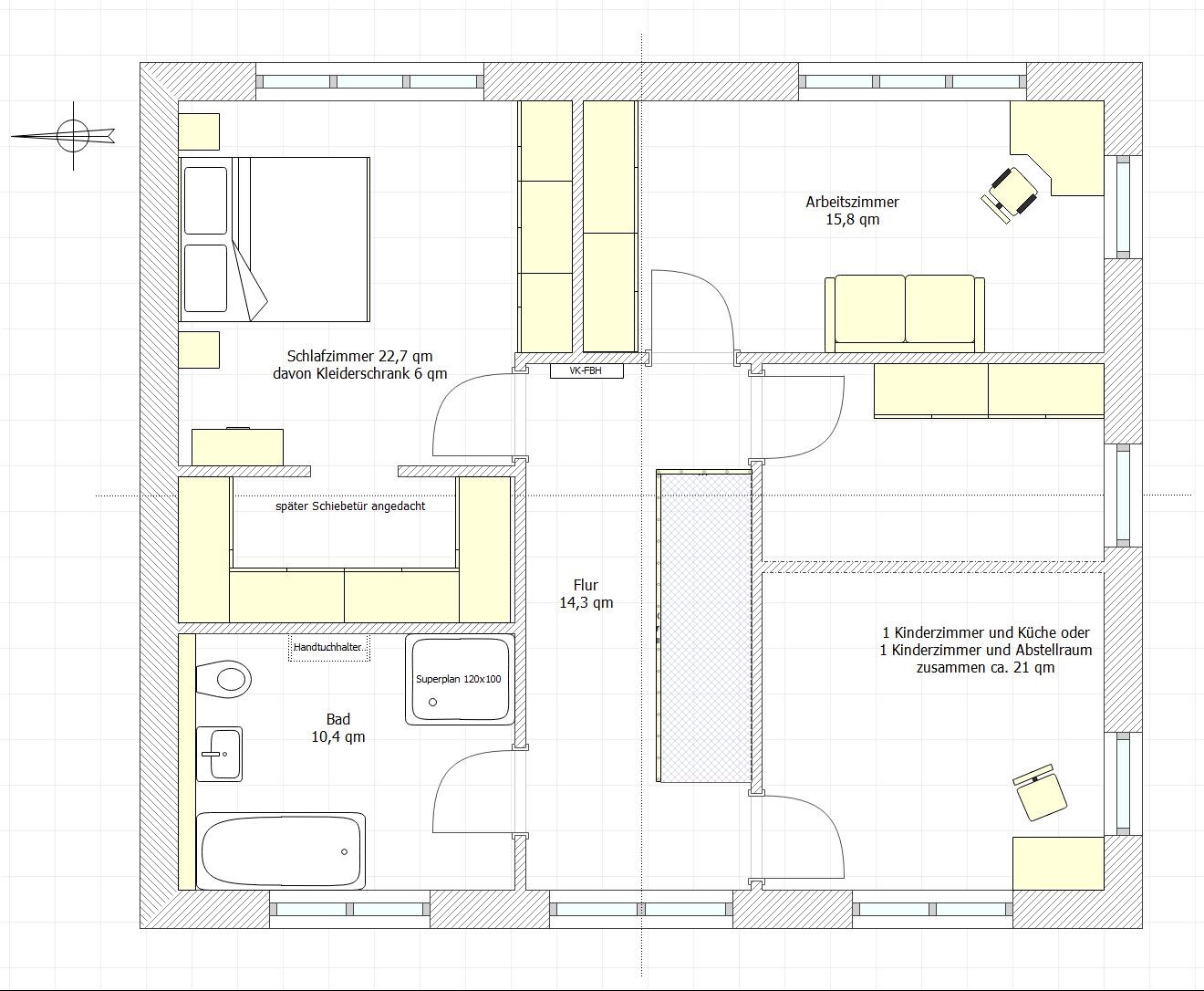

- Entrance hall: I am not sure if the staircase fits here; view of a wall upon entering; niche and doors to utility room, guest room, and WC
- Bathroom upstairs: no further considerations yet about where fixtures could be placed
- Living room: dead space in the middle; quite narrow width of about 3.70 m (12 feet) in the TV corner; entrance to the living room (possibly sliding door?)
- Currently no windows drawn on the north side in the office and bedroom (not sure if we really need them, see next point)
- View into the bedroom from outside (if shutter is down, it is dark); maybe still a window on the north side
What we can do without: everything not shown in the plan (e.g. fireplace, walk-in closet, kitchen window, large bathroom)

I like the child’s room in the first draft the least because it is difficult to subdivide, which essentially limits future owners to a single child. In my opinion, this is a drawback for the resale value.
If this is about a basic model from a provider where basically only wall layouts can be adjusted, it would make sense to introduce their standard design as a starting point for this discussion.
And regarding the child: don’t forget, they grow up too. Having 30 sqm (320 sq ft) upstairs may be less ideal than a slightly smaller room with its own entrance (and if the child moves out for university, it could be rented out as a separate apartment).

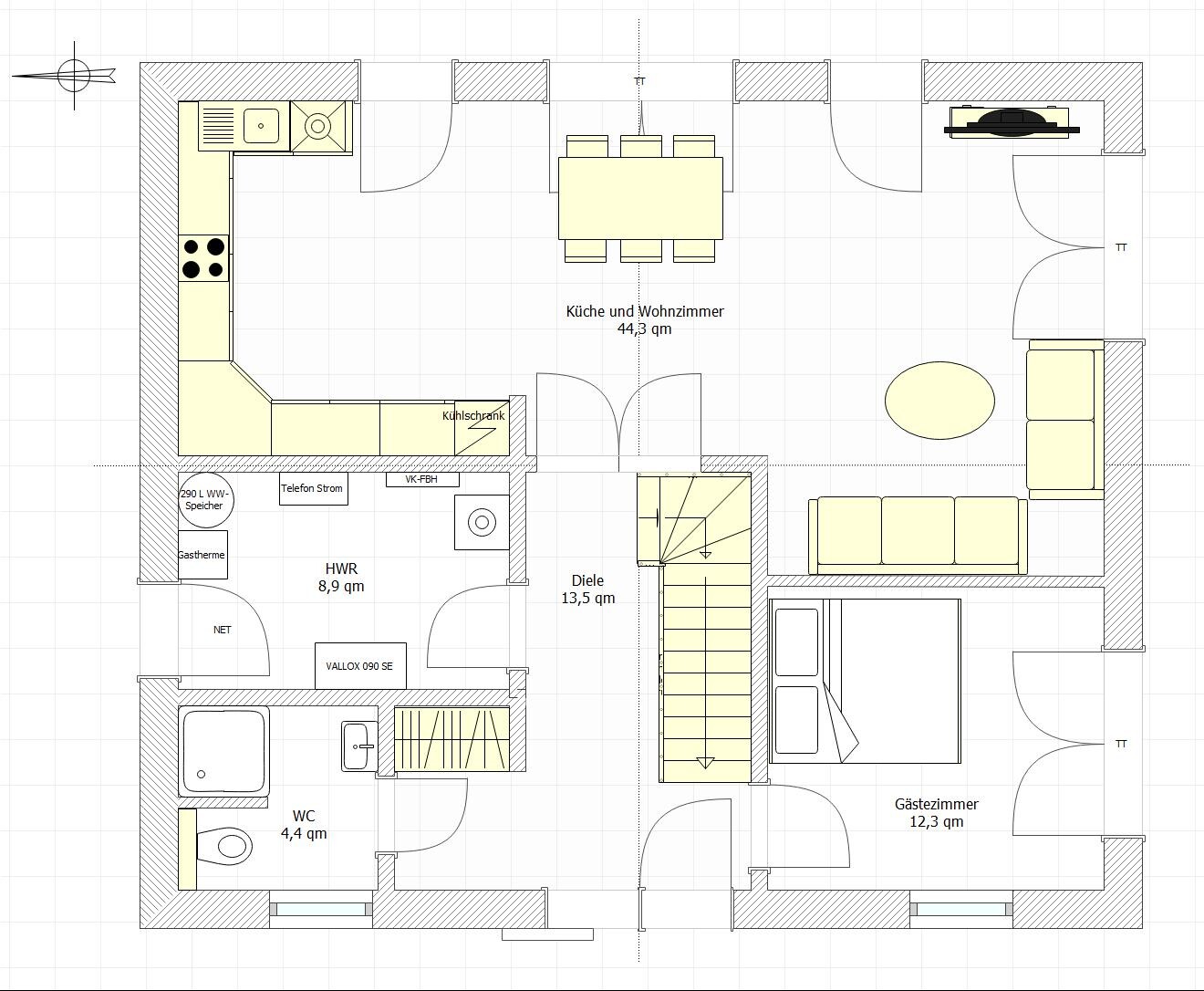

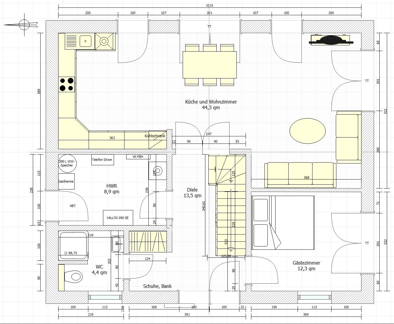

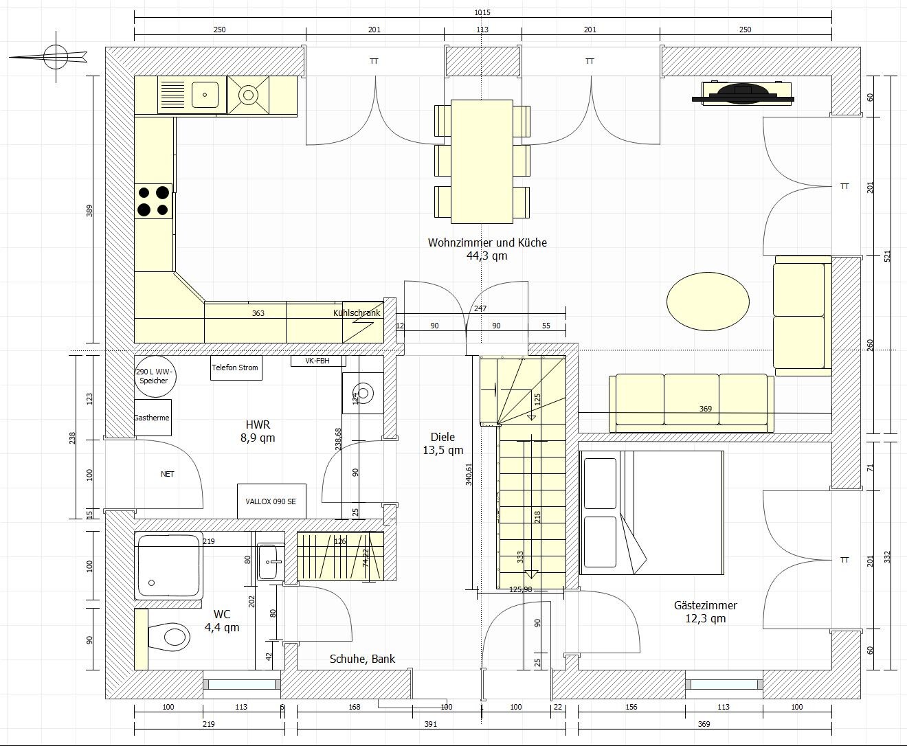

Zoning dining/living room: Yes, it looks tight with the table. I have created an adjusted floor plan. I want to look from the sofa (or a later large seating area) into the garden. So the sofa must be placed in the niche at the bottom. Unfortunately, this leaves little space for cabinets in the living room. I have now drawn two single patio doors for access. The middle double door remains closed and the table is placed in front of it. Between the doors is about one meter (3 feet) of space on each side. As a layperson, this is how I imagine it. Is this nonsense, or could it work? Or should the table be moved closer to the kitchen?
Storage room near the dressing area: I had hoped to place some cabinets in the upper hallway (about 1.40 m (4.5 feet) wide up to the stairs). There is also storage space in the study. I have left it as is upstairs for now. I like the hidden cabinets between the study and living room (wall between the two rooms), which would then have to be changed. But a door and a window can be drawn in quickly. I need to inquire about the cost of an additional room. I believe it is around 1200 euros. It is all a question of cost.
Switching WC and utility room: The architect also suggested this. I have drawn it accordingly. However, I see some disadvantages. The utility room door would be further towards the top of the plan. There will be a car parked there later. It will be a bit tight to carry things inside when I always have to squeeze past the car. Or I could make the carport wider. The bigger concern for me is potential noise disturbance in the kitchen and living room from the utility room. I have read some negative things about ventilation, the gas boiler, and aerated concrete walls. That is why I wanted to have the WC in between. Or I could have the wall to the kitchen built with sand-lime brick for an extra charge.
Townhouse with two entrance doors and a granny flat: The idea is great. But I think it would exceed our budget and the chosen builder’s scope.

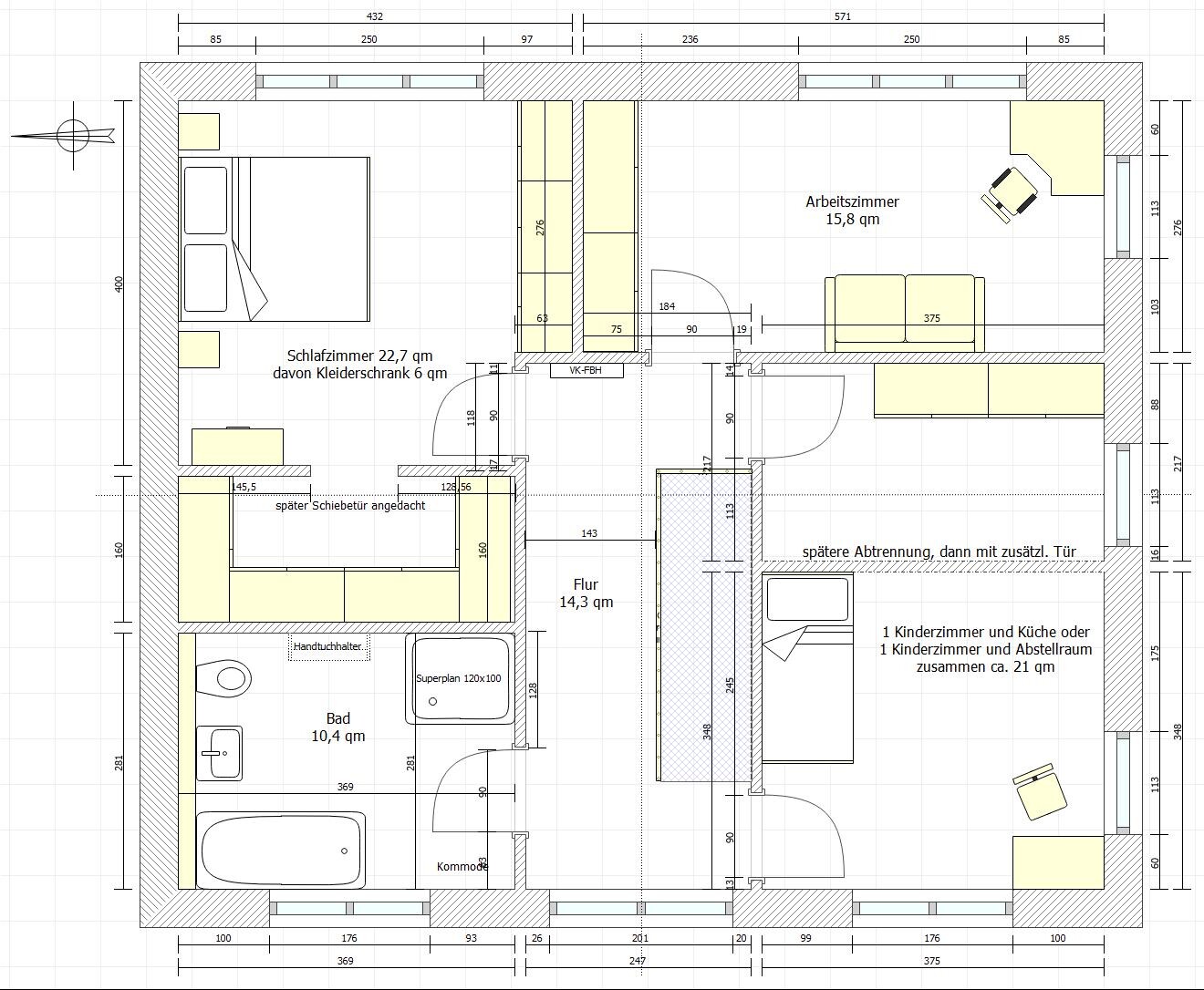

Study on the ground floor: Clearly, your points about moving the study to the ground floor have merit! We will keep that in mind. I only need a computer to work. I could work on the ground floor. But I think I can only decide after working upstairs for a few months. If I don’t like it, I can move downstairs. The rooms can always be swapped. I also want to put some fitness equipment in that room. It is supposed to be my personal room. I don’t receive clients at home.
Children’s room: Thanks for the detailed description. Honestly, I don’t know whether our daughter would prefer to play in the living room or her own room. She is only 1.5 years old now. I don’t think a second bathroom is necessary. We have two bathrooms for three people, which should be enough. But maybe in ten years I’ll change my mind. We are seriously considering adding plumbing for a future kitchen upstairs to the list of optional extras. We will see what the cost is. I have already drawn a second door, so the large room can be divided later, giving our child two ways to enter the room even now.
