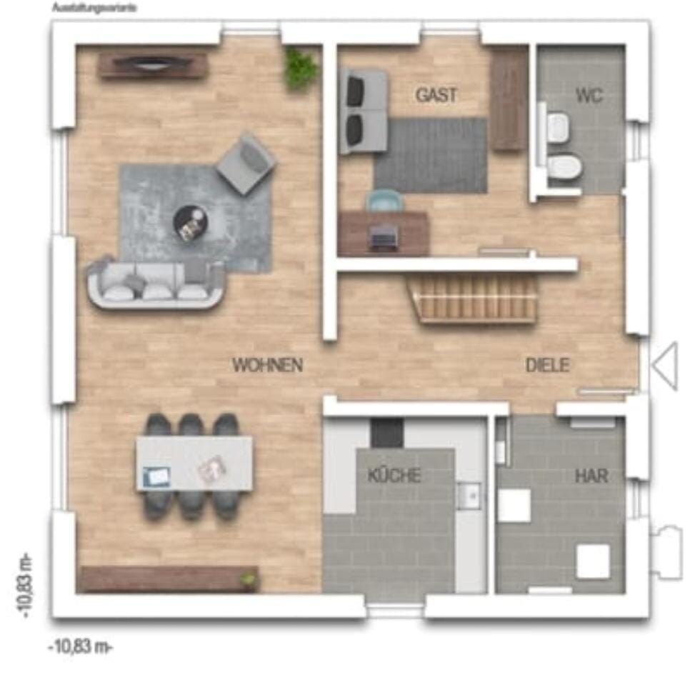

Hello dear homebuilding community,
a user from another thread suggested that we share our house plans/floor plan to get possible improvement ideas.
We are at the beginning of our planning phase and are currently deciding on Heinz von Heiden.
The size of the house is based on our wish to have 4 bedrooms and 1 bathroom on the upper floor.
We basically like the standard floor plan. There are a few changes we want, such as a larger utility room, a closed kitchen, a shower in the guest toilet, and a smaller living room.
We would really appreciate tips and suggestions.

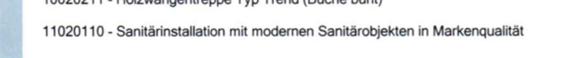

Two list entries with product codes and brief descriptions: wooden staircase and plumbing installation.
and this suggests that the plumbing belongs to a well-known brand. However, that is not the case. It is no-name and is supposed to have the same quality as a product from a market leader.

How do you want to place the house on the plot? (The site plan is almost hidden here.) I assume the entrance faces north?
Where and how should the garage be located? You need to actively work on the planning yourselves and trace, copy, or sketch the plot, and make the effort to draw everything in. Otherwise, it could happen that because of an entrance landing you can no longer drive into your garage.
Heinz von Heiden tends to build slightly higher.
First, I would mirror the house or the ground floor so that the kitchen, living area, and utility room end up on the west side.
The door can go into the kitchen.
You have 45sqm (484 sq ft) for living and dining. That’s quite generous. I would move walls so the utility room becomes larger. The kitchen would move along. For the kitchen itself, I would add a patio door for direct access to the garden. Generally, with 2-3 children, I would rather separate the living room and have a nice large open-plan kitchen and dining area where the dining table is really well used. You don’t want to be carrying the Nutella jar back and forth through the rooms three times a day, right?
Remove the wall extension by the stairs. It’s unnecessary. Without it, you can install coat hooks on the exterior wall. A cloakroom would be, for me, the second big shortcoming with 3 children: what to do with all the stuff — jackets, shoes, bags, and scarves??? That will probably end up in the office.
In the bedroom, skip the door and access it through the walk-in closet. The bathroom can be expanded. The corner children’s room should have two windows for cross ventilation. At least that gives a good spatial feeling.
The mentioned roof structure is probably walkable, too. At least it has no supporting columns. Possibly have a fixed staircase installed. A roof window there wouldn’t be a bad idea either.
Windows: I find floor-to-ceiling windows in bedrooms inappropriate for several reasons. They disrupt privacy.
You won’t get around sketching your furniture to scale and moving them around in the plan until everything matches your expectations.
However, I wouldn’t give up the search for the perfect house just yet.
