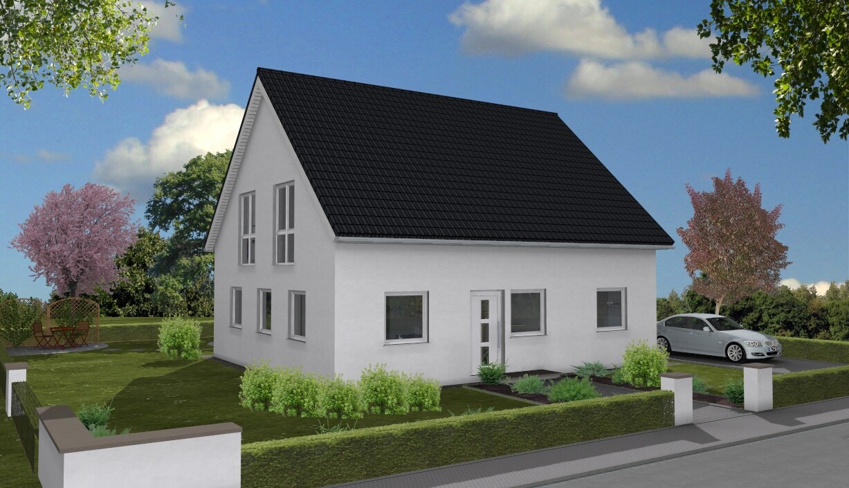

3D pictures: The exterior is completely designed by the architect and does not reflect our planning.
But for better visualization of windows / doors I find them acceptable.

I am waiting for the floor plan image files, but I already find the elevations to be more clever than the original model, despite their simplicity.
