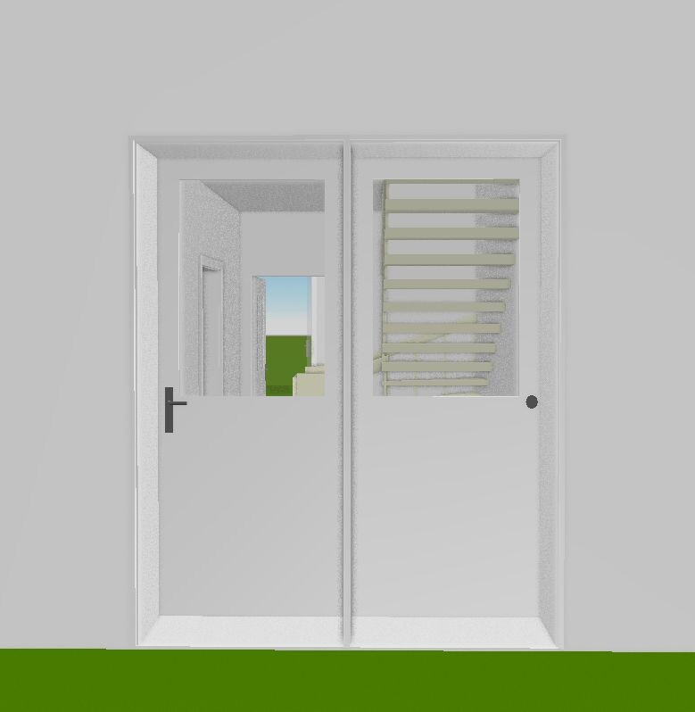

Moving the front door: Good idea! But I’m not sure if the door swing will look good (I made a picture, just imagine the right handle removed). Or maybe you meant something else. I will ask during the planning meeting what other options there are for the doors. They always try to sell extra features anyway. I also like the version with two sidelights on either side. That would soften the view of the stairs.

Stairs too close to the entrance: Maybe it improves if the door opens further to the left (see above).
