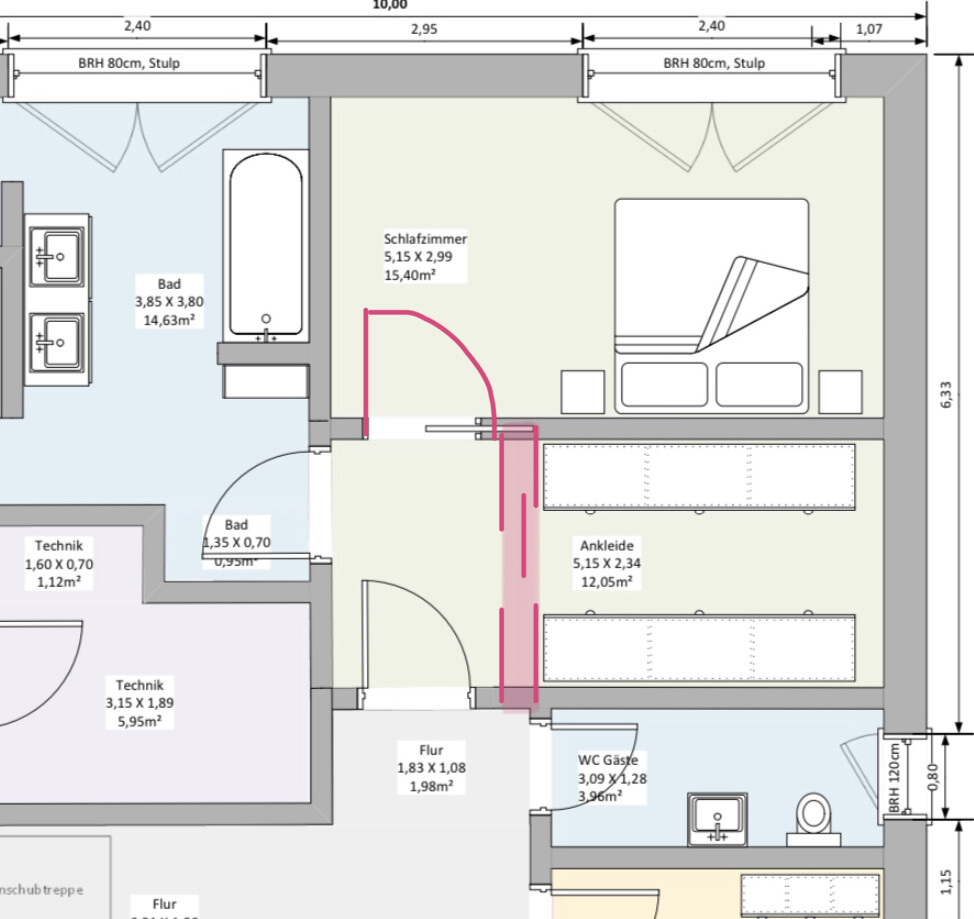

Hello 🙂
After what felt like hundreds of crumpled drafts in the recycle bin, we finally have a floor plan that we like and that fits our size requirements. Initially, we planned way too large, sometimes over 250m² (2700 sq ft) of living space... oops... Now we have settled on a nice 150m² (1600 sq ft) 🙂
We mainly reduced the number of rooms. Originally, we planned 2 offices and 2 future children’s rooms, but now only 2 offices remain, with at least one definitely convertible into a children’s room. This makes more sense since we don’t want to seriously consider having children before at least 5 years from now. We also initially planned a small wellness area with a sauna, loungers, and a hot tub inside the house, but this will now be a separate building in the garden.

Neubau202218 May 2022 21:59Ramona13 schrieb:
Children are not planned at the moment, so that didn’t occur to me right away 😉 But it’s definitely a good point.The lift-and-slide door is 3m (10 feet) wide and about 2.35m (7 feet 8 inches) high. In the bedroom, the floor-to-ceiling window is 1.75m (5 feet 9 inches) wide and about 2.31m (7 feet 7 inches) high. The remaining windows are 1.40m (4 feet 7 inches) high.
Ramona13 schrieb:
Children are not planned at all initially, so that idea didn’t come to me right away Uh… if you haven’t finished that chapter yet, you wouldn’t design the main bathroom layout like that. I was assuming a permanently child-free couple.
Kitchen/living/dining area looks good to me. Utility room—has it been confirmed that the connections from the street are in place?
kbt09 schrieb:
Uh... if that chapter isn’t finished yet, you probably wouldn’t plan such a setup for the main bathroom. I was assuming a permanently childfree couple.
I think the kitchen/living/dining area is good. Utility room—are the connections from the street confirmed? Actually, we don’t want children, but at our age you often hear things like “the desire for children will come later, you’re still young,” and somehow it’s internalized that you might want to keep the option open… 🙄
The connections aren’t clarified yet. What kind of problems could there be? The two building plots theoretically give us two connection options.
Yes, that could be one way to solve it.
The utility connections would probably need to be routed under the slab or brought to the house in such a way that they arrive on the north side at the utility/technical room.
Has the latest floor plan already been reviewed by the architect or builder?
kbt09 schrieb:
Yes, that could be a possible solution.
The utility connections would likely need to run under the foundation slab or be routed to the house in a way that they arrive at the north side near the utility/technical room.
Has the latest floor plan been reviewed by the architect or the contractor yet?Running utility connections underneath the foundation slab (more than xx cm) is often not permitted by all utility providers—for water, gas, electricity, etc. This needs to be clarified in advance before proceeding with any further planning steps; otherwise, it doesn’t make much sense.Similar topics
