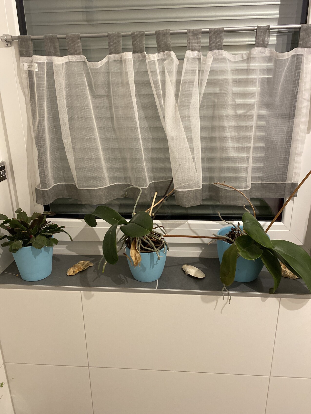

Our windows are centered within the wall. Actually, a nice depth.

haydee schrieb:
Our windows are set in the middle of the wall. Actually a nice depth.
How thick is your wall, and do you happen to have a photo of it for me? 🙂
haydee
8 Feb 2022 23:18
Not from the outside. This is how it looks on the inside.
45 or 50 cm (18 or 20 inches). I don’t remember exactly.
Drei blaue Pflanzentöpfe mit Grünpflanzen auf Fensterbank hinter weißen Vorhängen.
