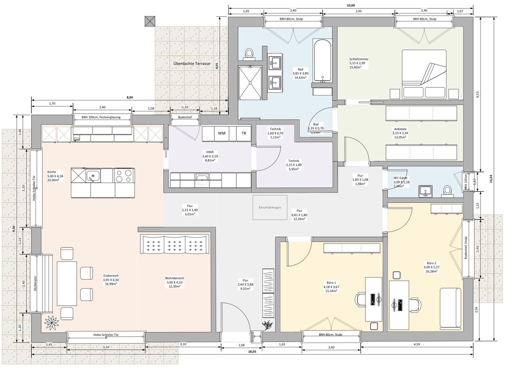

Hello 🙂
After what felt like hundreds of crumpled drafts in the recycle bin, we finally have a floor plan that we like and that fits our size requirements. Initially, we planned way too large, sometimes over 250m² (2700 sq ft) of living space... oops... Now we have settled on a nice 150m² (1600 sq ft) 🙂
We mainly reduced the number of rooms. Originally, we planned 2 offices and 2 future children’s rooms, but now only 2 offices remain, with at least one definitely convertible into a children’s room. This makes more sense since we don’t want to seriously consider having children before at least 5 years from now. We also initially planned a small wellness area with a sauna, loungers, and a hot tub inside the house, but this will now be a separate building in the garden.

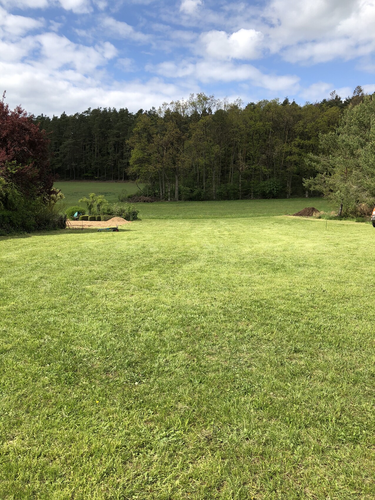

More generally, I have already written here https://www.hausbau-forum.de/threads/vereinigung-zweier-Grundstücke-baufenster-neu-legen.42280/ about our plots. The request for merging them is still in progress, so we don’t have a definitive location for the house yet. Ideally, we’d like it centered on the current boundary line or, alternatively, on the rear building plot with border development facing the neighboring property.

- A gallery in the roof, open to the living area, would be a big dream of mine, but only if financially feasible. Otherwise, this part of the roof will be storage space or intended for later expansion.

The open living area with the possibility to use both the south and north terraces.
Small “reading nook” at the end of the hallway with a large seat window (-> if there is a gallery, the staircase will lead upstairs here and the reading nook will be located there)

Maybe the hallway is too long...

Why did the design turn out this way? e.g.
Standard draft from planner?
Our design developed step by step from many sketches, floor plans, and photos found online.
The interior furnishing in the 3D images is only a placeholder; the detailed interior design is still being planned.
Finally, this design gives us a satisfied feeling in terms of size and room layout 🙂
In your opinion, is our project achievable for a maximum of €500,000 (approx. $540,000), and is it sensible to plan smaller first and then expand by adding a loft conversion?

Fortunately, having the house face north is not as bad as it seemed at first. Back then, my husband wanted all the windows facing north and absolutely none towards the street (south and east), and preferably not towards the developed neighboring property to the west either 🙄 From all the examples we’ve seen, I always get the impression that the entrance is located roughly on the opposite side of the corner. If I rotated such a floor plan to have the corner facing south, the entrance would be away from the street… and none of the ready-made floor plans really convinced us.
The building plot itself isn’t really a problem; we can position the house as we want as long as we keep sufficient distance from the neighboring property. If building over the boundary is not allowed, either the front or rear of the house will be built directly along the boundary to be as centered as possible. We definitely want to orient our “nice” garden to the north towards the forest. The northern boundary can also be clearly seen in the photo; the middle boundary is approximately at the tree on the left with the dark leaves.

It is also important to us that the two offices do not share a common wall, as I want to concentrate quietly on my work without hearing my husband (sales, talks a lot on the phone, and very loudly) through the wall. Most floor plans place the children’s rooms, which will be our offices, next to each other. My husband also needs a door leading outside from his office.
Including a fixed staircase in the plan is definitely a good idea, and I will do that.
