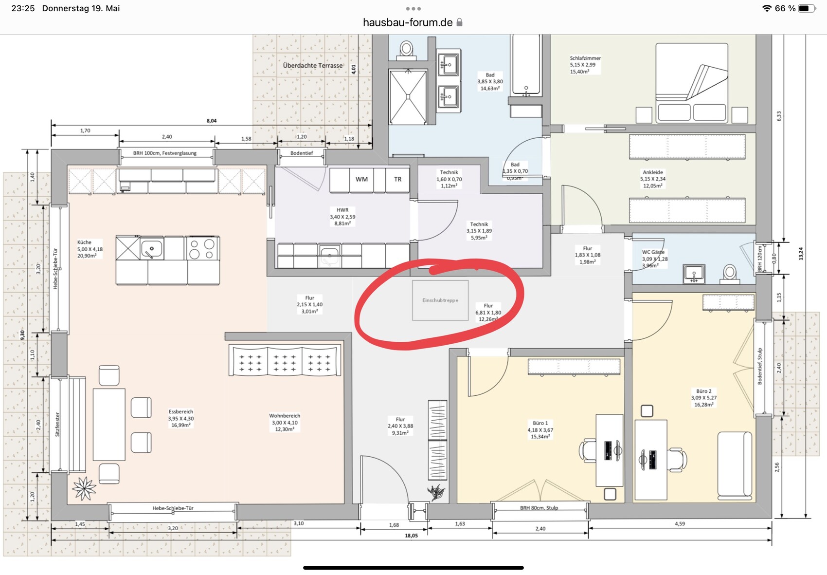

Ramona13Hello 🙂
After what felt like hundreds of crumpled drafts in the recycle bin, we finally have a floor plan that we like and that fits our size requirements. Initially, we planned way too large, sometimes over 250m² (2700 sq ft) of living space... oops... Now we have settled on a nice 150m² (1600 sq ft) 🙂
We mainly reduced the number of rooms. Originally, we planned 2 offices and 2 future children’s rooms, but now only 2 offices remain, with at least one definitely convertible into a children’s room. This makes more sense since we don’t want to seriously consider having children before at least 5 years from now. We also initially planned a small wellness area with a sauna, loungers, and a hot tub inside the house, but this will now be a separate building in the garden.

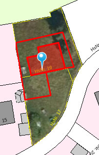

Fortunately, regarding the development plan/planning restrictions, we will have quite a bit of flexibility. We can submit a preliminary building inquiry to check if everything is acceptable. The last house built here in the village about 4 years ago had 2 full floors, a different roof pitch, and presumably got some exceptions approved without problems. The community is generally happy that we want to fill a building gap 😉
Plot size: approx. 1500m² (0.37 acres)

Designer:
- Do-it-Yourself
The open living area with the possibility to use both the south and north terraces.
Small “reading nook” at the end of the hallway with a large seat window (-> if there is a gallery, the staircase will lead upstairs here and the reading nook will be located there)
What don’t you like? Why?

Why did the design turn out this way? e.g.
Standard draft from planner?
Our design developed step by step from many sketches, floor plans, and photos found online.
The interior furnishing in the 3D images is only a placeholder; the detailed interior design is still being planned.
Finally, this design gives us a satisfied feeling in terms of size and room layout 🙂
In your opinion, is our project achievable for a maximum of €500,000 (approx. $540,000), and is it sensible to plan smaller first and then expand by adding a loft conversion?
I am very grateful for your opinions, ideas, and suggestions for improvement! 🙂

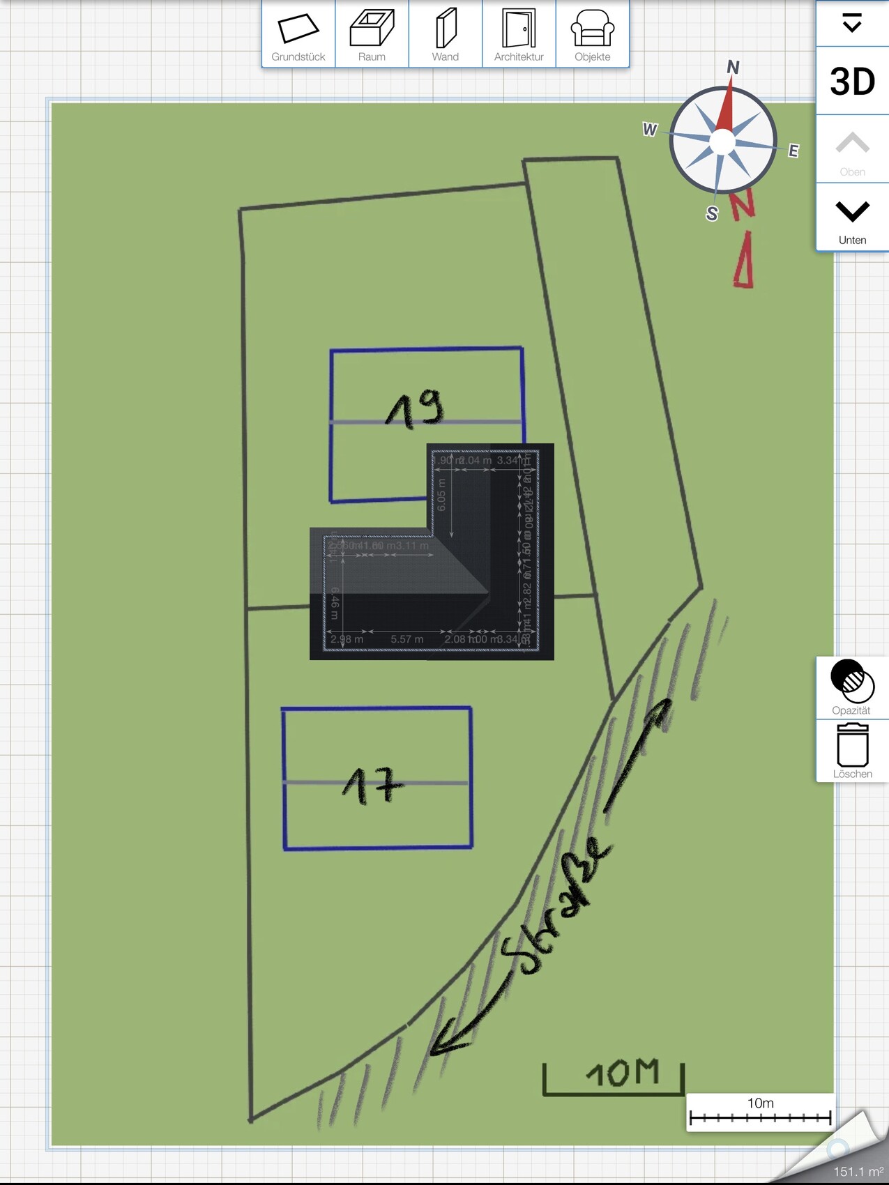

I’m going to be straightforward as always. How bad must the others have looked, crumpled like that? 😳
The hallway size of 28 sqm (300 sq ft), but especially the dimension/layout running the full length of the house, in my opinion, needs no further discussion.
Out of approximately 155 sqm (1,668 sq ft), 115 sqm (1,237 sq ft) remain (excluding hallway/utility room).
1. Plan the floor plan with/on the plot first.
2. Always provide the floor plan with complete dimensions, including all openings and fixtures. (A simple 2D drawing, like in image 1, is sufficient.)
3. Please start from the beginning...
(Entrance narrow, cloakroom?, internal WC, utility/technical room gets a sunny spot…)

I have no problem with a direct answer 😀
The designs were all quite different; I think each had strengths in some areas and weaknesses in others.
I’m also not very fond of the long hallway. We had planned to place the outdoor sauna in the garden behind the house and then use the door at the end of the hallway as access to it.
The utility/technical room is intentionally located on that side because that’s where the street is. The rough layout looks like this:
The niche next to the utility/technical room is planned as a cloakroom 🙂
What would you do differently regarding the overall house length or dimensions? I actually find the room sizes quite good 😉

Dingeling5 Feb 2022 08:35Why did you orient the angle to the north without a proper access? The house orientation and the layout of individual rooms don’t make much sense to me.
The office/possibly future children's room, which is surrounded by the living room, kitchen, hallway, and possibly a north-facing terrace, is probably the noisiest spot in the house.
A redesign would probably be the best idea.

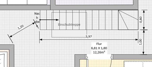

New plan. If you possibly add 2 more rooms, I would include a staircase to the attic.
If you remain a couple, you’ll have a nice bungalow for two; if you have more people, you’ll have storage space and potential for expansion.
Why is the bungalow so complicated? There are so many in catalogs that meet your requirements.
