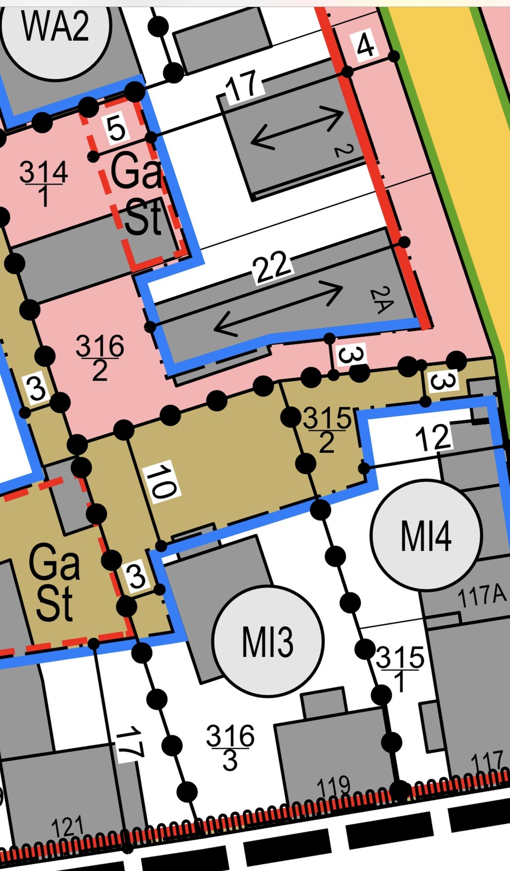

I have to admit, I find the floor plan and site layout surprisingly unimaginative and subpar for an architect. What exactly was discussed over six rounds to arrive at this result?
What bothers me most is the entrance opposite the garage, the access to the living room through the kitchen with the angled wall, the dark kitchen, and the pointless kink in the children’s room.
I would be interested in the precisely dimensioned site plan and the zoning regulations text regarding the building line as well as the maximum size of the building envelope.
An entrance from the sidewalk is not an option for us. Currently, there are two buildings on the property, which will be removed. The building at the back is a very, very old laundry facility. The residential building is at the front. The local authority prefers to keep the current appearance for now. Therefore, the new construction should be at the front. Yes, we could try to position the house in the middle, create and submit a new floor plan. But if that fails, we would have to submit a new application. During that time, interest rates would continue to rise, and eventually, the limit would be reached. So, I am being realistic, and the current interest rate situation does not allow it for us at the moment.
I don’t need courage; for us, it is perfectly fine to have the house facing the street. Someday, we dream of having a pool at the back in the garden. That is more important to me than a front garden.
That’s not what I meant at all. Is the building line still being respected if, for example, you place an "extension" at the front on the line and then connect the house to it?
So far, it seems like you haven’t really looked into your development plan, and your architect isn't very interested either.
Actually, the statements from @Steffi33 are quite reasonable and constructive in an encouraging way. She also added a picture of her own specific example here, which clearly illustrates this aspect: what kind of inviting, welcoming entrance area can be created if the building authority is convinced by this scenario—complying with the building line by extending the garage frontage and letting the main residential wing recess elegantly behind. What was proposed here at an ordinary level of quality is something many others cannot achieve even with a luxury villa (and here, only @Georgian2019 is somewhat comparable). Conceptually, like @Steffi33, you would need a property of about Brandenburg-like depth, which you do have in your case. So if not you, who else should be encouraged to take the step with a preliminary building inquiry to push towards "making our village more attractive"?
There is no need to discuss these statements further here. Constructive is definitely something else…
Considering this built environment, I am surprised there even is a development plan / zoning plan—or did you mean a “change freeze” preventing the establishment of such a plan? Is there a medium-term plan to protect the settlement’s character as a conservation area? By “change freeze” I actually mean a genuine change freeze. But it will only last until next year. It is still possible to submit applications, but anything that deviates from the previous state is difficult.
