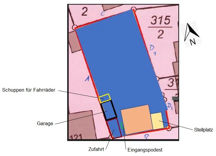

s_mhofma schrieb:
Okay, we just took a look at the development plan. You’re right, the garage has to be set back 5 meters (16 feet). That’s why it’s important to get familiar with the topic yourself!
I also did some work myself.
Thank you very much for all the messages!

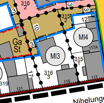

I was browsing the portal. Attached are the dimensions.
The building boundary is marked in blue in the other image. The development plan is called CITY OF LORSCH DEVELOPMENT PLAN NO. 63 "BETWEEN SIEGFRIED AND HEINRICH STREET". You will probably be able to help me more than the architect.
A roof pitch of 30 degrees is not mandatory; originally, it was 25 degrees. However, we wanted a slightly larger attic, so we went with 30 degrees.
