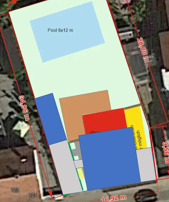

s_mhofma schrieb:
Do you already see that the current floor plan violates the development plan?
Tell me the post number of the latest version, and I’ll gladly share my thoughts. As you can see from my quotes, there is no need to do full quote replies here. I have since studied the development plan and its extensive explanatory report and can partially reassure you — when viewed as a whole, the plan is clearer and often less dramatic than the thumbnail excerpts many questioners post here, cropped tightly around their property boundaries.
My initial suspicion that the areas serve as easements for utilities was not confirmed. The light brown areas beyond the blue lines are said to have a vaguely defined garden-belt character, so your pool might still have a chance — but don’t confuse procedural freedom with a blank check. The special areas Ga/Cp on your left neighbor’s property prove, from a broader view and reading of the plan documents, to be zones allowing your neighbor to place covered or enclosed parking spaces between the building envelopes for their house and a duplex on the rear of their lot. This does not very likely mean they intend to put a garage right up against your fence. Regarding Katja’s question about the dormer, the plan’s explanatory report on page 46 under section 6.1.3 is vague: setbacks and projections up to 1.5 meters (5 feet) deep over a maximum of one-third of the house’s side length are permitted, with the explicit exception of the building line along Nibelungenstraße.
For any legally significant poor performance by your architect, although I have little regard for him beyond the spacing issue, you will probably need to have the stamina for two or three legal stages (and a competent expert). From what I have read in the subsequent posts so far, your only option is to be more assertive going forward — practice in front of a mirror that you are not a subject but a client.

Thank you very much for the feedback.
I’ll discuss with the others whether we should make the house a bit narrower and decide where the two parking spaces will go. Also, a window in the kitchen to avoid it feeling like a “black hole.”

hanghaus2023
27 Feb 2023 09:40
I haven’t read everything yet, but 10 m (33 feet) width should work.
Site plan of a property with an 8x12 m pool, buildings in blue, red, yellow.
Where can I find the current floor plans?
s_mhofma
27 Feb 2023 09:52
In the first post. The length at the bottom is a little over 17 meters (56 feet).
hanghaus2023
27 Feb 2023 10:01
s_mhofma schrieb:
In the first post. The length at the bottom is slightly more than 17 meters (56 feet).
I thought it was 16.92m (55.5 feet)
Have you still not taken all the comments into account and incorporated them into the design?
When the orientation is street-aligned, the front view shows its face. That’s not exactly an architectural masterpiece.
