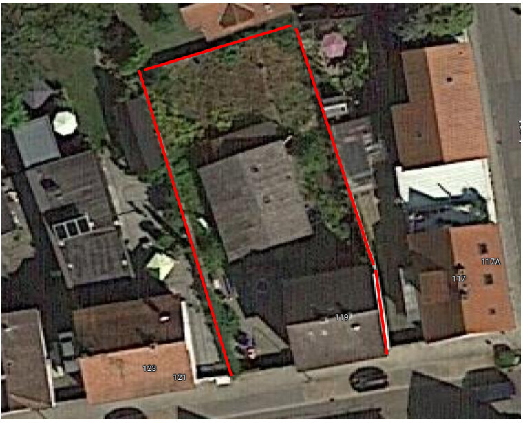

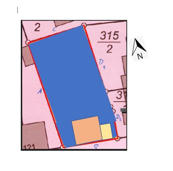

Why is the garage located exactly on the opposite side of the entrance door? I don’t find the lower side of the house plan very attractive or welcoming. Could you share the site plan so we can take a closer look? The lower side faces directly onto the street, so in my opinion, we are somewhat limited here. The garage is on the right side because there isn’t much space on either side. The entrance is on one side, and the garage is on the other. There is no other way to arrange it.
hanghaus202325 Feb 2023 09:55Please show an aerial photo of the surrounding area. Is the north arrow correct? Survey plans are usually oriented to true north.
hanghaus2023 schrieb:
Could you please share an aerial photo of the area? Is the north arrow correct? Survey plans are usually oriented to true north.Attached is an aerial image from Google Maps. I believe the north arrow in the property plan wasn’t entirely accurate. Currently, there are two older buildings on the site, which will be demolished. The plot has a slight bend on the right side.Similar topics
