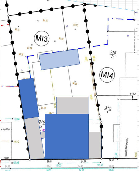

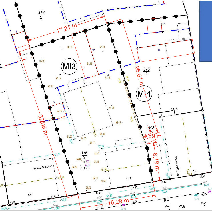

hanghaus202327 Feb 2023 20:39I have roughly measured the plan. There are two reference points (building boundary to the north and building boundary to the west). At the street, I come closer to 16.5 m (54 feet). More precise measurements are only possible using the geoportal.
In my opinion, this works with a 10 m (33 feet) wide house.
This is exactly the problem here; for 22 pages we have been asking for a precise site plan.
And when it comes to the plot width, it is crucial whether it is, as the original poster (OP) mentioned briefly in between, over 17 meters (56 feet) wide, or, as initially stated, just over 16 meters (52.5 feet).
I have also mentioned several times that I do not have the current survey measurements. In fact, my 17 meters (56 feet) come from the building authority’s archive, so they are from a very long time ago. I think we all agree that a recent survey would provide more clarity here. But at first glance, it seems to work with 16.5 meters (54 feet).
hanghaus2023 schrieb:
I have measured the plan so far. There are two reference points (building boundary to the north and building boundary to the west). On the street side, I get closer to 16.5 m (54 feet). More precise measurements are only possible with the geoportal.
Many thanks for your efforts!Since I wasn’t satisfied with the 10m (33 ft) house width—it loses even more sun and light due to the garage being set back—I revisited the plan. Especially since I also find garages with an external dimension of 3m (10 ft) quite tight.
If I measure again on the plan from post 131
and take the dimensions you quoted,
At the top there are about 18.3 meters (60 ft). On the lower right up to the bend approximately 10.5 meters (34 ft), and then to the border on the right another 25 meters (82 ft).using the two 3m (10 ft) sections, the 10m (33 ft) section, and the 12m (39 ft) section shown in the plan, I only reach the values you mentioned for the 25m (82 ft) section; otherwise, I measure even shorter distances than @hanghaus2023.
