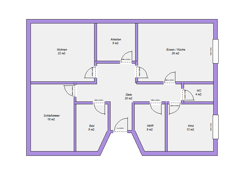

kaho67416 Aug 2013 11:57
If the kitchen is on the north side and the living room is on the south, then you simply separate the two areas. Here is a sketch (!!!):
You can set up a cozy kitchen-living area with a large dining space. From there, you can go out to the terrace at the back. However, you will probably end up spending most of your time in the kitchen because it feels more comfortable, I think.
2D floor plan with rooms: living, sleeping, dining/kitchen, bathroom, hallway
