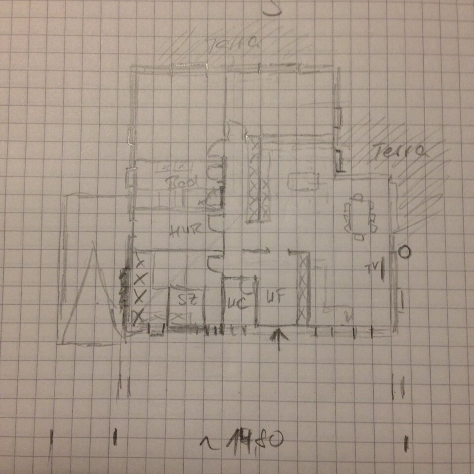

You mentioned that the hallway and the corner windows, which I also wouldn’t divide into thirds by the way, are important to you. You also like open-plan living.
I sketched something out... right from the start, I noticed that your carport is positioned on the west side. That’s unfortunate for enjoying the afternoon sun. I’ve placed the carport on the east side instead and included plenty of storage space for coats and household clutter in built-in cabinets. This also opens up the hallway a bit and makes it more functional. The utility room is easily accessible from the kitchen (which has many tall cabinets) and suitable for laundry between the bedrooms. Both hobby rooms face south, and the bathroom could be designed to include a discreet external entrance.
The bedroom and child’s room don’t interfere with each other.
The living room is also zoned: you can be on your own, but still in the middle of things.
The roof would need to be adjusted.
I forgot the stove [emoji20], but it could be placed to the left of the TV.
The TV can be slightly angled so you can enjoy entertainment while cooking. If you have one over 50 inches, you’ll have a perfect view. We recently had a 32-inch TV and it worked perfectly fine at roughly the same distance.
I would deliberately avoid fitting doors in the hallways unless you have noise issues.
Edit: I’m only seeing your last post now [emoji848]
But more or less it fits — as you know, it’s best not to get hung up on 2 square meters or small details if the rest is optimal [emoji6]
Edit 2: It got a bit large, I would leave out one meter (3 feet 3 inches) on the left side of the plan, then it will fit.

Thanks in advance for your sketch 😉
What I don’t quite understand is whether there is an additional wall at the entrance hall and corridor, or if it’s supposed to be completely open?
Negatives for me are:
- Utility room is not facing the street
- Garage is on the side where I’m still unsure if the neighbor would agree to something taller than 3 meters (10 feet)
- Terrace is very close to the neighbor (3m (10 feet) right next to the house); with the garage on the side, there is a bit more space, which I find more comfortable
- The view of the house from the garden is not as nice as before
Positives:
- Sofa setup is nicely solved, though not ideal. At this distance, I would definitely buy a 75-inch TV; however, turning the screen won’t work well. With my 55-inch, it’s already quite awkward.
- I also like the room layout
One thing I forgot to mention: we want tall ribbon windows on the front facade. This might make the lighting factor a bit tight in some areas...

You urgently need to prioritize now! You really can't have everything. Is it absolutely necessary to have direct access from the garage to the utility room? Or could you do without it? The walk to the front door is quite short anyway.
Is the garden view (believe me, you stop paying attention to that after about three weeks) so important to you that you’re willing to give up something inside for it?
What’s so bad about having your terrace close to the neighbor? The argument might be that their house blocks your light if it’s positioned unfavorably. Otherwise, that shouldn’t really be an issue.
Why does the garage need to be more than 3 meters (10 feet) away? Is it supposed to be integrated into the house roof?
Of course, you can also swap the utility room and the bedroom and then move the guest toilet to the right wall. But that would also shift the main entrance.
We also have a bungalow, but it’s 14 x 14.5 meters (46 x 48 feet). We initially wanted to access the utility room from the garage. But that was not possible space-wise without giving up something else. So we left it out. So far, we don’t miss it at all. With a bungalow, the distances are short anyway, so walking 2 meters (6.5 feet) more won’t hurt.
Regarding the kitchen TV: Install a connection in the kitchen and hang a small TV there. Then you can comfortably watch a program independently of the main TV in the living room.
