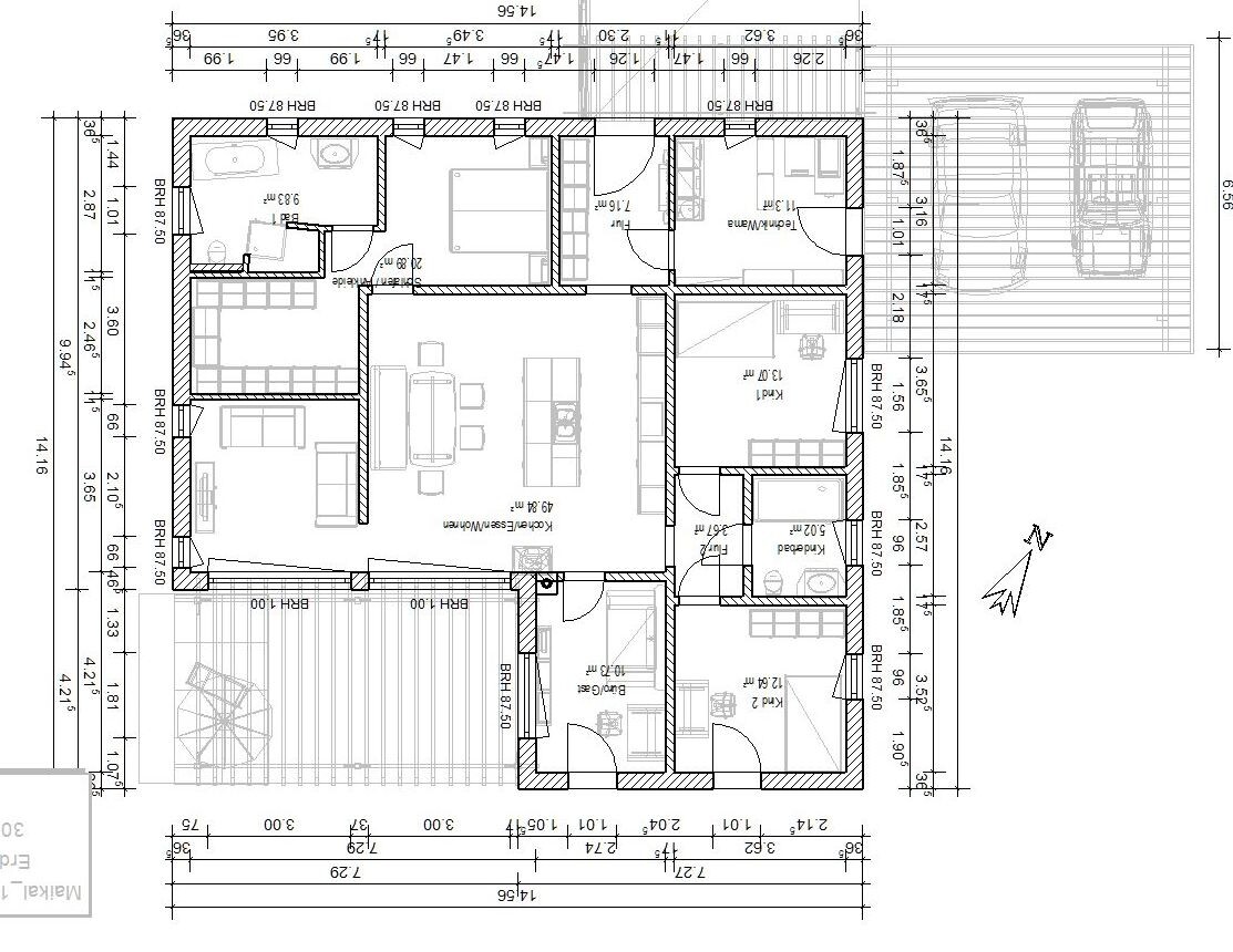

This is a partition wall between the bedroom and the bathroom to ensure privacy.
The bedroom has a short route to the bathroom. The bedroom could, of course, also be used as a hobby room or later as a child’s room. Likewise, the desired clerestory windows can be planned on the front; mine is just a suggestion. There are also options for windows on the side.
There are regulations for garages built on the property line.
Why does the utility room have to be at the front now? Potentially, the garage and windows need to be matched... I’ve actually decided on a carport now. Well then.
If it doesn’t fit, it doesn’t fit, but at least you might get an idea of how to plan with a proper living room.
You should also consider whether you really want large windows facing south and west. When the sun shines, it can get hot there very quickly, even in winter. Almost everyone dreams of lots of light but doesn’t always consider that you will often need to operate the blinds when a central area in the house receives intense sunlight.
Evo89 schrieb:
5. Separate private area from the living room (for example: girlfriend goes to shower while my friends are over, so she can also walk out of the bathroom in a bathrobe...)
6. Shower in the guest toilet, for the child later...What you allow your girlfriend in point 5, you don’t extend to your child. The child should just march past and use their bathroom 😉.I once designed a bungalow inspired by the "Swedish model." I’ve now just rotated it to fit your orientation. If you were to leave out the window on the west side in the master bath, you could also position the garage there. I also think that the access through the utility room is not necessarily needed, and it actually takes up valuable space both in the utility room and in the garage. You should keep in mind that there is often a step there, and that you will want to store bicycles and such somewhere in the garage.

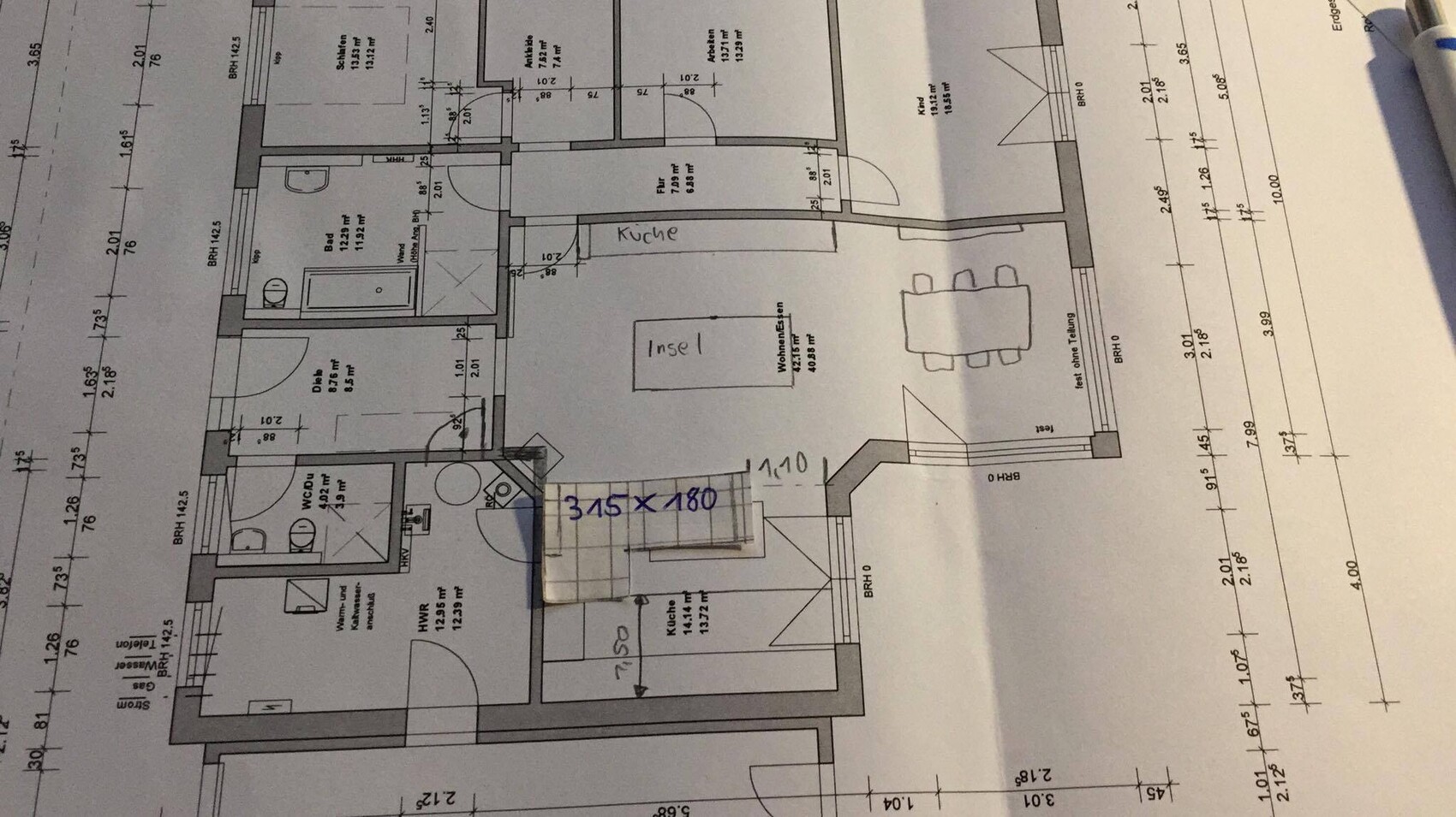

Good evening, I didn’t want to redesign the entire layout, just to improve the living room situation.
The attic is intended to store things like boxes, decorations, etc. (items that are usually kept in the basement).
The fold-down attic ladder (planned to be 1m wide (3 ft 3 in)) was originally intended to be placed in the hallway area (relatively far from the kids’ bedrooms).
I did some sketching again. I swapped the sofa with the kitchen area and moved the door from the utility room to the kitchen into the hallway. We would only need to find a new position for the fireplace. Possibly, I would also adjust the sliding door so that there is a straight passageway (so you don’t immediately walk into the kitchen island).
What do you think?

Well, it’s slightly better, but I still find the guest bathroom and the adjacent rooms for child/work very inconvenient. The sofa somehow doesn’t create any sense of coziness at all... you always have the entrance and the kitchen area right behind your back.
By moving the utility room door, the space for shoes/wardrobe becomes even smaller, but the little space still has a good 8 sqm (86 sq ft).
So far, I haven’t identified a fireplace in the plans; at least, none were shown in the layouts. I also can’t see where a fireplace would make sense here. In my Swedish bungalow sketch, there was a suitable spot for one.
Why not fill the outer shell with different content? Making small adjustments here and there usually makes the spaces less functional.

Evo89 schrieb:
Good evening, I didn’t want to redesign the entire layout, just improve the living room arrangement.
Actually, you don’t really have a living room, so it’s difficult to change just one aspect of the design without affecting other parts.
Your last post clearly shows that a sofa alone doesn’t make a living room. By the way, sitting 1.50 meters (5 feet) in front of a TV is definitely too close.
