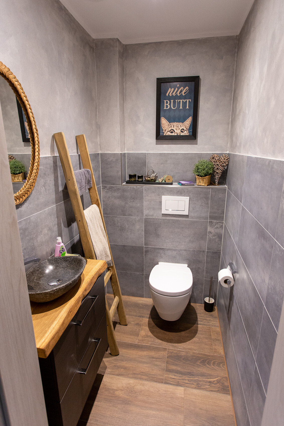

xMisterDx11 Dec 2022 15:41In my opinion, it would be better to make it wider and therefore shorter. We have 1.25x1.40m (4.1x4.6 ft), with the toilet along the shorter side. With a reasonably sized sink, 1 meter (3.3 ft) in width would be too tight for me...
Especially since, as the electrician nicely put it to me: "You have three women at home, so this will be your bathroom..."
