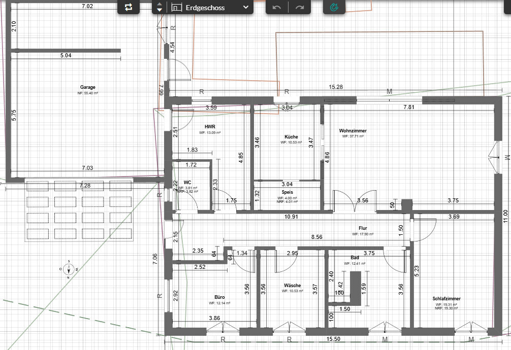

The floor plan was entirely designed by me. Unfortunately, the construction company does not have a qualified architect, so I would like to have it reviewed here:

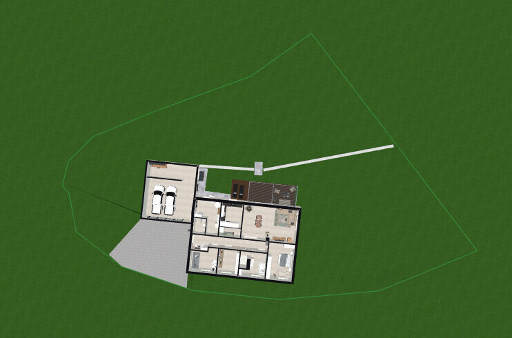

Building window, building line, and boundary cannot be met, otherwise the plot is not developable. Then there will be no building permit / planning permission. Could you please show the building window / building line / building boundary – whichever applies? And by the way: are complete details, punctuation, or explanations possible but just not provided?

What don’t you like? Why? Huge corridor. Then it clearly needs to go—the corridor is almost 11 meters (36 ft) long. How does something like that even come about? By lining up rooms, right? So if you don’t like the design (the corridor is indeed very dominant and cannot be overlooked), what exactly do you want from the forum?
BILA1979 schrieb:
Therefore, opposite a guest WC with shower for a possible caregiver. A guest WC cannot realistically fit a shower, toilet, and a sufficiently large washbasin all together.
BILA1979 schrieb:
Already being prepared for accessibility. That is not the case either. The toilet and shower in the bathroom are not accessible. Also, this is a house with long distances and no space for necessary turning or maneuvering areas where they should be. Not even a wardrobe in the niche is possible.

Attached is an excerpt from the development plan. Instead of the usual line being drawn along the street, it was drawn across both plots. As a result, the right plot is only 50% buildable. This puts me at a disadvantage, so I am hoping for approval despite not complying with the building line. The representation of the two houses along the dashed proposed plot boundary is also interesting. The actual boundary is the solid line. I own both plots, by the way. And yes, an objection should have been filed, but unfortunately no one in my family did. Therefore, I would need to stay about 8-12 m (26-39 feet) back from the street and build a retaining wall of about 5 m (16 feet). If the building permit is denied, I would not build but would seek an amendment to the development plan, which would certainly take a lot of time.

Attached is an excerpt from the development plan. Instead of the usual line drawn along the street, a line runs across both properties. As a result, the right property can only be built on by 50%. This puts me at a disadvantage, so I am hoping for approval despite not complying with the building line. The depiction of the two houses along the dashed proposed property boundary is also interesting. The actual boundary is the continuous line. I own both properties, just to clarify. And yes, a formal objection should have been filed, but unfortunately no one in my family did so. Therefore, I would have to stay about 8–12 m (26–39 feet) away from the street and build a retaining wall about 5 m (16 feet) high. If the building application is rejected, I would not proceed with construction but would seek a change to the development plan, which would certainly take a lot of time. You are completely misunderstanding this. The building limit / building envelope (shown in blue in colored plans) is the dashed line surrounding the houses and garages. Since you own both parcels, the proposed new boundary does not concern you; however, you would need to have both parcels merged. Your assumption that you must leave the area of the eastern example house-garage group free or apply for a waiver to build on that part is entirely incorrect. There is no need for you to challenge the development plan at all.
