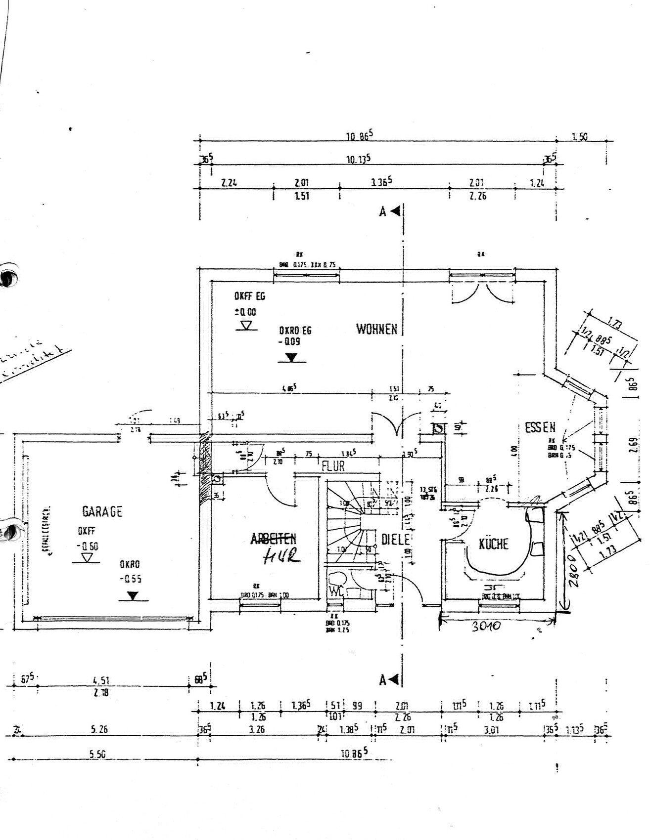

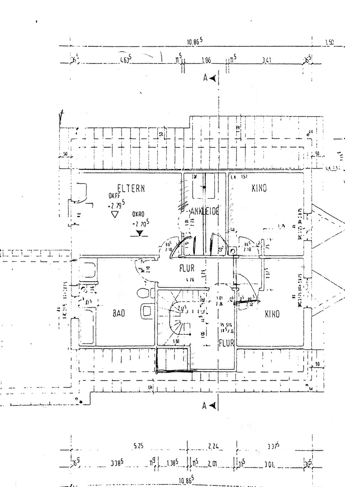

Then please show the original existing layout as a basis for comparison.Good idea. Attached is our current floor plan. 1.5 stories with a half-hipped roof.Differences compared to the floor plan:
- Kitchen is open and extended further in
- Staircase turns a quarter turn without the two obstructive walls between the ground floor and upper floor
- No dressing room on the upper floor
Otherwise, perhaps a clarification regarding the new build project.
We really like the upper floor as well as most of the ground floor.

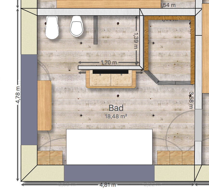

@Curly, thanks for the tip. We currently have it exactly like that, but finishing the kitchen furniture visually is more challenging, see picture no. 3. One quirky idea I had is to create a hidden access to the utility room there—basically through the cabinet door.

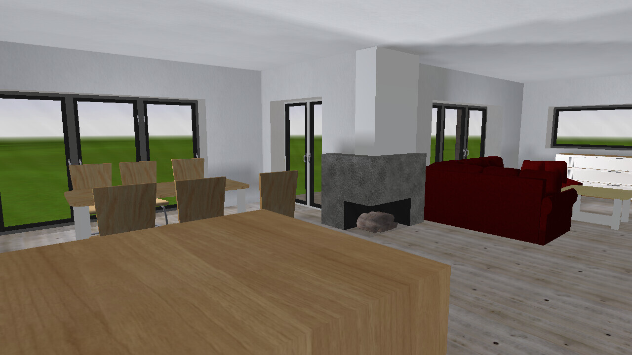

The ground floor now features a highlight fireplace at the central exterior corner. I can quite well imagine it as a visual focal point and a connector between the different areas. The chimney also runs more elegantly through the dressing room on the upper floor, so it doesn’t cause any disturbance.
