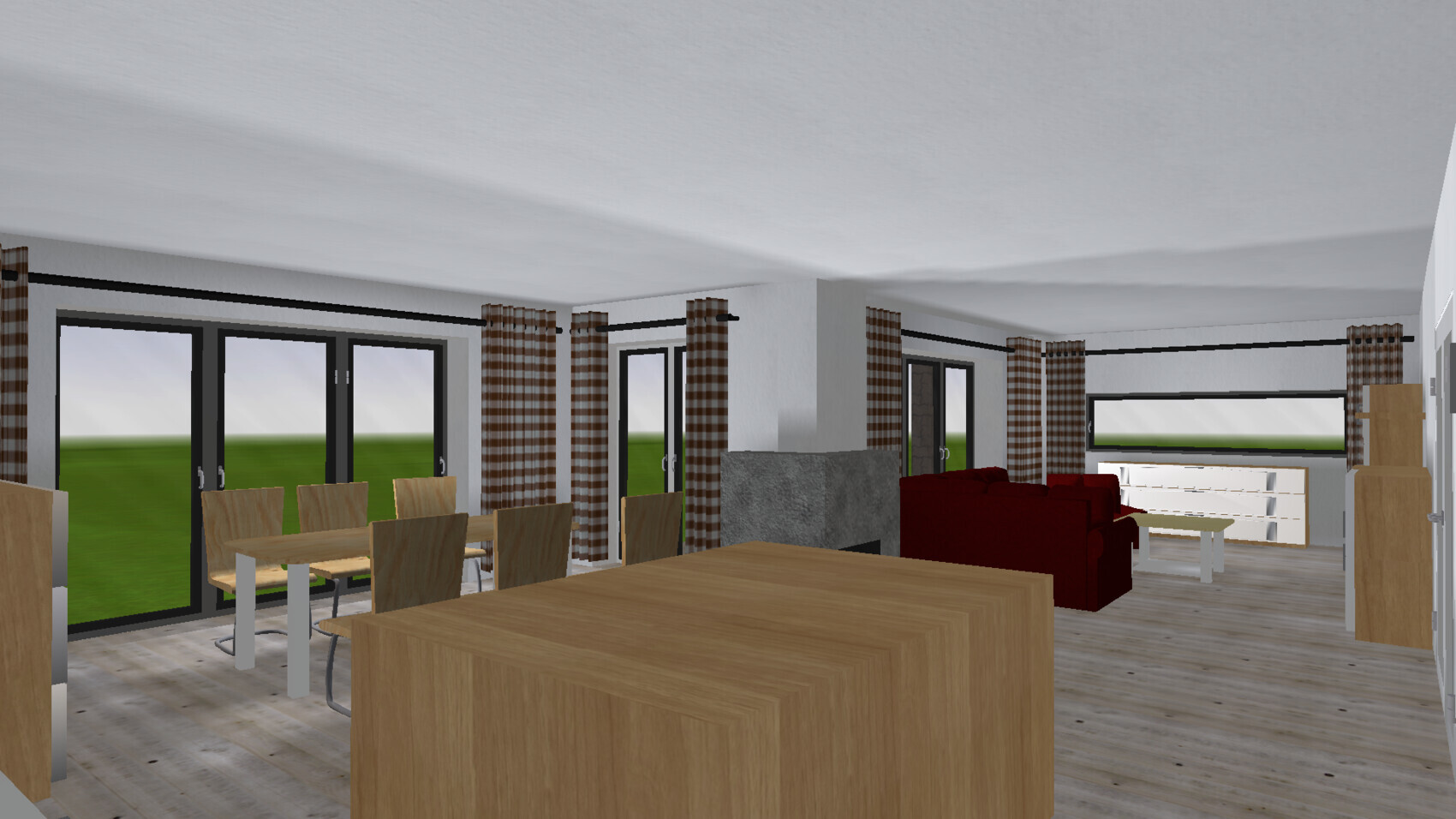

Thanks for the suggestion. We are facing the challenge of fitting all the furniture while still having a large window area. That’s why I planned the living room window as a 3m (10 feet) panoramic version above the sideboard. At first glance, that could work visually.

For me, that would be way too much window area. I also find it uncomfortable to sit on the sofa in front of a glass surface. Consider the hot summers and the shading.
Do you already know which fireplace you want? You should keep at least 1 meter (3.3 feet) distance from the firebox.
