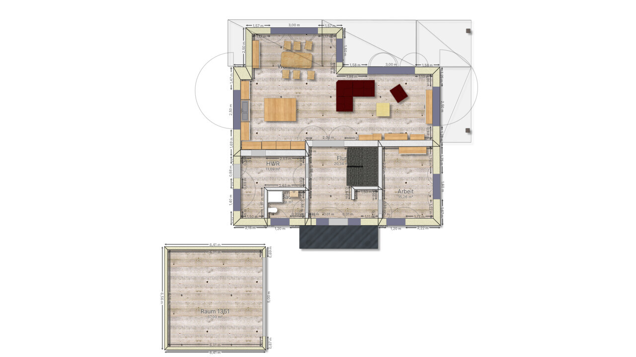

we have been living in our own single-family house for a long time and now want to build a new one. I did not expect it to be so difficult to design a suitable floor plan. Every change affects another requirement. We are now at an impasse and can’t think of any further improvements. I hope your fresh perspectives and honest feedback will help us here.
Thank you in advance for all comments.

Space requirements on ground floor (GF) and upper floor (UF) – see design

Open living-dining area, lots of light, no narrow spaces, harmonious proportions and symmetry, cozy
Smooth roof tiles

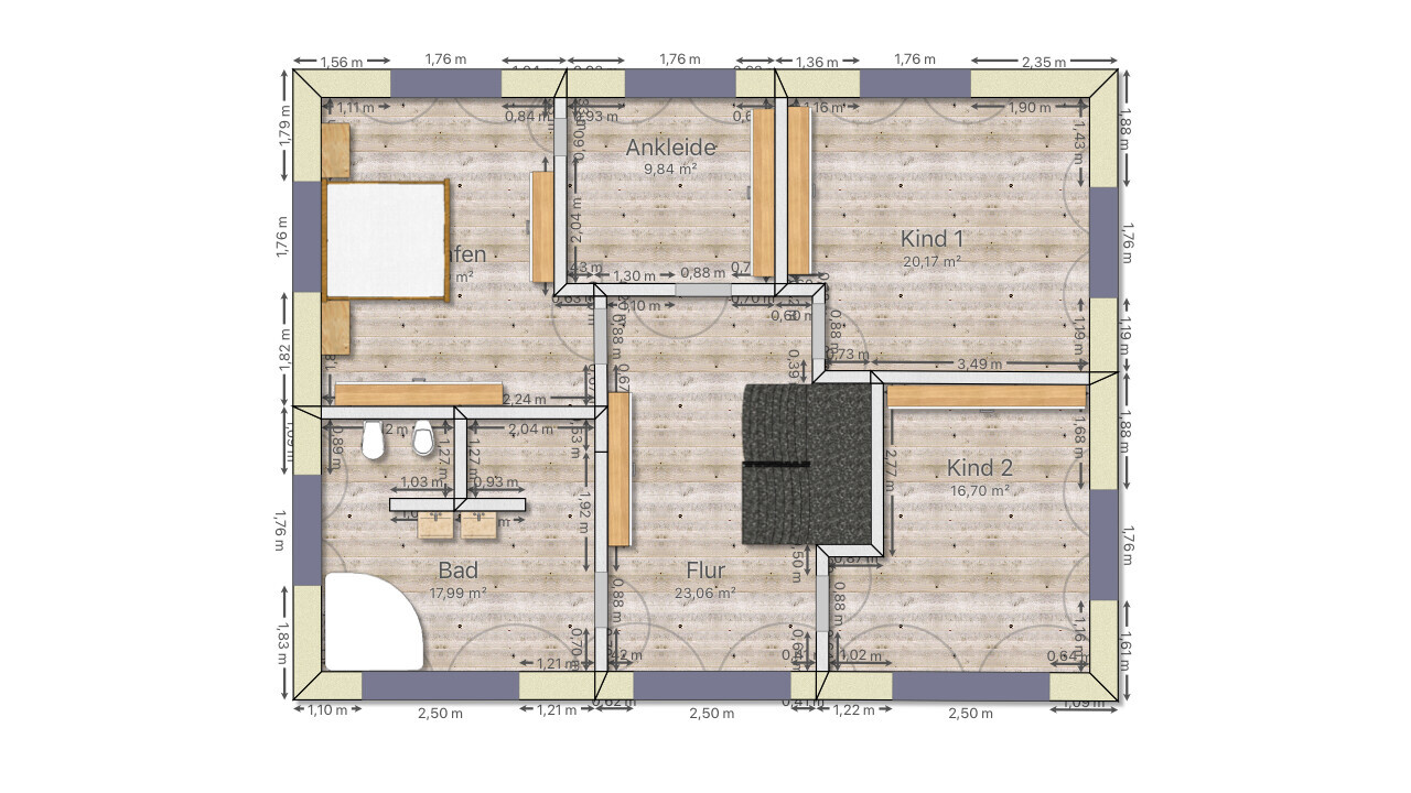

- Upper floor layout, stairwell
What do you not like? Why?
- Children’s rooms vary in size

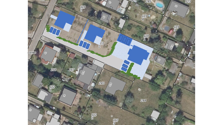

In the aerial photo, it is the lower house on the right.
The shaded area roughly represents the paved surface.
Driveway passes two L-shaped bungalows in grey.
Top view floor plan: living room with dining table and sofa, kitchen, hallway, office, utility room, room 13.51.
Floor plan of a house with master bedroom, child 1, child 2, dressing room, bathroom, hallway.
Aerial photo of a residential area with three blue buildings, parking lots, and plot boundaries.

Regarding the basic requirements (which also determine the layout of the hallway area)
Ground floor
- Living area larger than 65 sqm (currently this is the size we have), but still cozy (which I am concerned about here)
- Adaptation to existing furniture
- Kitchen large, open but visually integrated
- Dining area > 15 sqm
- Utility room > 15 sqm (not currently met)
- Spacious entrance area with an open recessed staircase
- Central entrance (not offset), symmetrical windows (hence the less-than-ideal position in the living and dining areas)
- Partly covered terrace facing south
Upper floor
- Large daylight hallway upstairs (we also have this currently)
- Children’s rooms equal in size and > 18 sqm (not met in the design)
- General symmetry of doors and walls
- Walk-in closet accessible from the bedroom
- Both children’s rooms facing the sun

I really like the two large corridors on the ground floor and the upper floor. In my opinion, a spacious entrance area gives anyone entering a good sense of space. I would skip the wardrobe in front of the study and try to find space in the utility room for shoes and jackets or place a stylish wardrobe in the hallway without a separate enclosure. Having the wardrobe in the utility room has the advantage that 1) it is really used several times a day, and 2) a nice wardrobe solution enhances the space instead of it being dominated just by the technical equipment.
The staircase in the hallway can then be repositioned and would not be cramped into a corner, if that is desired or if the architect comes up with an appealing solution.
I think having a double door entrance to the living room is very good and I will try to implement that in our house as well. The sightline could be arranged so that, immediately upon entering the hall, something attractive can be seen through the open double living room doors. A large picture, a big plant, or best of all, a view of the garden.
I would place the nook (?) of the dining area in the center to make it symmetrical and to allow for a nicer view from the entrance to the living room. This could also be a large table with beautiful decoration.
To me, the distance between the garage and the house seems too small. Either build the garage directly attached to the house or place it farther away.
Upstairs, you could enlarge the bedroom at the expense of the dressing room, and enlarge the dressing room at the expense of Child 1’s room, so the children’s rooms end up the same size. My view is that the 11-year-old child currently gets the larger room (if desired), and when the 11-year-old starts university in 6 years and is only home on weekends, the 7-year-old can have the larger room (if desired), by that time being 13 years old. Overall, though, I find both rooms adequately sized in the current plan.
Regarding the size, style, and arrangement of the windows and patio doors, they seem too varied and not symmetrical enough for my taste, but I believe that is currently modern and therefore acceptable. The windows also appear too small in the renderings—so much wall and comparatively few or small windows. Personally, I would avoid triple patio doors and instead opt for either double doors (more of them) or four-panel doors. But that is just my personal preference, which I know is not currently the majority taste.
However, I think your house as proposed is fine and you can certainly live in it very well and happily.

I find the entrance hall too large and lacking a proper coat closet. Nothing destroys the impression of spaciousness faster than a pile of bags and shoes. I would give up some symmetry if it makes living there more comfortable.
If the plan itself feels rough to you, start over. You already have a house; keep what works well and improve what bothers you. Then you can see how much symmetry you can incorporate. Plan from the inside out. Don’t forget the small, cherished details.
