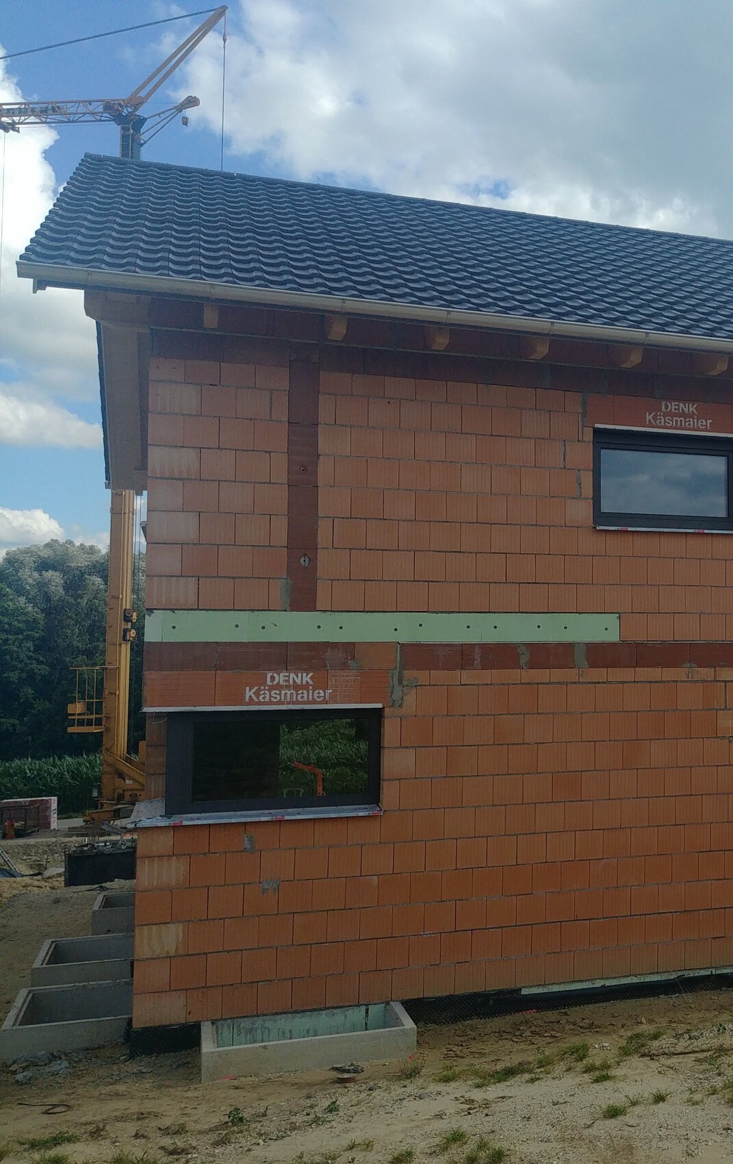

22 Jun 2018 18:59
No additional support beam is needed. However, a guide rail for the roller shutters must, of course, be installed.
The first construction photo shows our shell with a corner window without support/post, the other image is an example of how it will approximately look.
