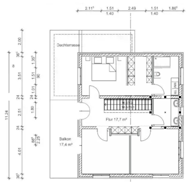

kbt09 schrieb:
Try placing the two partition walls on the upper floor as in your upper floor plan. In my opinion, the vertical walls don’t necessarily have to align directly above the ground floor walls.
The bathroom layout is more of a quick and rough draft.
Master bedroom about 370 to 380 cm (145 to 150 inches) at the head of the bed, dressing area around 210 to 215 cm (83 to 85 inches).
A built-in closet niche in the hallway would mean you don’t need so many cabinets in the bathroom.
We had originally planned it exactly like that. But as I said, the structural engineer said it isn’t feasible. There will be an attic added, so the loads need to be properly transferred through load-bearing walls. Still, thanks for the suggestion—it’s really good.
kbt09
17 May 2023 23:00
What loads? I really can hardly imagine that.
In your bedroom layout... is the bed really only 2m (6.5 ft) wide? With mattresses, always consider the bed frame as well.
So that leaves only about 280 to 290 cm (110 to 114 inches) minimum from your 313 cm (123 inches) wall to the walk-in closet. Very little space for a bedside table.
And you always have to pass right by the head of the person sleeping on that side to get into the closet.
Additionally... the children’s rooms have north and west and/or east-facing windows. They would actually be better located with south-facing windows.
Also, having a bathroom directly above another bathroom simplifies things quite a bit.
A bathroom with a toilet drain leading into a guest room is not the whole story... ideally, the toilet drain should connect with the toilet drain of the guest bathroom and discharge together into a common house drain. Ask your architect about this.

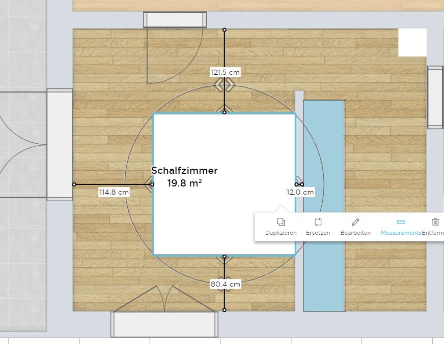

K a t j a17 May 2023 23:37
Stein2023 schrieb:
I’m not sure how wide your bed is... The room width is 4 meters (13 feet). The back wall at the head of the bed is 3.13 meters (10.3 feet). The bed itself is 2 meters (6.5 feet) wide:
The bedroom is exactly the same as this one:
What is the issue with this bedroom? Maybe there’s not enough space for a slightly wider bedside cabinet, or what is it? Please explain again.
As it is currently drawn, the person sleeping at the top of the plan has no bedside table. I couldn’t sleep or live like that. Glasses, alarm clock, lamp, book, and a bottle of water all need their place every evening.
You can argue about the centimeters among yourselves, but in my opinion, it will never be truly satisfactory.
