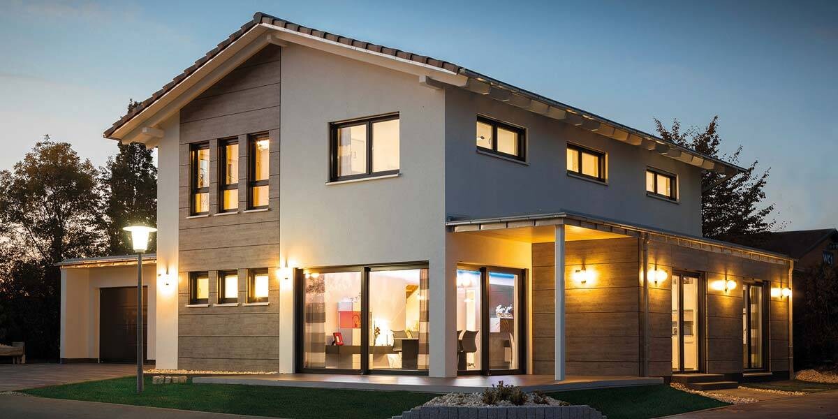

What do you think about a roof structure like this one here at the corner? It’s also a flat roof, but I find it very well designed. Around the corner and then covered by a maximum of 2m (6.5 ft) could still allow enough light.
What do you think? Or should we just give the bay window a pitched roof as @11ant suggested?
