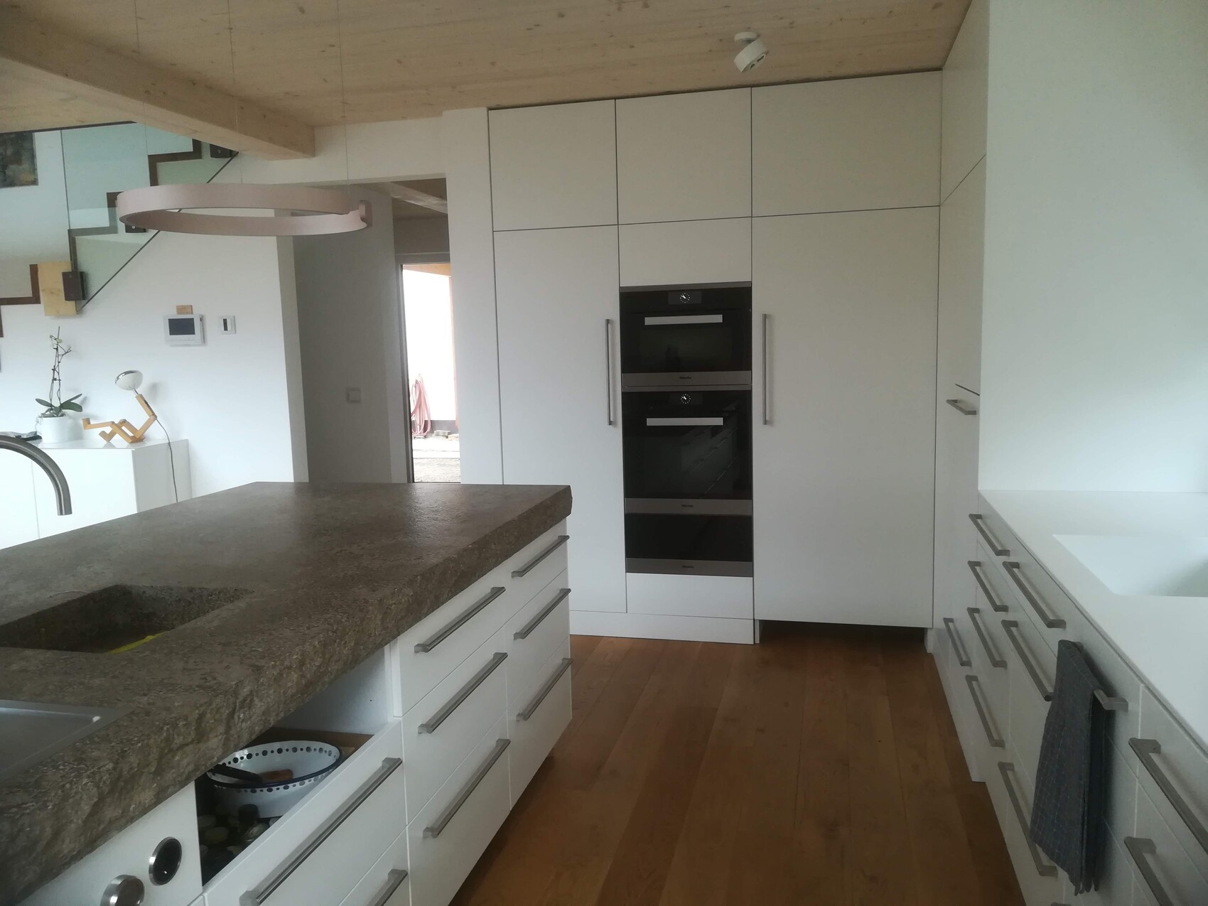

With a door that looks like a kitchen cabinet door, you don’t separate yourself from the kitchen. Integrate the pantry access into the already necessary tall kitchen cabinets.
Here’s how it looks for me:
(at this point the kitchen wasn’t quite finished yet – the baseboard is still missing below; please don’t mind that)
The pantry is here:
For us, it’s in the corner, but you can simply plan an additional tall cabinet, and that’s the entrance to the pantry.

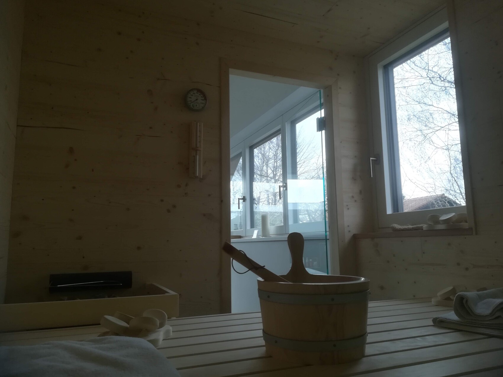

We even have a window in the sauna so you can look outside. I really wanted that. Here’s how it looks in winter:
Much nicer than a dark hole!!!

A door that looks like a kitchen cabinet door won’t separate your kitchen. Integrate the access to the pantry into the tall cabinets already needed in the kitchen.
For me, it looks like this:
[ATTACH alt="IMG_20191120_105017.jpg"]53613[/ATTACH]
(the kitchen wasn’t quite finished there – the toe kick is missing below; please don’t mind that)
The pantry is here:
[ATTACH alt="IMG_20191120_105033.jpg"]53614[/ATTACH]
Ours is in the corner, but you can simply plan one more “tall cabinet” and that’s where the pantry door would go.

We even have a window in the sauna so you can look outside. I really wanted that. This is how it looks in winter:
[ATTACH alt="IMG_20200306_170132.jpg"]53615[/ATTACH][ATTACH alt="IMG_20200306_170147.jpg"]53616[/ATTACH]
Much nicer than a dark hole, right!!! Great sauna!
I think it’s really nice.
And now I understand how your corner cabinet in the kitchen works.
The stone countertop in the kitchen looks fantastic too – but isn’t it a pain to maintain with such a rough stone?
