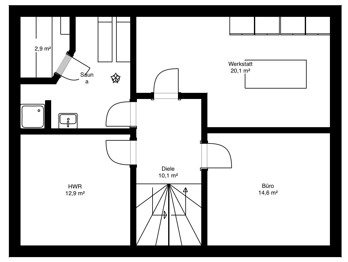

Guest WC on the ground floor, but without shower; this will be in the basement near the sauna later

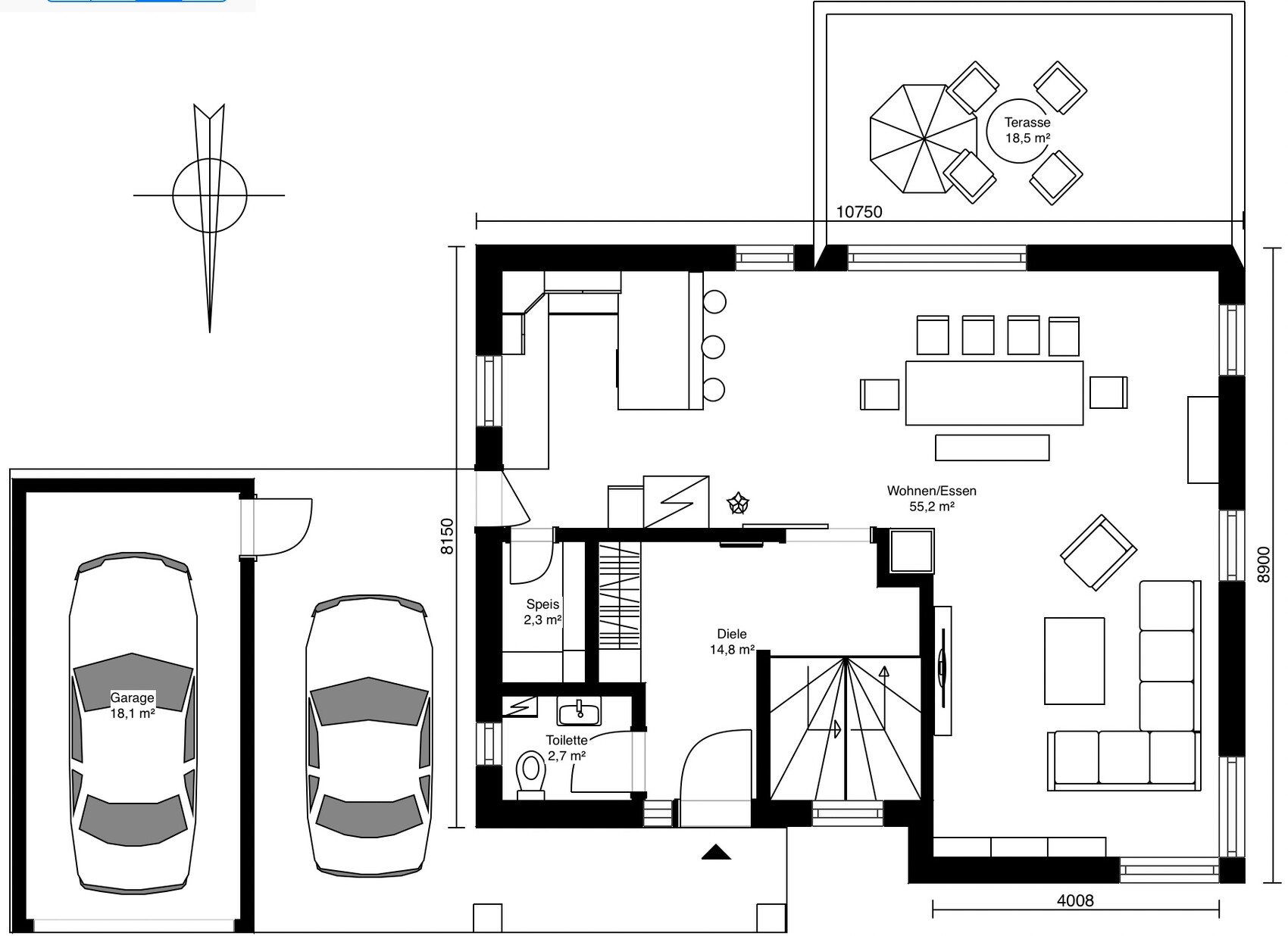

fireplace as room divider (between living and dining area) or built into the wall as shown in the plan
single prefabricated garage with covered walkway to the house = carport

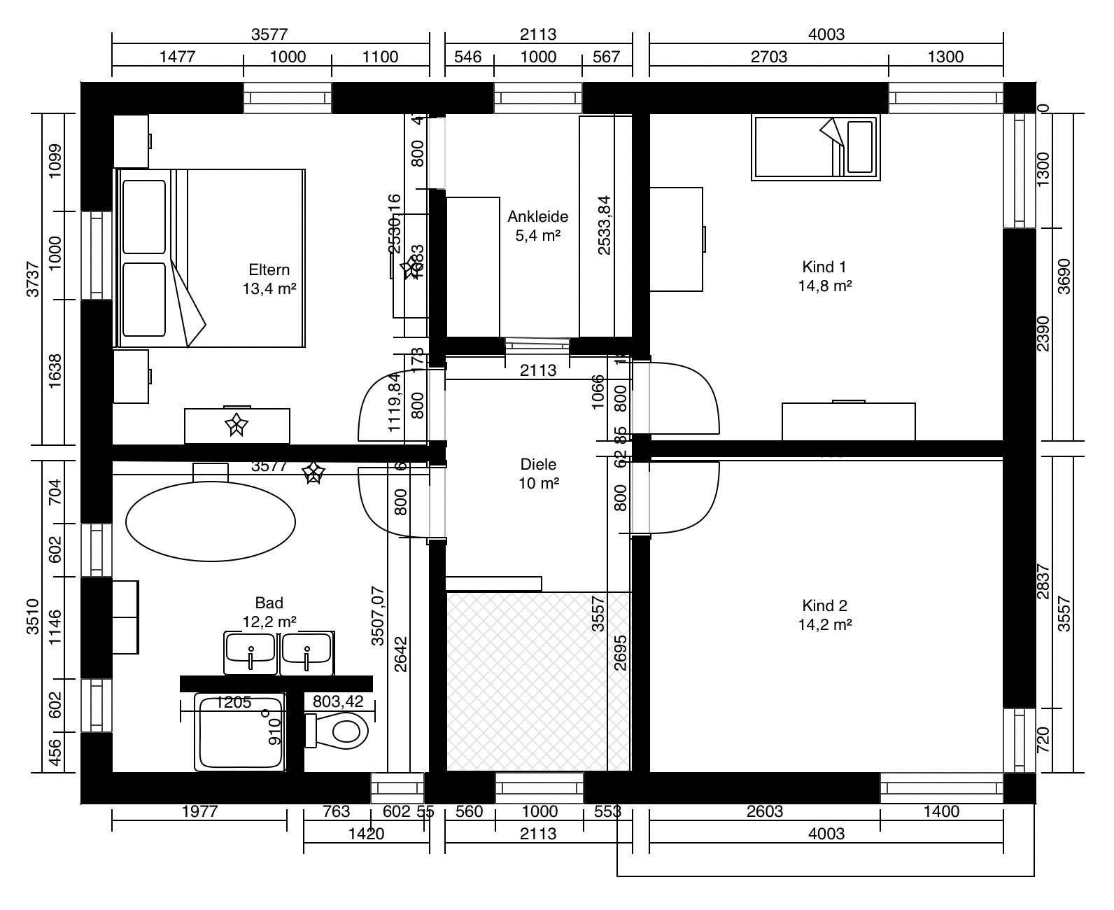

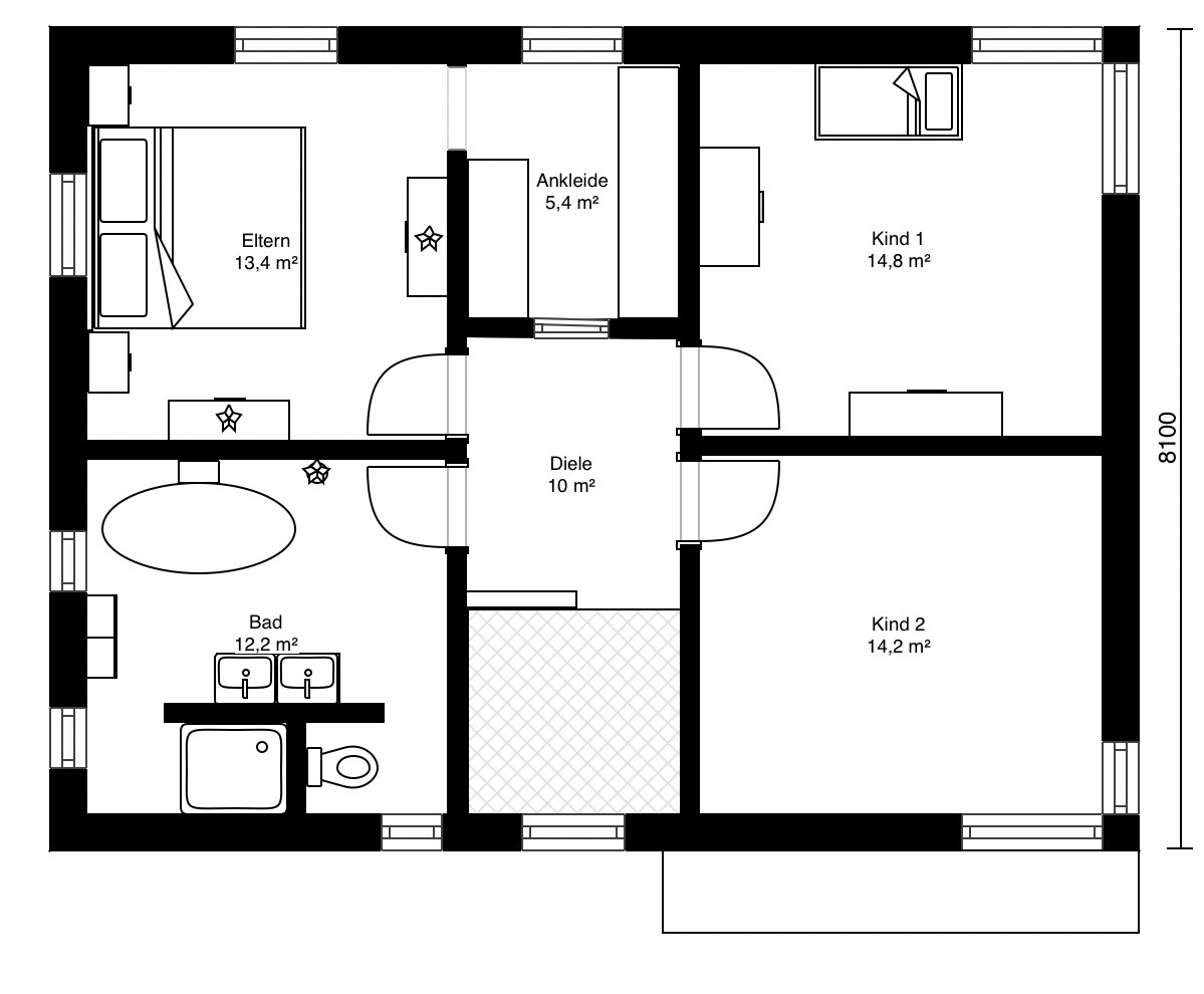

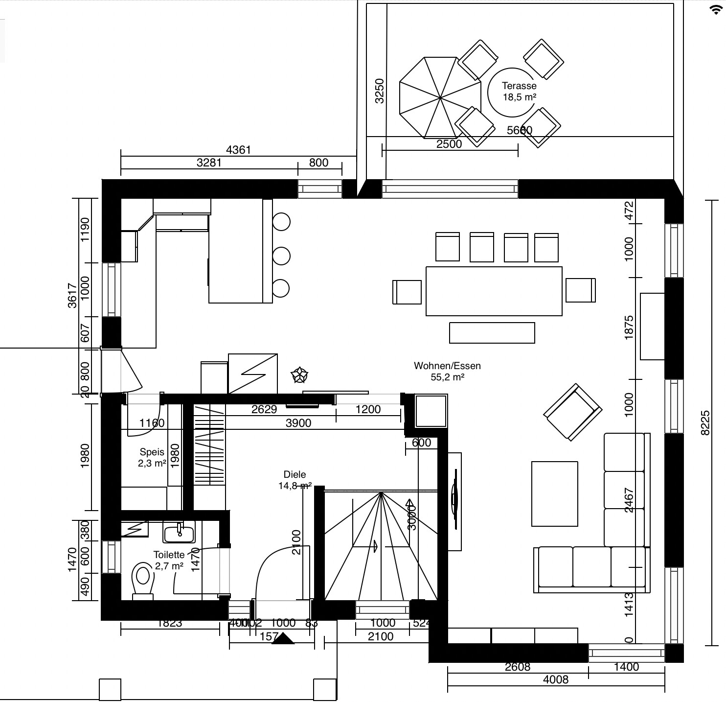

The bay window on the ground floor (living room bottom/right) is not really necessary, but without it the exterior looks quite boring. One idea would be to move the bay window to the upper floor (same position in x and y) to create a larger children’s room. I think the costs for this would be quite high, though.

Is this floor plan practical? How could it be made smaller without losing too much space on the upper floor?

Number of floors: 2 full floors + basement for utility room, sauna, workshop, etc.

The dimensions look odd... on the upper floor, 810cm (320 inches) including walls = approx. 737cm (290 inches) inside minus interior wall = approx. 720cm (283 inches)... that means 360cm (142 inches) per children's room... but there are no realistic furniture layouts shown.
Stair dimensions?

the floor-to-ceiling height should be standard to start with, so 2.50 m (8 ft 2 in).
I sketched the staircase at about 2 x 2 m (6 ft 6 in x 6 ft 6 in). That should be roughly right for a half-turn staircase, shouldn’t it?
You’re right about the furniture in the children’s room. At the moment, only the changing table and a baby crib are shown, so it’s not a regular bed.
