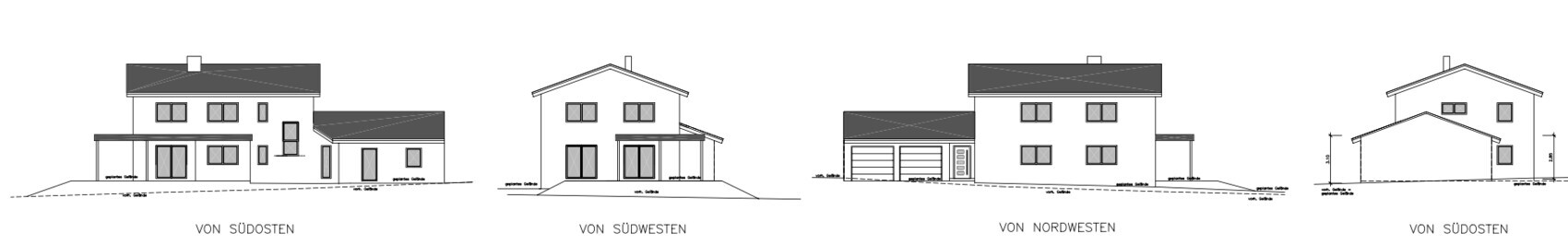

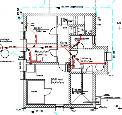

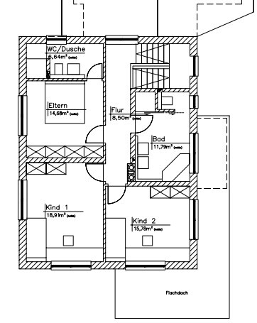

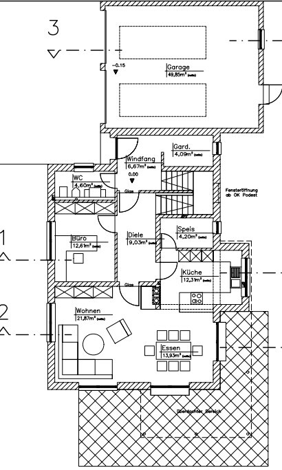

Now on my second attempt, I believe I’m in the right section of the forum and have also found the questionnaire. I would like to ask for your opinion on my current planning. The overall concept is mostly set, but maybe some details could still be optimized.
Size: 830 m2 (8940 sq ft)
Slope: minimal
Number of floors allowed: unrestricted
Roof style: unrestricted
Design style: unrestricted
Allowed roof colors: everything except violet
Planting requirements: 2 small trees
Style: modern and traditional combined, gabled roof
Basement, floors: 2 full floors
Number of occupants, age: 2 people in their late 20s (children planned within the next few years)
Office: family use or home office: home office
Annual overnight guests: max. 1
Open or closed architecture: partially open
Conservative or modern construction: a certain mix
Open kitchen, kitchen island: open
Number of dining seats: 6
Fireplace: yes, pellet stove
Balcony, roof terrace: terrace is sufficient, but it should be covered
Garage or carport: garage with usable space
Utility garden, greenhouse: not planned within the house design
Designed by:
- Architect
What do you especially like? Why? Large children’s rooms, wellness area in the basement, open kitchen, extra bathroom in the master bedroom
What do you dislike? Why? Nothing comes to mind currently
Estimated price according to architect/planner: /
Personal price limit for house including furnishings: 550,000€
Preferred heating system: pellet stove
Home automation desired: KNX
(but programming will be done by ourselves and should not be overused everywhere)
If you had to give up, which features/expansions
- Can you give up: extra space in the bedroom (which we already have)
- Cannot give up: 2 bathrooms, space for children
Why does the design look like it does now? e.g.
Standard design from the planner? No
Were specific wishes implemented by the architect? Yes
What do you think makes it particularly good or bad? Modern architectural style with traditional/conservative elements.
Attached is the current plan.
Edit: For light reasons, the terrace on the south side will be only 3 m (10 ft) wide instead of 3.5 m (11.5 ft).
Please share your thoughts.

XxTankerxX23 Nov 2020 17:18So – the plan is now complete.
An additional window was added in the stairwell, one behind the wardrobe, and all the windows on the south side are now floor-to-ceiling. The canopy was also reduced to 2.5 m (8 feet 2 inches) in length. This results in significantly more natural light inside the house.
The kitchen layout has also been made continuous.
Thank you for your help. I probably would have made quite a few mistakes, especially regarding the lighting aspects.
xXTankerXx

XxTankerxX16 Dec 2020 13:59Well, there is a noticeable difference between a standard window with a sill height and a tilt-and-turn window.
I would reconsider the pantry door. As mentioned, managing groceries through that door would be tricky, and—just as already noted—the kitchen door will mostly remain open, so I would simply omit it (this way, the access to the pantry is also not blocked).
