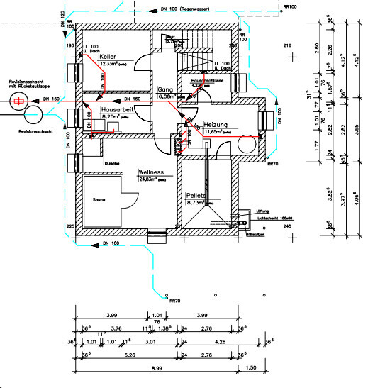

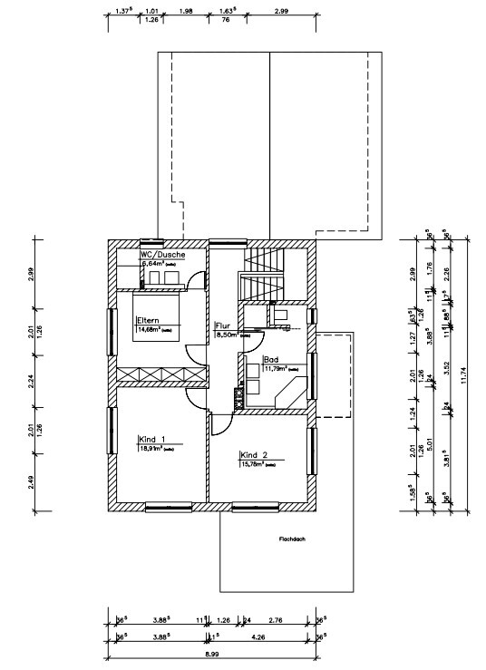

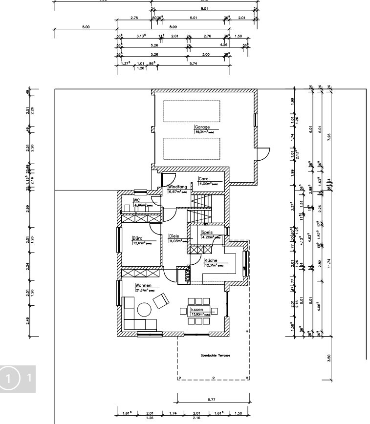

XxTankerxX13 Nov 2020 09:50Elokine schrieb:
Hello everyone.
What I like here is that the master bedroom has a smaller en suite shower bathroom, while the larger family bathroom is available for everyone.
There are two main negatives that stand out: the staircase and the kitchen.
The kitchen bay window is not very useful for the floor plan, and the passage to the living room seems quite narrow.
I find the staircase even more unfortunate. It doesn’t fit, or isn’t in the right place for the floor plan. Apparently, this is seen on the upper floor. The corridor is very long and becomes narrower towards the children’s rooms.
On the ground floor, the ratio of the entrance area + cloakroom + hallway compared to the actual living space is far too large – these three combined cover as many square meters as the living room! Regarding the kitchen: well, a few square meters can be gained, and the house is then no longer just a rectangular box. How far to extend the counter towards the dining area is still a question. A few centimeters of extra space probably won’t hurt, I agree with you there.
About the staircase: I think it’s brilliant. This way, the basement and entrance area are thermally separated from the living area and the staircase to the upper floor. Especially in the summer, you often need to access the basement during garden work. This layout provides quick access from the front door.
And we originally wanted a very large square entrance area. The corridor here is more of a compromise – it takes up less space but still provides enough room for additional dressers or other storage options.
Make the terrace deeper than 3 m (10 feet). The lawn edge is a tripping hazard. You don’t have to extend a roof covering over the entire depth.
A wellness area in the basement without outdoor access? Really? That wouldn’t feel like wellness to me.
Draw the existing and planned furniture in scale into every room. Consider traffic flow.
I find the staircase position unfortunate, and the kitchen doesn’t quite appeal to me either. The space next to the bed in the master bedroom looks quite tight. Usually, there is still some surface area next to the bed, or temporarily a baby cot.
hampshire13 Nov 2020 10:15I really like the design very much.
- Stairs: Regarding the staircase layout, I immediately thought it’s quite clever to have the cellar access from the entrance area and the stairs to the upper floor from the inner hallway.
- Entrance and wardrobe: It’s certainly quite spacious – very practical for a household with a whole generation of children ahead. A stroller never gets in the way. There’s plenty of space for clothes, coats, and jackets. The front door can stay open without disrupting the indoor temperature – also great when you have children.
- Kitchen: I would combine the hallway, pantry, and kitchen into one large room, add some soundproofing, and use daylight-mimicking lighting. That would make a wonderful central space for a family. The passage to the dining area could definitely be a bit wider.
- Bay window: I see that this adds space to the utility room and the kitchen. From my point of view, that’s well solved, although not cost-optimized. But cost is never the only factor.
- Living area: Why people like to sit with their backs to the windows remains a mystery to me. Probably has to do with the TV setup – although no classic TV orientation is visible here.
- Privacy: The house layout allows for a pleasantly private life away from the entrance area – assuming there isn’t very dense surrounding development.
- Children’s rooms: It’s nice that these are given a prominent place in the house, along with a decent family bathroom.
- Master bathroom: It’s a tight fit. If a crib is in the room, getting in and out of bed is like in a camper van. Of course, it works, and I wouldn’t have any problem with it.
- Sauna area: I would consider adding an outdoor staircase to the garden. Then rotate the sauna 90 degrees and have the stairs lead from under the living room window into the garden. Maybe a permanent or seasonal water feature could be placed in the garden – very pleasant between sauna sessions.
- Garage: A single continuous door is more practical than two separate doors. Is it possible to move bikes around the garage without squeezing past the cars? Then a wider door or an additional door at the back could prevent scratches. Children’s vehicles tend to be used intensively and with varying parking care.
- Driveway: Hopefully not just a straight paved strip as shown in the drawing. There is room here for greenery and a more flowing design.
- Terrace: Some curves here would be good as well. This creates a cozy area next to a stricter (partial) roof. People sitting outside need space.
- Terrace roof: Translucent photovoltaic elements provide light, energy, and also look attractive.
- Transition from dining area to outside: Consider a fully glazed solution. This way, even with a roof, it won’t be dark or visually cramped.
- Exterior: Add some wood finishes 😉

Thanks for your opinion.- Where would you add wood cladding?
- The courtyard will definitely have some greenery, as will the area in front of the terrace. A south-facing staircase to the garden is planned there anyway.
Question to you and everyone else: How would you design the roof / canopy? I was thinking of glazing it as well. However, a nice solution must be found to include the bay window under the roof. Maybe a combination of different approaches would work.
