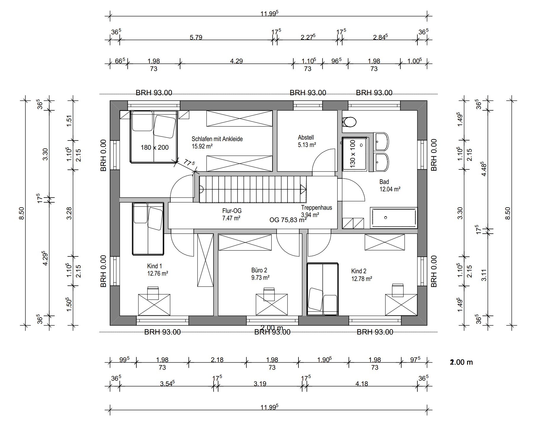

Minerva1217 Apr 2026 20:04Good evening everyone,
We have revised the design and are now at about 155 sqm (approximately 1670 sq ft), still including a basement. Some areas are not yet completely satisfactory: the storage room on the upper floor is too large, the children’s room a bit small (target size around 15 sqm (160 sq ft)), and the passage between the bed and the walk-in closet is also not ideal. The home office on the ground floor has only one window to allow for more usable wall space.
Before we move on to the next revision, we would appreciate your assessments and opinions. Besides the points mentioned above, do you notice anything else we might have overlooked?

Minerva121
Minerva121 schrieb:
Passage between bed and dressing room is still not optimal That can’t be improved either because the distance between the bed on the left and the wall is only about 30 to 40 cm (12 to 16 inches), which is really too narrow. And why is there a window with a sill height of 93 cm (37 inches) right behind the bed’s headboard?
The children's rooms could benefit a bit if the second home office on the upper floor (initially, a small work corner was supposed to be enough) were made slightly narrower. Also, doors and windows should be placed so that cabinets can optionally be arranged along both office walls.
Living area – sofa/TV: I think the distance is too large. Why place a floor-to-ceiling window behind the sofa leading to the terrace?
And a floor-to-ceiling window in the ground floor office, what is its purpose?
Kitchen, maximum width about 370 to 380 cm (12 to 12.5 feet)? Unfortunately, it’s hard to tell from the plans. Depending on the family and cooking habits, this would not be my preferred layout. And pantry—yes, a small storage room for the vacuum cleaner, mop, etc., but a pantry when there is a large basement?
I see a lot here that is absolutely unacceptable. I think the planner has withdrawn from this, so things in the design are being accepted that cannot be changed with this attempt to improve or downsize.
Starting at the top left and moving clockwise,
- Bedroom doorways were mentioned, all very tight, with furniture scraping against walls that have no baseboards (bedside tables, passageways)
- Window above the bed?
- Walk-in closet trapped
- Narrow toilet niche, so a helping hand during illness has no space. No big deal, the kids will just have to manage without.
- Shower can only have a door
- Hallway is long and dark
- Office location combined with size is not inviting
- Shower bathroom just barely within the size limit.
- Stairs don’t work because the upper floor exit is oriented opposite to the rest. For the upper floor, you currently have to step in front of the TV to go upstairs. For the basement, you have to step in front of the TV to get down there. Who stopped thinking here? This definitely does not happen with an architect.
I’ll read the post again... Yes, you’ve made a major mistake here.
- Fundamentally, the stair landing, whether going up or down, is poorly positioned and obstructive.
- Kitchen: Am I correct in understanding that the necessary 60/65 cm (24/26 inches) for the kitchen workspace was reduced to fit the desired large island?
- Windows: What was adjusted on the least important north side was neglected on the other facades. The floor-to-ceiling window in the bathroom is quite original, but it faces away from the room.

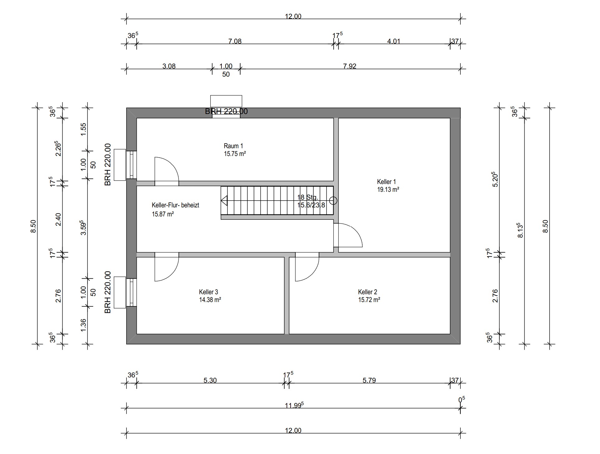

- Basement: Such careless layout of rooms… I mean, the basement is just the basement and shouldn’t be overestimated. But making the dark underground rooms even more awkward is really remarkable. One room is narrow, okay... but then there are three! That long. Who wants to go deep into those rooms?
The entire design in #38 is a very good example of a misguided attempt at improvement due to clinging to something that has already suffered and turned out poorly in the original plan. The two opposite examples could easily be pinned as a warning in the forum.

Minerva121 schrieb:
We have now revised the plans, ending up with about 155sqm (including the basement). Some areas are still not fully satisfactory: the storage room on the upper floor is too large, the children’s room is a bit small (the target size is around 15sqm), and the passage between the bed and the dressing room is not optimal yet. The ground floor study has only one window to allow for more usable space. Before we move on to the next revision round, we would appreciate your assessments and opinions. Aside from the points already mentioned, is there anything else you notice that we might have overlooked?At least from my most frequently mentioned mantras, pretty much everything. You must have worked on the "revision" quite unsystematically, probably starting with the basement. Child 1 will be jealous of Child 2, who has a much better shaped room for almost the same nominal size—and with fantasy measurements to spare, a dream for botchers. There are days when, just for that reason alone, you should lie back down so that the next attempt doesn’t start off on the wrong foot again. Some people could write guides on how to mess up house designs (if only they could explain more systematically how they do it); in any case, I envy them. It’s supposed to be so easy: I keep explaining it verbally, and Yvonne, Kerstin, and Katja demonstrate it.
Several points have already been raised explaining why the design should not be implemented as is, and I fully agree with them. What stood out to me immediately in a negative way was the bathroom. The room is actually quite spacious for a bathroom, yet the layout of the individual fixtures is really poor. That toilet niche is definitely not suitable for a household with children... everything else also feels awkwardly cramped. The staircase is positioned very inconveniently, and so on.
Since the basement has been questioned several times here and above-ground alternatives have been suggested, I would like to share my experience. In the house I built with my ex-husband in 2018, we added an extension of about 16m² (170 ft²) next to the kitchen, which also had an external access. On top, it could be used as a balcony. The room was, as far as I recall, built with the same masonry as the house but with its own wall separating it from the house, creating essentially a double wall. As originally planned, my ex-husband later added a garage to this room, with additional workshop/storage/hobby space behind it and above it (accessible via the balcony and by stairs from the garage). I personally found that room next to the kitchen really practical back then, and from what I have heard (including through my daughter), my ex and his new wife are also very satisfied with the extension.
