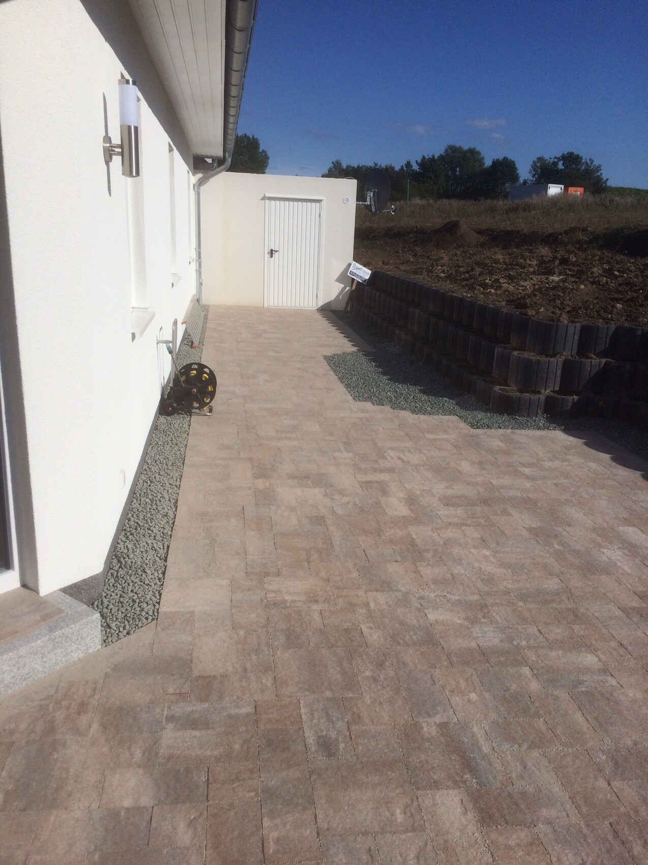

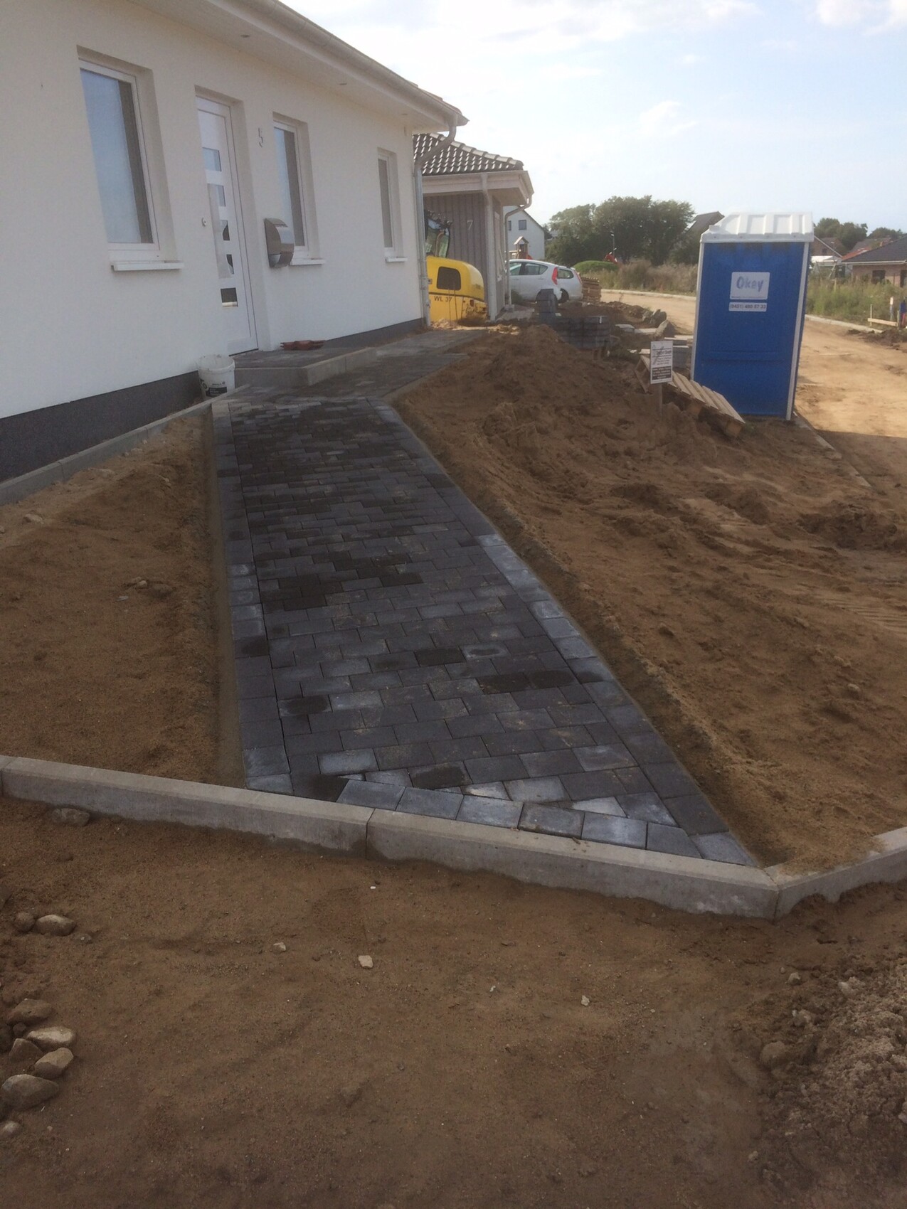

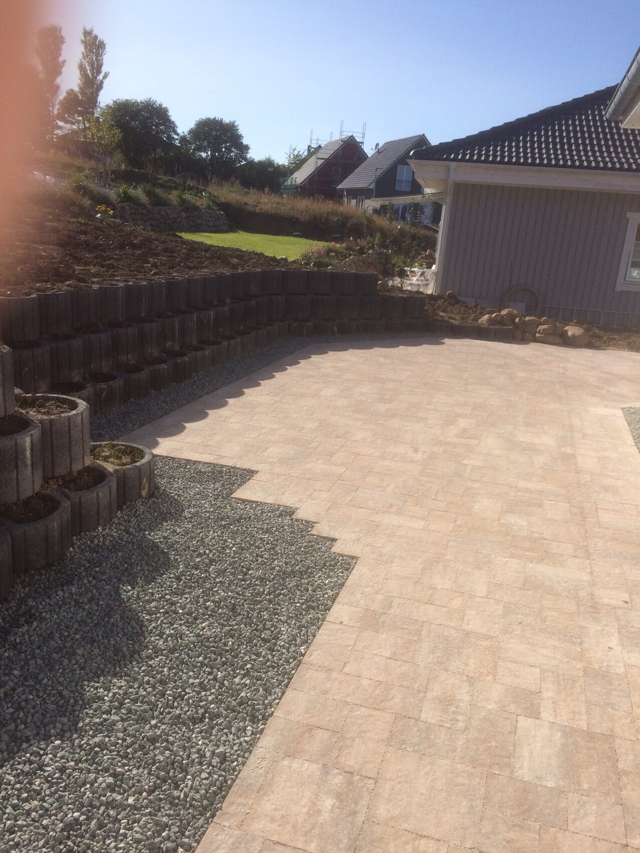

I’ll give you an example: Our soil: topsoil, underneath clayey and gravelly. Our plot: 30 m (98 feet) deep at the widest point, 24 m (79 feet) at the narrowest. Slope from street level to rear fence post is 1.2 m (3.9 feet). Slope in the house area: house is 10.5 m (34 feet) wide, slope is 1 m (3.3 feet), with the house set back 5 m (16 feet) from the street boundary. The slab was positioned so that at the front it extends 0.5 m (1.6 feet) beyond the land, and at the back it goes 0.5 m (1.6 feet) into the land.Quick question, since my situation is similar. From the street to the back of the house there is about 1 m (3.3 feet) of slope. I would be about 50 cm (20 inches) above street level at the front and 50 cm (20 inches) below ground at the back, which would need to be excavated. I wanted to ask how you handled the garden. Did you have the entire plot excavated down to the boundary, or just part of it, creating a small slope to regain the remaining 0.5 m (1.6 feet)?
If possible, I would appreciate a photo showing how this was resolved, especially the situation next to the neighboring property.
jaeger schrieb:
I wanted to ask how you handled the garden. See the house photos thread, page 115 (post #685) – click on the arrow in the quote box:
Nordlys schrieb:
And the landscaping contractor built the dike to protect against mountain floodwaters. In the same thread and around the time of that post, you will also find the surrounding context.
Are you sure you want to be 0.5m (20 inches) above street level? I'm glad it almost didn’t happen here by chance.
Originally, I thought that all the soil removed could be used elsewhere. However, I didn’t account for the gravel. We don’t have good topsoil, so everywhere the terrace is planned and in front of the house, gravel was added, which required removing even more soil. In the end, we actually have more soil left over than expected.
At the lower, rear part where the terrace will be, we plan to create a flat area extending to the property boundary or leave a slope just before the boundary, possibly supported with retaining walls. If you excavate all the way to the back, wouldn’t the slope cause you to re-emerge on the turf eventually?
If there is a small slope rising behind the terrace, there’s a risk that rainwater will collect on the terrace. I would avoid that; it’s better if the water can continue to drain away.
