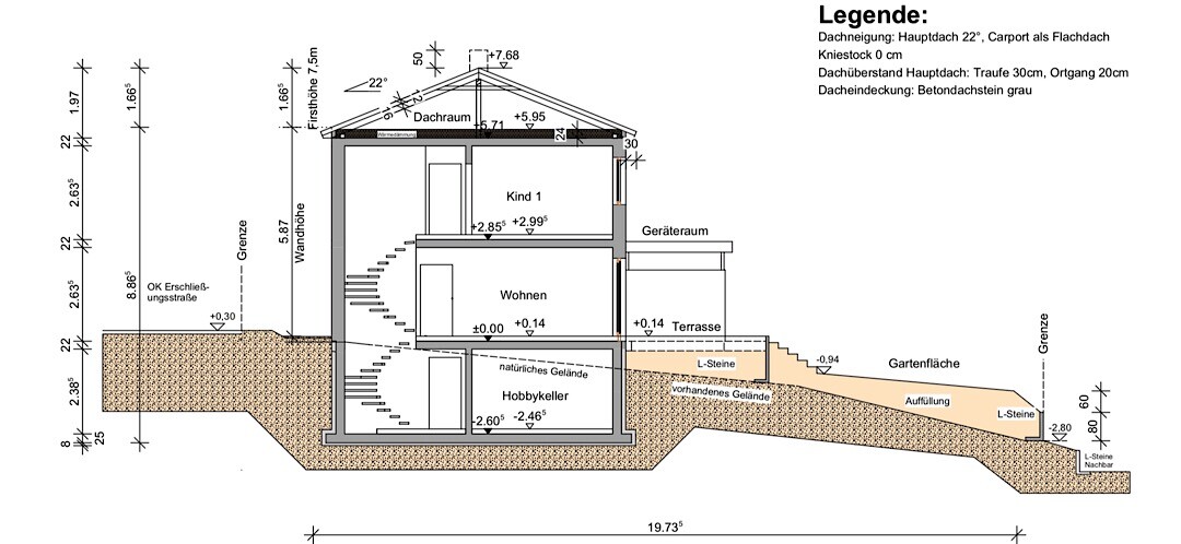

I would appreciate your assessment on the following matter:
Basement dimensions: 8.16 x 9.99 meters (let’s say 8.20 x 10)
Excavation depth (see section): approximately 3 meters (10 feet)
In addition, the slope situation: I would say the basement extends about 1/3 above the existing ground level
Workspace allowance: 60 cm (2.4 inches)
Slope angle: According to the soil report, I assumed 60° (recommended between 60° and 80°)
All in all, I calculated an excavation volume of approximately 303 m³ (10,700 cubic feet). Are you getting similar numbers? Did I make a mistake somewhere?
I ask because our excavation contractor has quoted a solid 520 m³ (18,350 cubic feet). Unfortunately, I wasn’t able to reach him today to ask where this figure comes from.
Either I have made a significant error somewhere (which is why I am asking for your opinion) or there is something wrong with the quote.
Many thanks in advance!

@tomtom79 As shown in the picture from the first post: The slope declines away from the building. And as mentioned in the first post as well: The basement extends about one-third above ground level. So, for leveling, material doesn't need to be removed but rather added... as @Müllerin correctly pointed out. There is actually quite a lot of material that needs to be filled in, which fortunately (and according to the soil report) is not a problem. The soil is mostly suitable for this. So we will only have to haul away a small portion.
