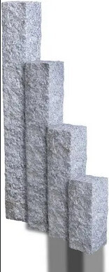

These are palisades, which I think is what you mean by posts. However, as far as I know, posts are actually freestanding.
Gray concrete blocks in a shell construction foundation

In "my" hardware store, granite stones measuring 10 x 25 x 100 centimeters (4 x 10 x 40 inches) are called "steles."
I plan to lay them flat as the tread surfaces of the steps and, to achieve a reasonable step height, support them underneath.

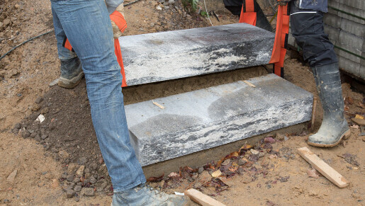

LOL – glad you still haven’t answered how you plan to set the steps (yes, that’s what they’re actually called in hardware stores).

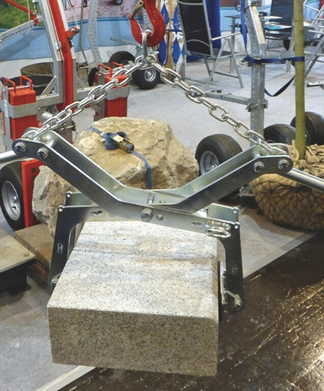

The "steles" weigh 67 kilograms (148 pounds) each. Usually, they are installed either with equipment or an excavator to do it properly:
Construction site scene: Two workers lifting heavy concrete steps with lifting straps.
Heavy granite block held by a metal device with crane hook.

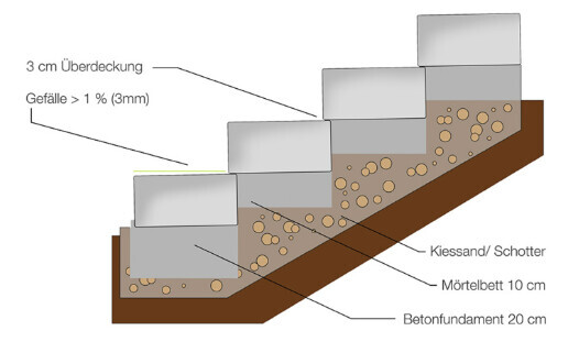

And the correct assembly to ensure it functions properly looks like this:
Cross-section of stair foundation: gravel/sand, 10 cm (4 inch) mortar bed, 20 cm (8 inch) concrete foundation, slope > 1%
The most important thing is that you build a proper foundation under the lowest step. Otherwise, the entire staircase can shift very quickly.
P.S. The structure design is from EHL for their own block steps, so it is very suitable for your project.
