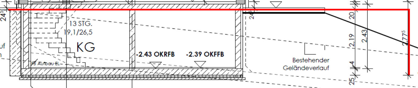

I would appreciate your assessment on the following matter:
Basement dimensions: 8.16 x 9.99 meters (let’s say 8.20 x 10)
Excavation depth (see section): approximately 3 meters (10 feet)
In addition, the slope situation: I would say the basement extends about 1/3 above the existing ground level
Workspace allowance: 60 cm (2.4 inches)
Slope angle: According to the soil report, I assumed 60° (recommended between 60° and 80°)
All in all, I calculated an excavation volume of approximately 303 m³ (10,700 cubic feet). Are you getting similar numbers? Did I make a mistake somewhere?
I ask because our excavation contractor has quoted a solid 520 m³ (18,350 cubic feet). Unfortunately, I wasn’t able to reach him today to ask where this figure comes from.
Either I have made a significant error somewhere (which is why I am asking for your opinion) or there is something wrong with the quote.

Hm, well, the 60cm (24 inch) working space comes from the offer provided by the civil engineering contractor. He also mentioned it during the first inspection appointment.
EDIT: It actually seems that a "60cm (24 inch) clear working space" is the requirement.
Regarding the blinding layer, you are of course right, it still needs to go underneath. But since our basement has a height of about 2.70 meters (8 feet 10 inches), 3 meters (9 feet 10 inches) should actually be sufficient, shouldn’t it?
