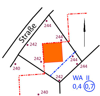

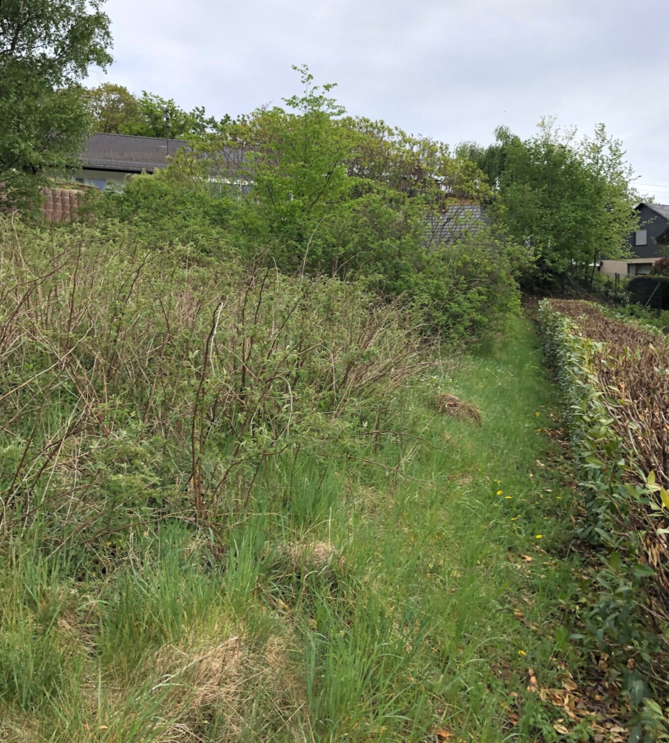

Attached are the cadastral map including contour lines (in red) and some photos I took. The plot number is 1468. A soil report is not yet available but would of course be commissioned once things become more concrete. At this stage, I am really only looking for a rough assessment of what could be realistically built within a reasonable budget and what would not make sense.

Haus_2020 schrieb:
A bit of a headache For headaches, a plan helps:
Haus_2020 schrieb:
absolutely can’t assess A 2m (6.5 ft) height difference within the house footprint suggests a basement level. On the left, right, beside you, behind you, and in front—everyone seems to have a partially underground cellar, or better said, a basement.
Haus_2020 schrieb:
as well as a few pictures Photos without a spirit level cause more confusion than help. Here is picture 1 after roughly leveling:
The slope is more clearly visible; in the end, though, local height measurements are needed since the neighbors apparently have done significant landscaping.
