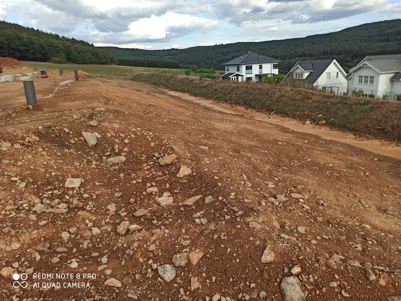

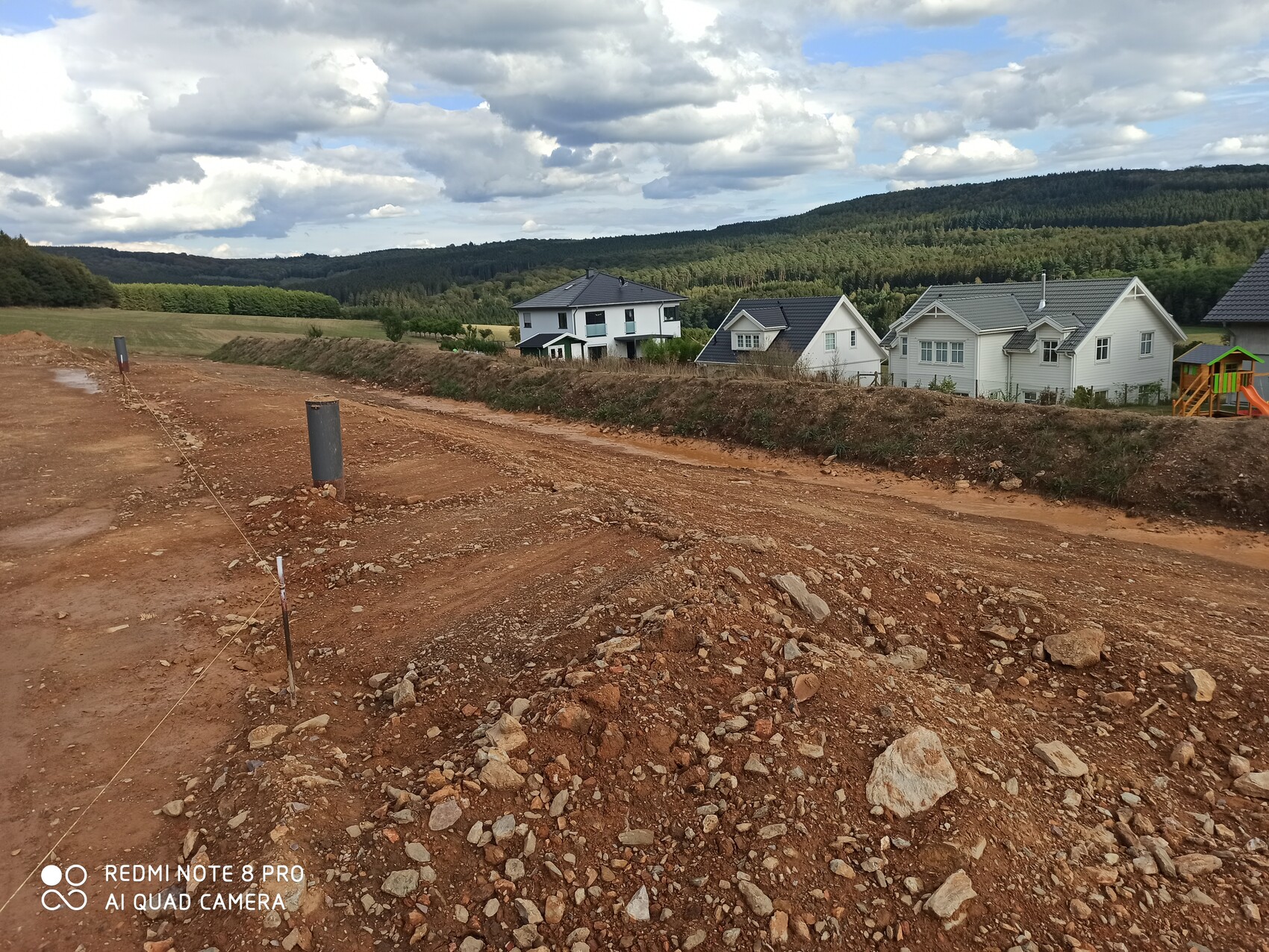

I have reserved this plot of land, see attachment, and have already received a cost estimate from the construction company. The builder plans to construct a house on a slope on the plot, see picture in the attachment. This costs about 18,000 euros more than a house built only on a slab foundation. Additionally, the earthworks have been estimated at 40,000 euros, including drainage, additional foundation work, etc. Unfortunately, this is a total of 40,000 euros more than I had originally planned. What do you think about this cost breakdown? Is it really that expensive?

I find that quite realistic. We are also building a house on a slope, and in 2019 we paid about 65k for earthworks and the foundation slab. Additional insulation as well as waterproofing against the slope and drainage might also be necessary. Extra costs for us were around 15k (this also depends on whether you are building to a KfW standard, what the soil report shows, and so on). It’s best to ask about these details here. Also, it’s advisable to have an additional buffer since costs can always increase.

An additional cost of around 18,000 compared to a flat plot is possible. The final decision lies with the structural engineer and the geologist.

Excavation work varies greatly by region. I do not consider 40,000 to be too much. It is difficult to give an exact figure.
What is still missing is the landscaping. Every change in elevation needs to be managed, and every bucket of the excavator adds cost.

In your case, the road construction will also be at least 0.8 – 1.2 meters (2.5 – 4 feet) higher in the future (see the channels). Yes, building on a slope is at least that much more expensive. It’s already good that the general contractor was honest. There are often unpleasant surprises because of this.
