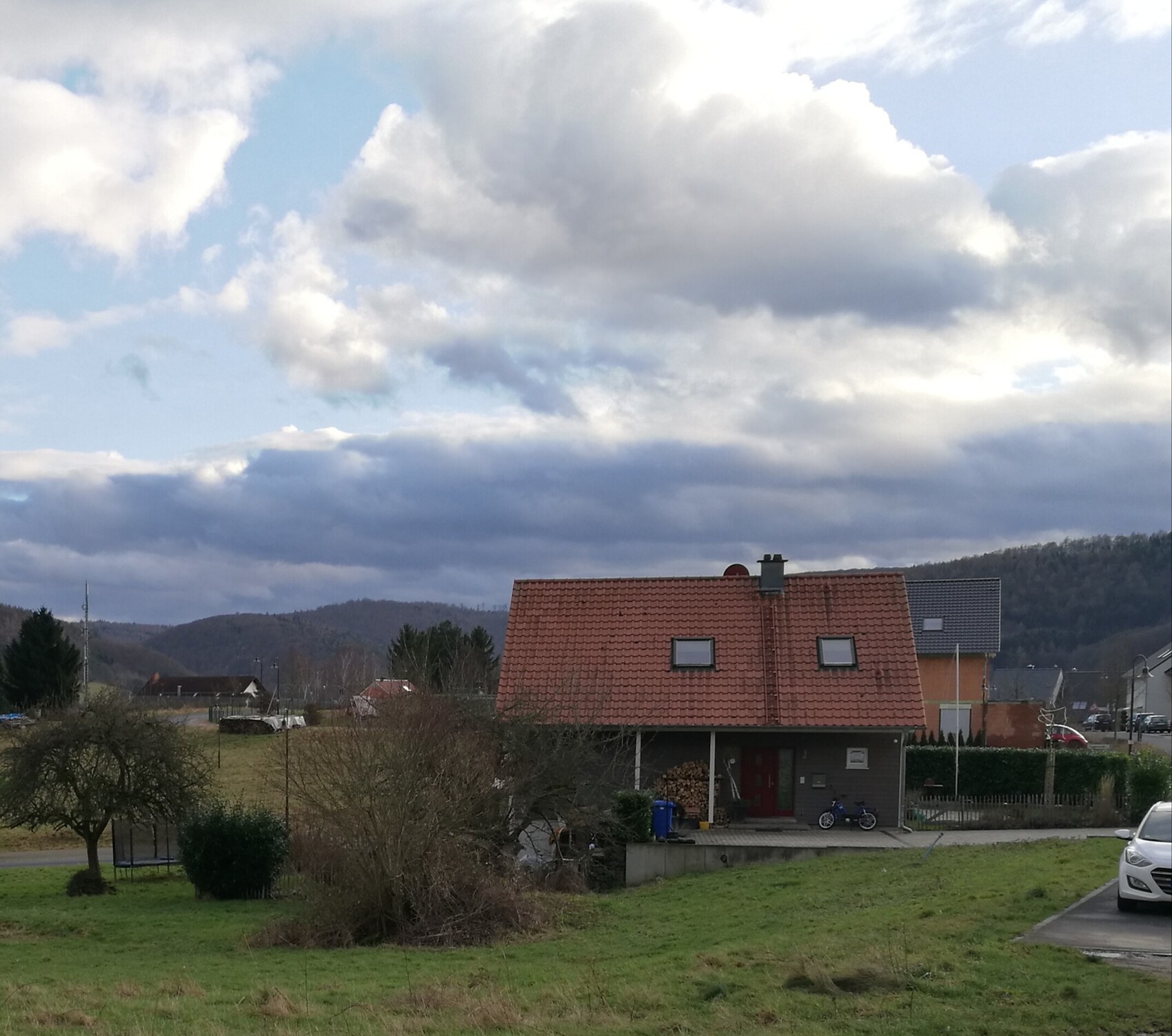

We have finally found a plot of land that we really like in terms of location, size, and price. Unfortunately, it has a slight slope. We originally planned to build only with a slab foundation because the plots are more expensive than expected and, of course, our budget is limited.
My question now is: Would it be possible to build on this plot (see attachment) using a slab foundation? The plot extends all the way to the edge of the curb.
My idea was to keep the parking space at street level, aligned with the neighbor’s retaining wall blocks, and then create a kind of embankment from the street down to the house so that the house would be 1–2 meters (3–6 feet) below street level (if even that much would be necessary). The embankment could be planted as a front garden, and a staircase could lead from the parking space down to the house entrance.
The alternative would be a walk-out basement, since we want to have level access to the garden, but that will probably be quite expensive.
What do you think would be sensible and feasible in this situation?
Thank you in advance.
The Wüstlings

It is a myth that omitting a basement always saves money. This is generally only true for plots that are as level as the concrete slab. When there is an almost "basement-high" difference in elevation within the building footprint, leaving out the basement can end up costing nearly as much as building one. This is simply because the additional fill, slope stabilization, and so on are not inexpensive either. In the end, you might spend the same amount of money and just have no storage space in return.
A plot shaped like a slide with the house at the lower end also means, in turn, a sewage lifting station if the street is at the top.
Concrete slab houses belong on plots suitable for concrete slabs.

It is a myth that skipping a basement automatically saves money. This generally only applies to plots that are as flat as the slab itself. When there is practically a "basement-high" elevation difference within the building footprint, omitting the basement ends up costing nearly as much as building one. Simply because the added fill, slope stabilization, and so on are not free. In the end, you might spend the same amount of money but end up without the additional storage space.
A plot shaped like a slide with the house at the lower end also means a sewage lifting system if the street is at the upper end.
Slab-on-grade houses belong on plots suitable for slab foundations.
That exactly is the right comment regarding the photo posted by the OP.

It's funny how the answers from the general contractors are similar. We also spoke to a general contractor in a similar situation. He said the extra costs would be around €7,000.
Since I was a bit skeptical about that, I asked an experienced architect. He said from experience, either you spend at least €30,000 here or use the extra costs for a basement. You also have to keep in mind that you will have to level the garden for tens of thousands of euros.
Going down 3 steps to the garden means a height difference of 30–40cm (12–16 inches). Looking at your site, it’s at least 1.5m (5 feet) down to the start of the garden. After that, it continues to slope further down.
