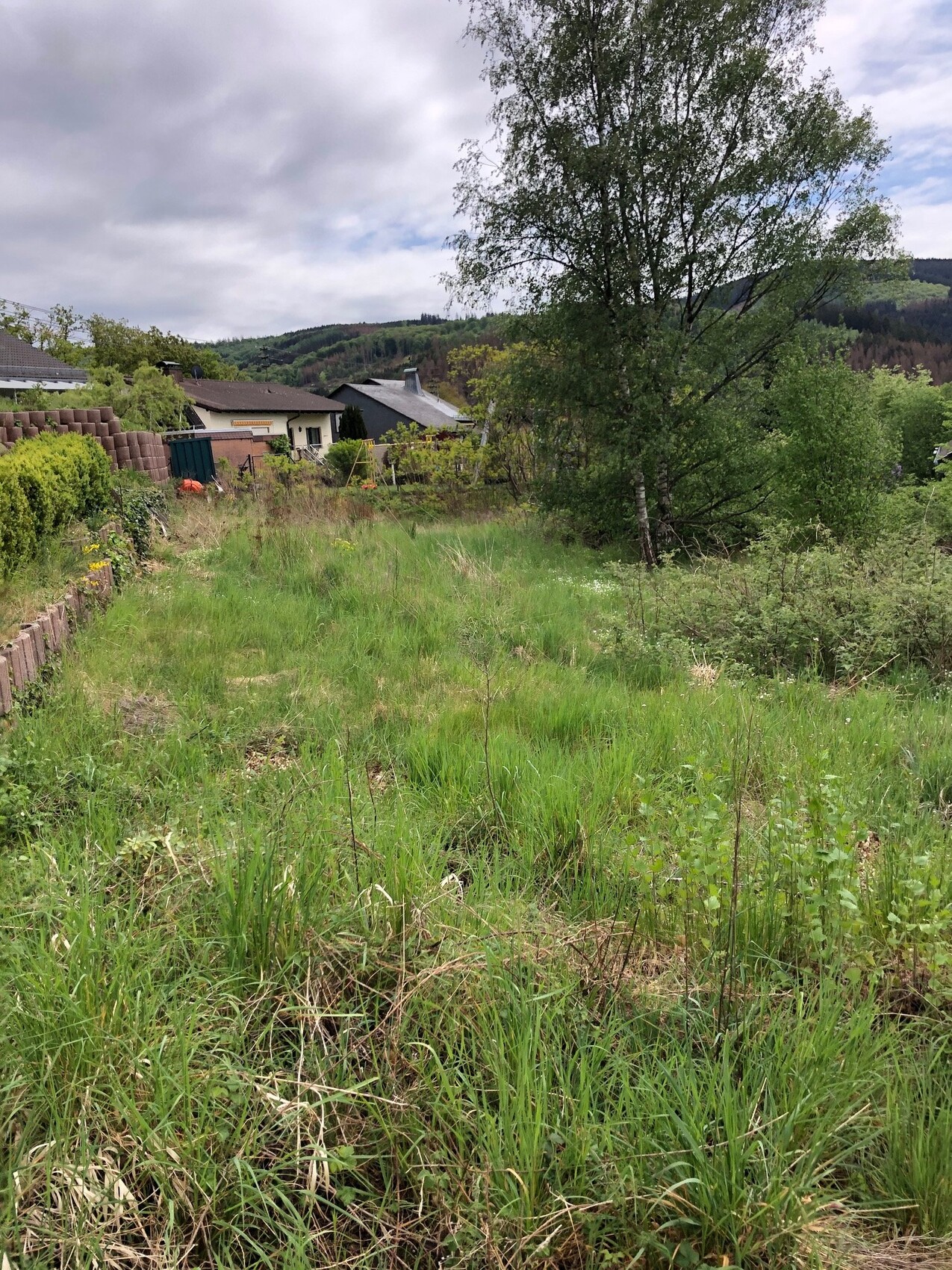

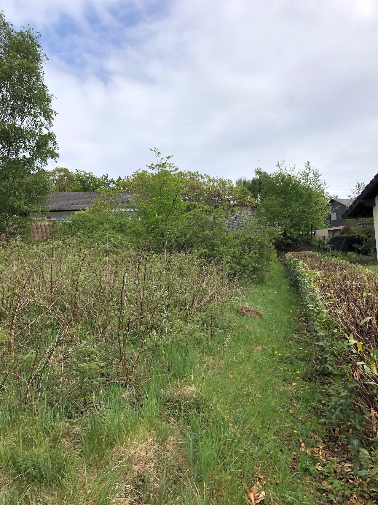

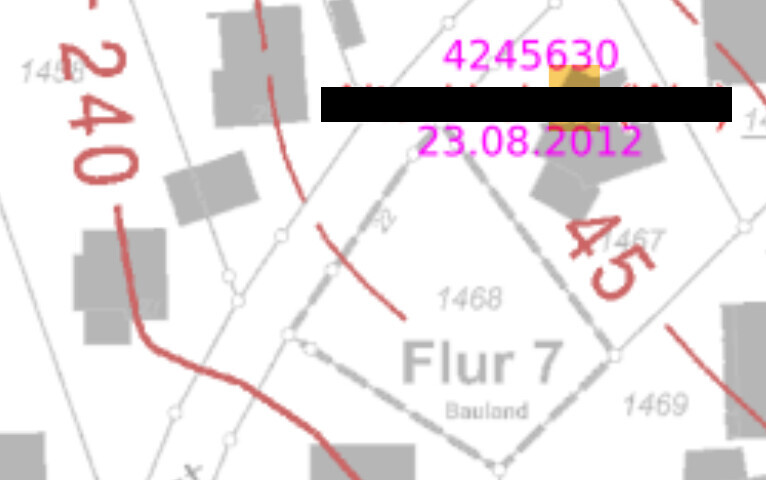

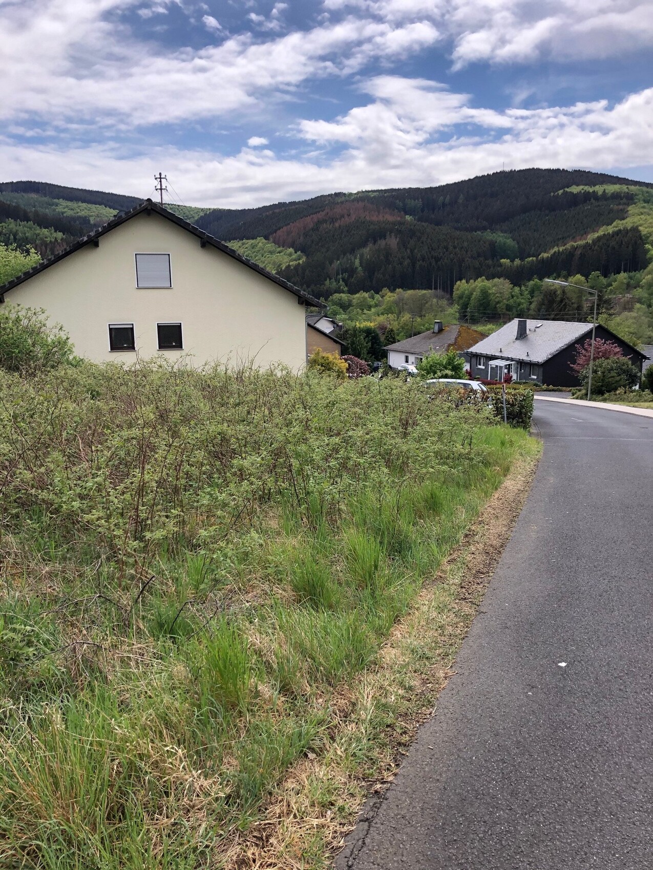

We would preferably like to build without a basement, although it might be possible for the lower floor to be partially embedded in the slope. Since I really cannot assess the plot and it depends on whether a basement/lower ground floor embedded in the slope or just a foundation slab is necessary, I would appreciate some insights.
Attached are the cadastral map including contour lines (in red) and some photos I took. The plot number is 1468. A soil report is not yet available but would of course be commissioned once things become more concrete. At this stage, I am really only looking for a rough assessment of what could be realistically built within a reasonable budget and what would not make sense.

Your calculation might work out, but it doesn’t have to. This is how you can calculate if you haven’t made a “tight” detailed budget. Depending on the soil class, house provider, and requirements for initial terrain modification or landscaping, there could still be additional costs.
Some thoughts:
  • Park your cars in the basement so they don’t take up space on your relatively modest plot of land.
  • Build only the square meters you really need and plan to use. Since it’s unclear for how many people you are building, the 150 sqm (1600 sq ft) can’t be properly evaluated.
  • If you have some skills and time, you can handle the landscaping yourself. If you also have some ideas and imagination and don’t want a standard paved terrace, awning, hedges, and turf, you can gradually create a very nice garden with limited funds. Shaping the terrain with a natural flow is cheaper and often more attractive than the “brutal terracing” approach with concrete. If you hire someone to do it, your budget will be too tight. Be courageous with your own ideas!
  • In the end, what matters for your quality of life is not what “people do,” “what the neighbors think,” “what a crowd of forum users say,” or how much one square meter of house cost. What counts is how well the house and land make your life better.
  • Sloped terrain often brings surprises – set aside a risk budget and knock on your neighbors’ doors to find out what surprises they experienced during construction.

Additional construction costs would fit our budget now. We spent around 60,000 despite extensive earthworks (excavating 1,200 m3 (1,570 yd3) including topsoil and transporting away 880 m3 (1,150 yd3); the rest was reused on site). However, this mainly depends on how much landfill disposal costs in your area. We were partly able to transport excavated material to another property, and for the rest we paid 14.5 EUR per m3 (0.39 EUR per ft3) including transport and disposal. I have also heard of much higher prices.
I still believe that 15,000 will never be enough for the garden. Even if you slope everything, avoid walls, pave yourself, and build stairs yourself (which seem unavoidable on a slope).
For a tight budget like yours, I would recommend a 50,000 buffer. I bet you will need most of it for the landscaping, and the rest will serve as a general contingency for the house.

The basement level is more cost-effective here. Especially since you then have direct access to the south-facing garden.
You could roughly stay within the budget if there are no unexpected costs and you don’t build larger than you actually need. Advice from Hampshire.
I just wouldn’t place the garage under the house. It deserves the best spot on the property.

We also have a steep slope and built a basement with an internal double garage. The driveway is level with the street, and the ground floor at the back is level with the garden. I think this is a good solution. However, excavation, disposal, and later backfilling costs can add up. 20,000 could be tight. Of course, it depends on the soil type and whether the excavated material can be reused for backfilling. Unfortunately, we had to transport 1,300 tons to the landfill.
