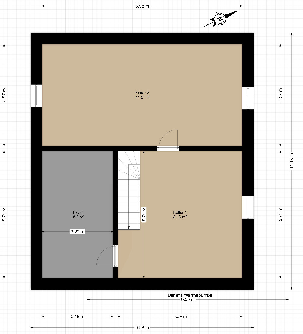

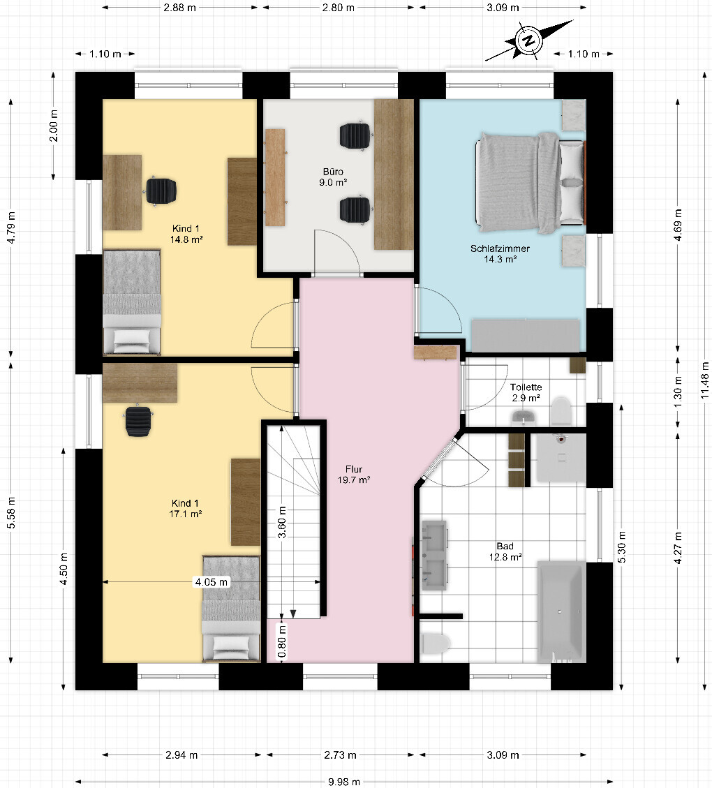

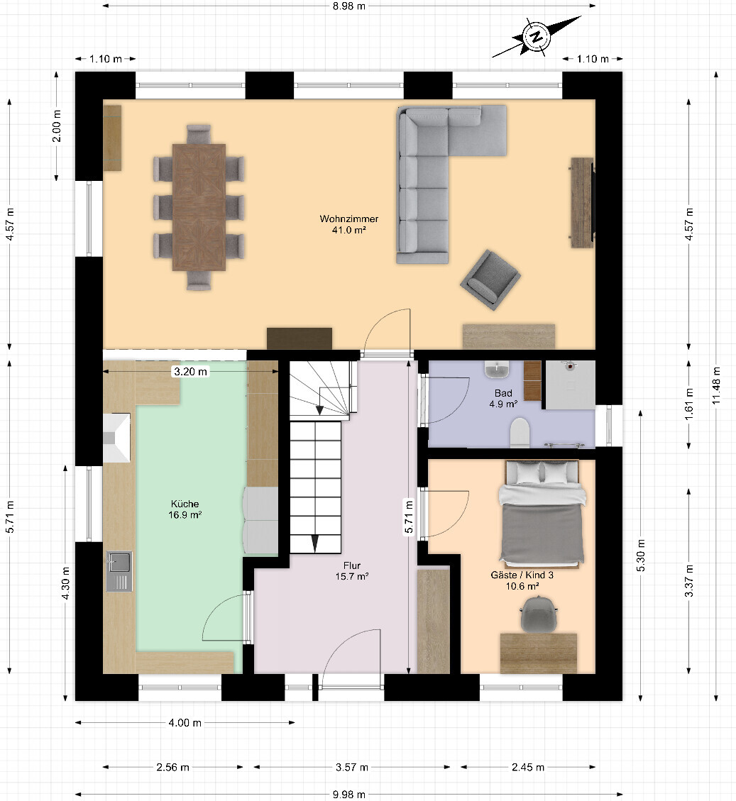

saralina8718 Jun 2020 07:12Hello
Is the kitchen supposed to be that wide? 1.20m (4 feet) is usually enough space between the two rows – it might be worth considering whether to create a larger wardrobe or a pantry behind the stairs instead.
Upstairs there seems to be a lot of hallway... Is a single closet enough for you? And do you really need two bathrooms upstairs? I have to admit, I'm not very happy with the layout of the upper floor.
Have you taken a close look at the stair treads? It’s hard to see how you’re supposed to step on them; I can’t imagine they’ll work properly. Where will you store all your clothes and bedding? The bedroom only fits a 1m (3.3 ft) wardrobe. I would widen the house by at least 50cm (20 inches); the rooms feel too narrow and elongated.
Sabine
Sabine
Do you really need all those rooms if you’re building with a basement? Like separate guest rooms and an office? Three toilets?
If you plan to do laundry in the basement, I would try to include a laundry chute so that you only have to transport the laundry in one direction.
@Curly already mentioned the stairs. I also find the basement entrance a bit narrow—only 80cm (31.5 inches) wide? I imagine it would be difficult to maneuver larger items there.

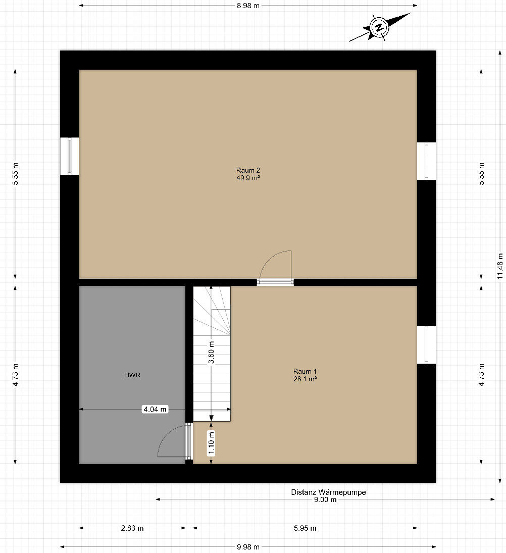

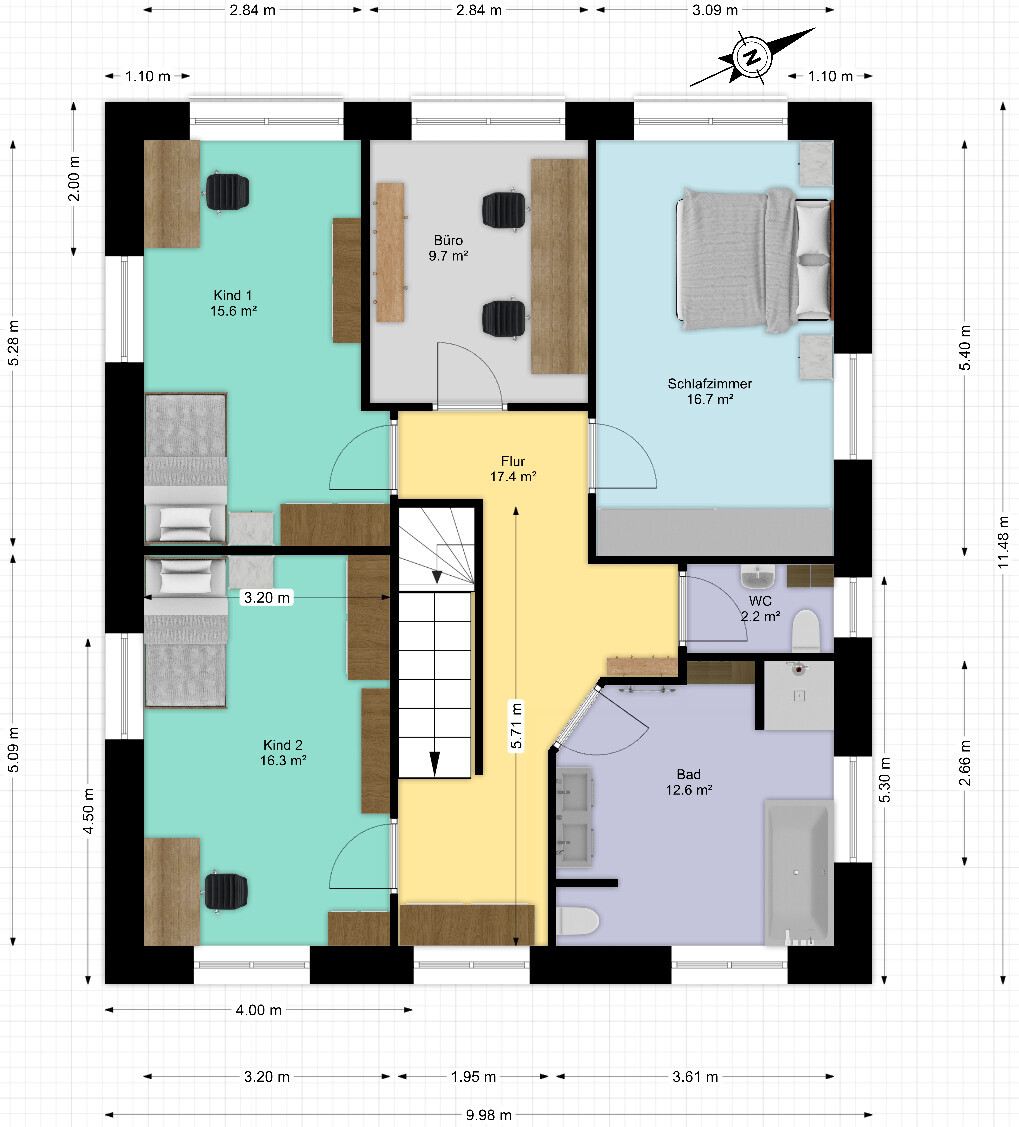

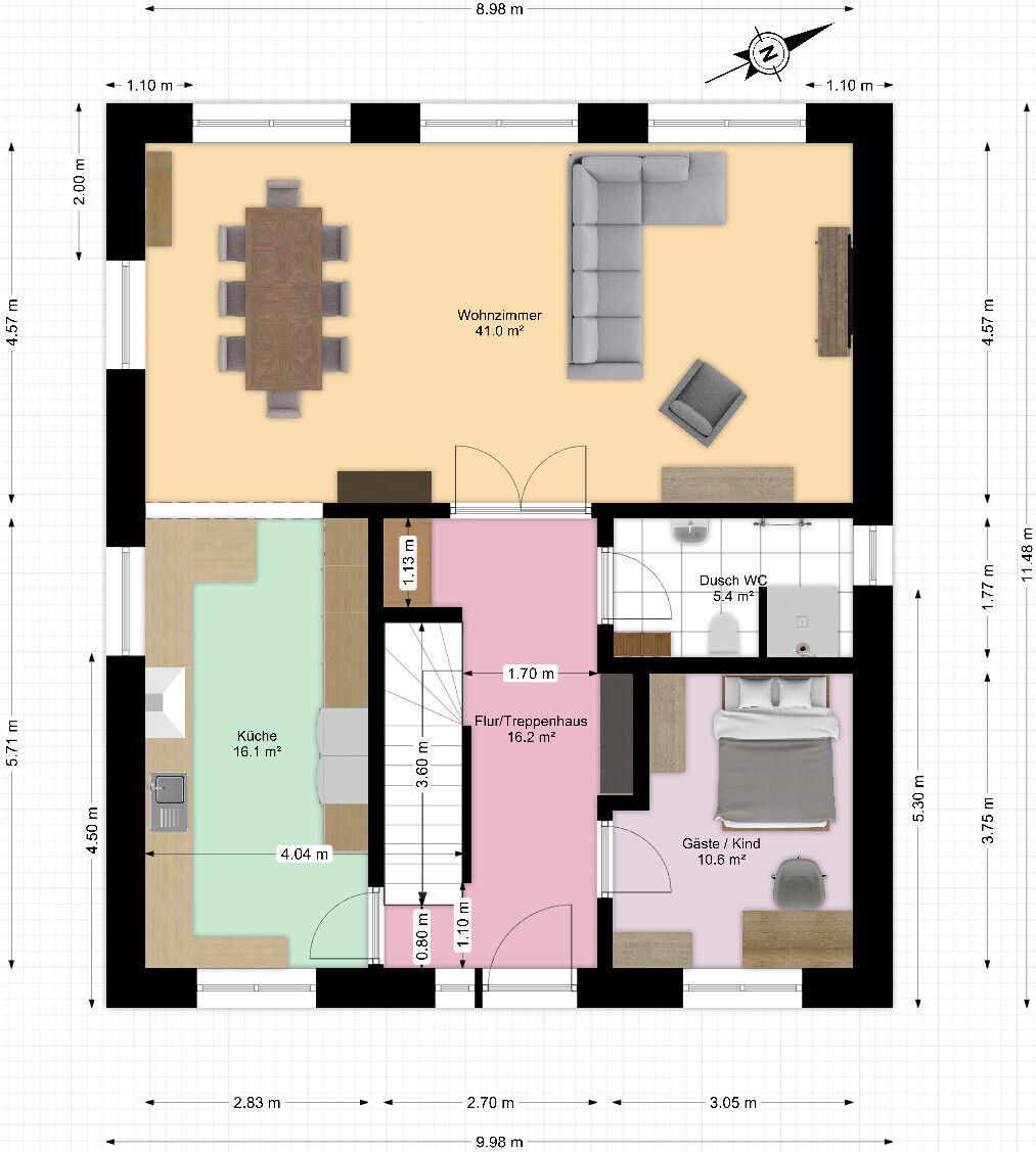

Thank you all for your feedback and suggestions!
We reviewed them very carefully and took the opportunity to look for an alternative solution for the staircase.
@saralina87 You are absolutely right about the kitchen. Currently, we have 1.60 m (5 feet 3 inches) between the cabinets in our apartment, and I find that a good width. However, I couldn’t find a way to squeeze another room or storage area between the kitchen and the stairs, and moving the stairs further to the left would have unpleasant consequences upstairs. Therefore, the kitchen will now be wider, which will also make the rooms upstairs larger.
@Curly The 1 m (3 feet 3 inches) cabinet width was a bit exaggerated. The stair landing was only 80 cm (31 inches) at the top, and 110 cm (3 feet 7 inches) was planned for the basement – anyway, I think it is better solved now!
Widening the house would be expensive because the basement excavation couldn’t be done without shoring (neighbor’s garage on the border), and we would like to keep the driveway width of about 4 m (13 feet) and the distance to the neighbor that we have with the 10 m (33 feet) wide house.
@Pinky0301 Yes, we have also thought about the number of rooms… but if child #3 still happens, the living situation wouldn’t be what we envisioned anymore (then we would simply move the guest room to the basement).
Thank you all again, and maybe someone has additional comments on the new floor plan sketches!
