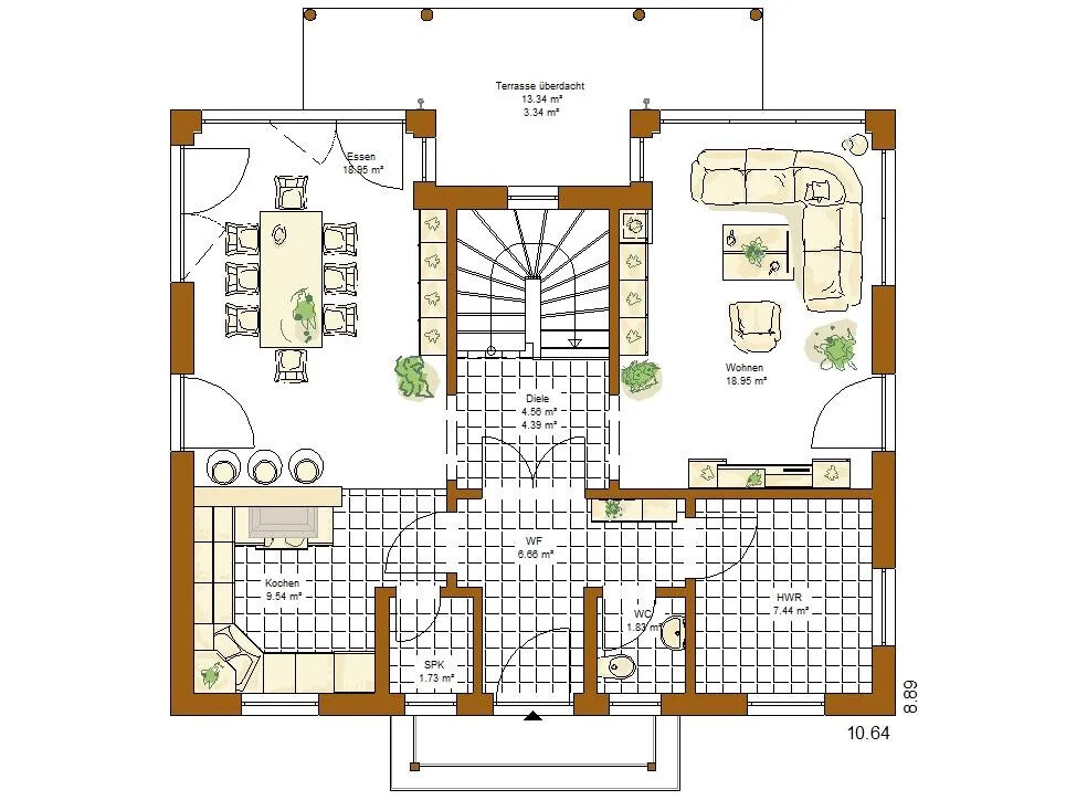

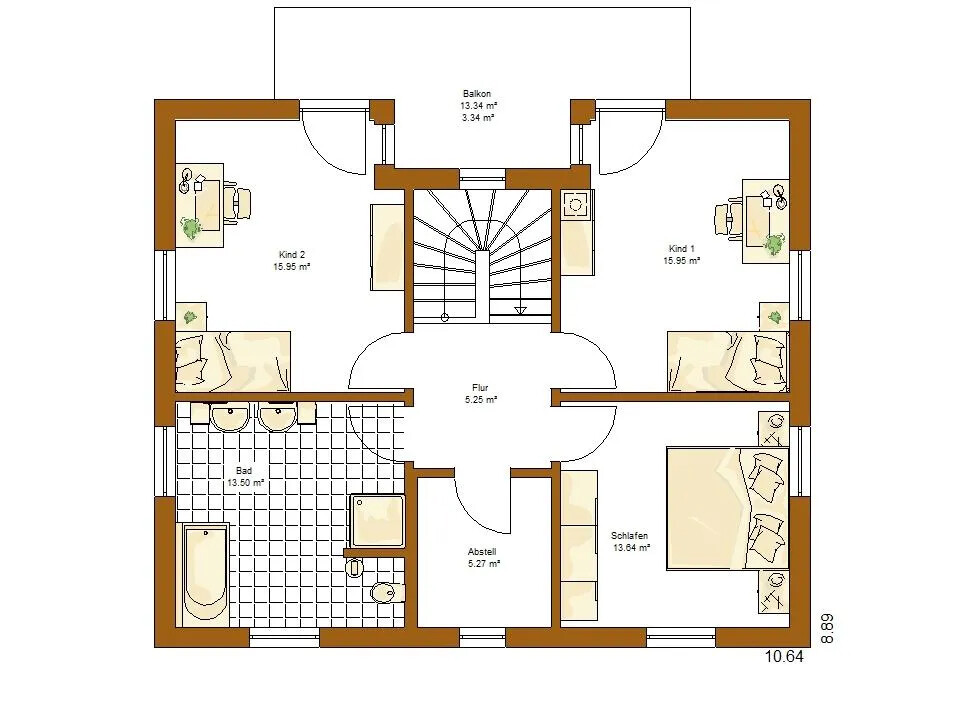

What could also be considered here is the Florenz by Rentsch (I am only referring to the layout).
With a few minor adjustments (for example, removing the pantry, combining the children’s rooms upstairs on the left as per the plan and making them slightly narrower, possibly removing the recessed bay window, and moving the terrace to the left on the plan), this is certainly an option if you are a bit more adventurous.

[ATTACH alt="grundrissplanung-stadtvilla-145-622288-1.jpg"]78859[/ATTACH]
[ATTACH alt="grundrissplanung-stadtvilla-145-622288-2.jpg"]78860[/ATTACH] Hmm, but with that we would have the staircase located in the nice rear south/west area … which I think would be a shame for the study on the north side.
